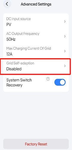

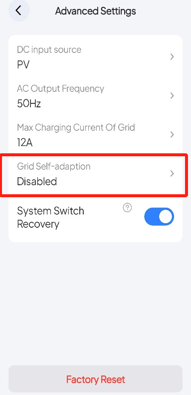

The Elite 100 V2 instruction manual mentions a “Grid Self-Adaption Mode” setting, but it doesn’t appear in the app settings. The firmware is updated to the latest version available. My problem is that when I connect the Elite 100 V2 to my off-road vehicle’s inverter, the “Grid” light comes on, but the input power remains at zero and it doesn’t charge.
The “Grid Self-Adaption Mode” can be found in the “Advanced Settings” of the app. Please enable this mode and check if you still see zero input power when connecting the Elite 100 V2 to your off-road vehicle’s inverter.If you continue to experience issues, please let us know so we can assist you further.
