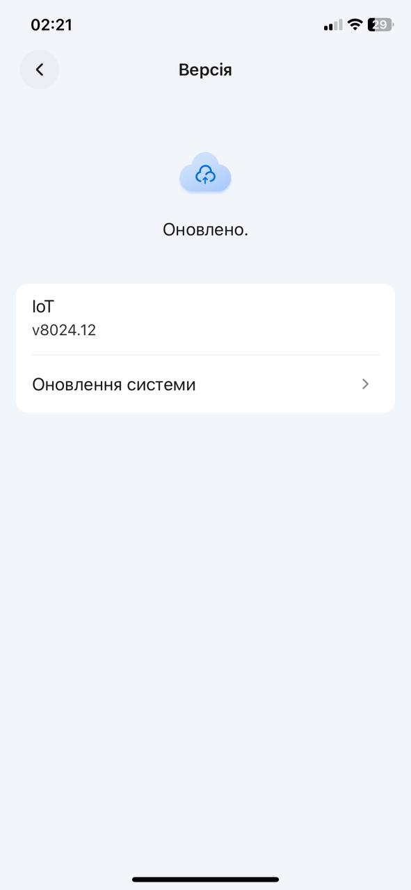

. My Premium 100v2 charging station is always kept in a heated room at a temperature of approximately 23 degrees Celsius, and it has always worked properly. However, after updating the firmware, I noticed the following issues. The station automatically turns off if there are no devices consuming electricity, even if Eco mode is disabled. After automatic or manual shutdown, the station does not turn on, regardless of whether the battery is fully charged or at 99% or lower. It does not turn on using the power button or via the high-voltage charging port. The only thing that helps turn it on is a change in temperature, for example, when I take it out onto a cold balcony for about 10 minutes and return the station to a normal environment (approximately 23 degrees Celsius). I also noticed that when turning on AC mode, three relay clicks are audible; before the firmware update, there was only one click. Additionally, when I force the station to turn off using the power button, the relay doesn’t click, even though it did before the firmware update. I suspect this is related to the new firmware, as everything worked fine before the update. Please update the firmware for my charging station so it works properly again.

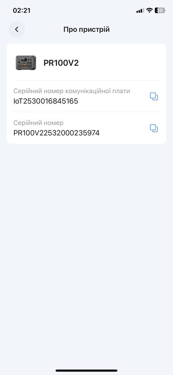

Communication board serial number: IoT2530016845165
Serial number: PR100V22532000235974

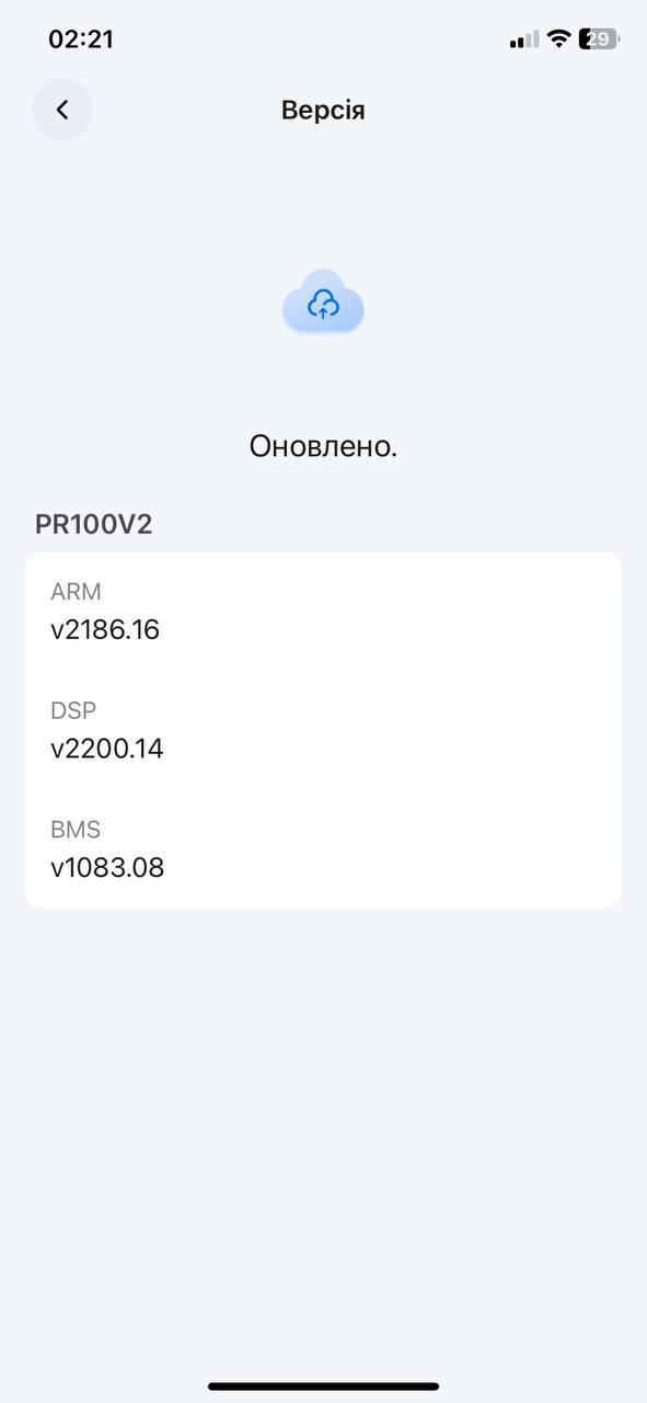

IoT v8024.12
ARM v2186.16
DSP v2200.14
BMS v1083.08

I received the firmware update BMS v1083.09. Should I update to this version or wait? I saw that firmware BMS v1083.10 is already available on the forum, and people have solved a similar problem using this firmware. I also saw on the forum that this firmware fixed the issue. I also saw that the DSP v220016 firmware update solves the issue with incorrect power consumption readings. Could you allow me to update to this version?
Me and the other guy do have v1083.10, but it didn’t solve anything related to your symptoms. Because we haven’t encountered these issues in the first place (at least not yet).
Your unit is from a batch with a manufacturing defect (temperature sensor, BMS itself, or both), and the only way to solve this is BMS replacement via warranty service, sadly.
