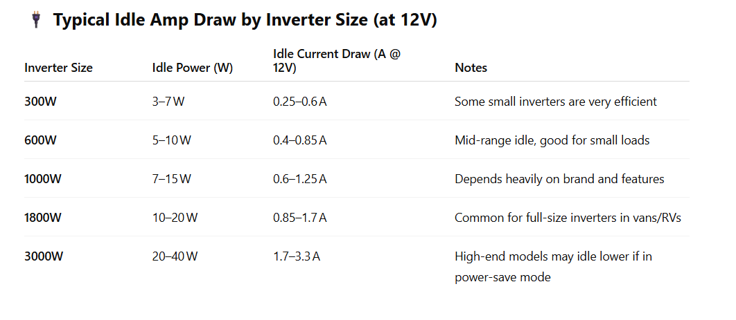

So you have two things. The inverter conversion efficiency (or better yet conversion loss) which is what % of battery is lost converting DC to AC. The battery is natively DC, its using the inverter to convert the 12V battery from DC to AC. This process alone is not 100% efficient. This is listed in the manual generally and its 85% +/ a few percentage points for the AC50. Next you have the idle draw of the inverter itself. This is essentially what the AC inverter itself uses just to keep itself on. Think of it like the fan connected to the circuit board. It draws its own power to cool the unit down, and pulls from the battery. The inverter is no different. It needs a power source. The larger the inverter, the more idle consumption. A lower wattage inverter may only consume 0.5A@12V, but a large inverter (say 3000W one) may consume 2A@12V.
Let’s assume the idle consumption of the inverter itself on the AC50 is 10W That would be 0.83A@12V.
Using ChatGPT (take accuracy with a grain of salt) but the inverter size is 700W which corresponds to the typical range of that inverter. A 30W constant load would mean the battery needs to supply a minimum of 30/0.85 or 35W to convert from DC to AC power. Now throw in the 10W which is required to run the inverter. So that’s 35+10 or 45W.
30/45W= 66% total efficiency at 30W constant load.
