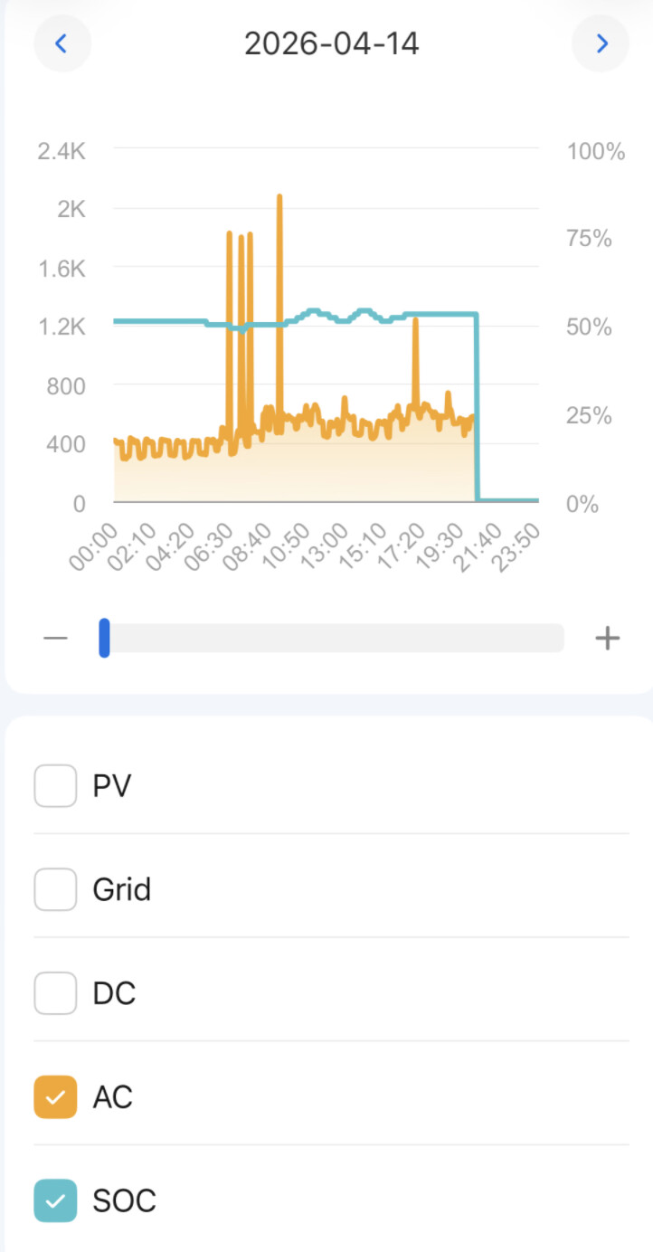

Here’s a graph from my Apex 300 system (iOS Bluetti app v 3.0.8):
Notice the bug? The SOC shows as dropping from about 50% suddenly to 0%. This isn’t real data, but the app seems to want to insert zeros for data from the future. This happens with all of the measured data (PV, Grid, DC, AC, SOC)
Expected behavior: for times in the future which have not yet happened, the graph should not display zeros.
Actual behavior: future data is graphed as zeros across all channels.
