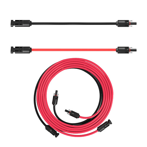

Hi all, I want to drill a hole in my home wall to feed solar panel cable from my battery inside to panels outside but the cable heads / connections are way to big for that; does anyone know if I take apart the connectors if they’re hard to get back together or if there’s alternative cables that will work (anyway the standard ones are forever out of stock so any alternative would be great)?

Solar MC4 cable connectors are single time crimped. You can thread suitable cable through the hole and then crimp on connectors if you have access to the right tools or an electrician friend. Do not try and solder them!
Watch very carefully where you get cables from, most of the cheaper solar cables sold on well known online stores are not genuine MC4 connectors, often use CCA not copper wire, are insulated to 36v standard only and are very badly crimped so can start fires. If you cut the end off the Bluetti cable and then stuck it through and fitted a new MC4 that ought to work.
You should be using double insulated copper cable from a reputable source. If you do that, use real MC4 plugs and have the correct crimping tools you’ll be fine although you might need a few tries to get the hang of it (it’s not that different to crimping battery terminals).
The other popular alternative is to use so called “super flat” cables through a window opening. These are insulated wide thin copper strips with MC4 each end that are thin enough you can stick them through a typical window and then shut the window fine on it.
Bluetti AFAIK don’t themselves sell flat cables but a certain rival beginning with E does sell good quality ones, and they work fine with Bluetti kit as the MC4 connectors are a standard.

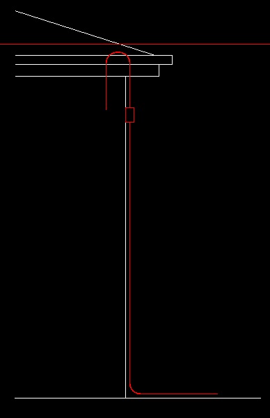

There is an easier way to get cables into a house and being under an eave, less likely to have water ingress. :slight_smile:
Use split conduit on the cable, that way no plugs need cutting, up the wall into a IP rated junction box for MC4 connections, up and over the wall through the eave and into the room through the ceiling. Fix the cable with saddle brackets to suit.
The junction box can be where you are able to reach it, or high enough to need a ladder to stop little fingers playing with it…
In the junction box, you can cut the plugs off and join with a terminal strip, which enables sealed conduit use.
