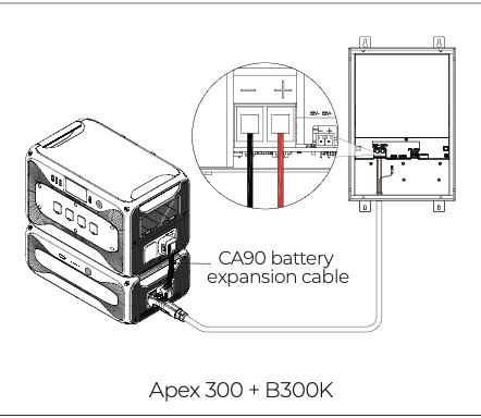

I am not using any of the DC inputs
Each solarx4k is connected to one Apex300 / B300K bundle through the battery extension plug of the add on battery as per the image below
From my understanding, the solarX4k is regulating that voltage accordingly
The error I got is Overvoltage on my solarX4k

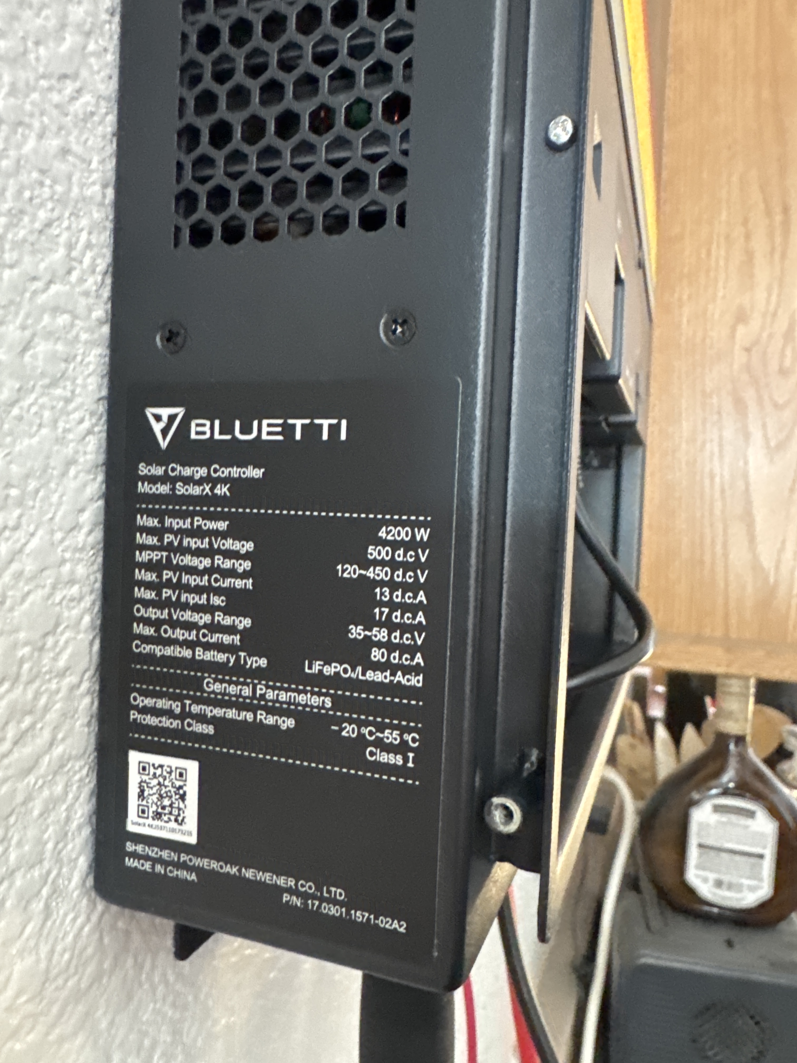

I had a power overload with Solarx 4k as well. It seems as the temperature dropped in my neck of the woods. The voltage went up and I had to take a couple of panels off-line to get it to start working again and not throw errors and overload. It’s very touchy about his voltage range it says it’s rated up to 500 V but I actually think it’s only rated to about 450V. Notice how it says voltage range is 120 to 450V.
