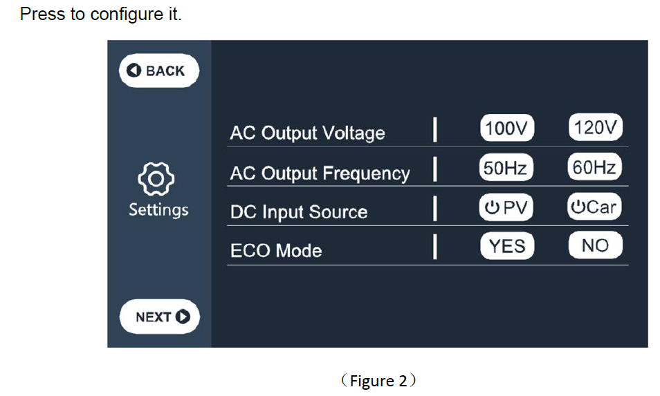

- The AC200P does not have app capability. It does have a manual and the touch screen has a settings menu.
- Are you using the Charger 1 in a vehicle, using the vehicle battery? If so, have you set the AC200P to car charger (vs PV)?

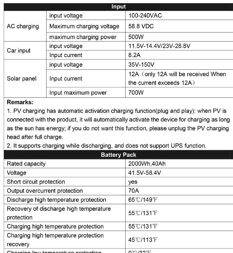

- The AC200P solar input requires a minimum of 35V.

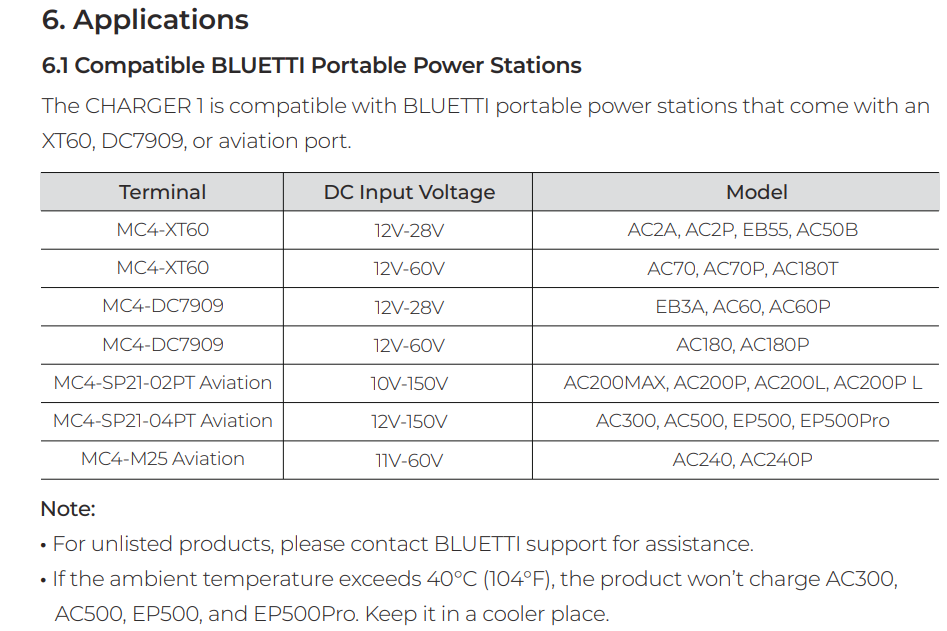

While I bought the Bluetti Charger 1 a few months ago, I confess, I have not yet tried it out. My use case is to use it with 12V 100Ah batteries I have as a backup way to charge my power stations. I have been too busy playing with (I mean, testing) other new solar/power gear, but I seem to recall from watching the Hobotech review of it that you can adjust the settings to fit your non-Bluetti power stations as well. My guess is with the AC200P, you need to set it to charge via PV and set the Charger 1 to a minimum 35V in order to charge at a higher rate, or set the AC200P to car instead of PV through the screen menu and make sure the Charger 1 is set to the typical car charging range of 120W.

@SoulGen’s suggestion is correct. Yes, please set the voltage to at least 35V and then try again.

Thank you both, I did get an answer elsewhere and changed my settings to PC and 35v and it is now working. I had it set to car charging because I thought PC was only for solar panel charging
