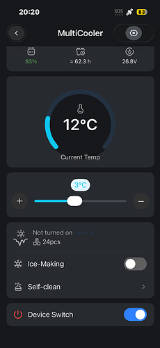

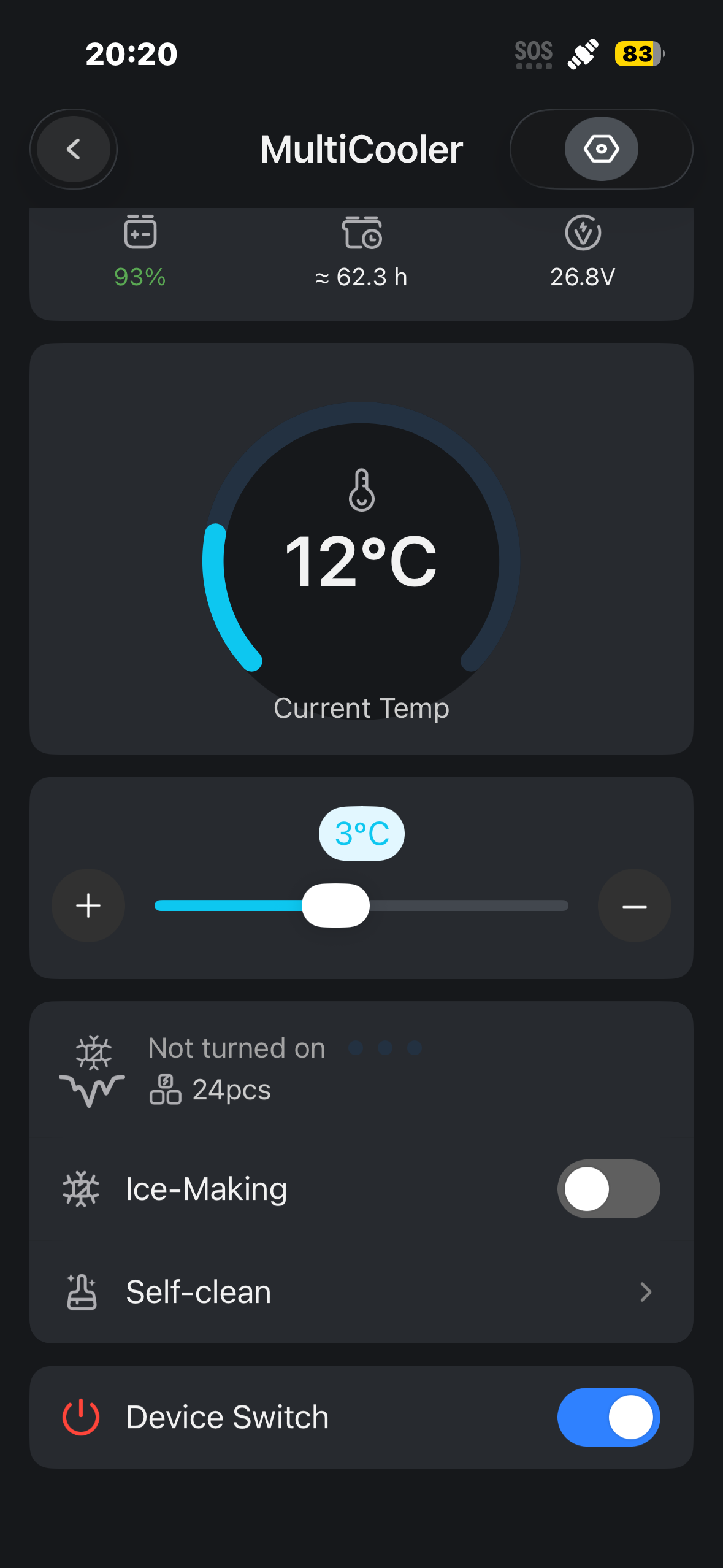

Multicooler (with internal battery) stopped cooling after charging to 96%.
It is a permanent fixture in our remote cabin in the woods and is charged from an AC200Max connected to solar panels.
To get it cooling again, I don’t know if it was the big reset I did (pulled battery out for 15mins)
or giving it a shake
or powering it on its 24vdc power brick with out the internal battery from the AC200MAX that got it cooling again
Just concerned that its going to be a continuing issue and we won’t be able to rely on it for our food preservation etc.

Update on further testing for those interested.@BLUETTI_CARE

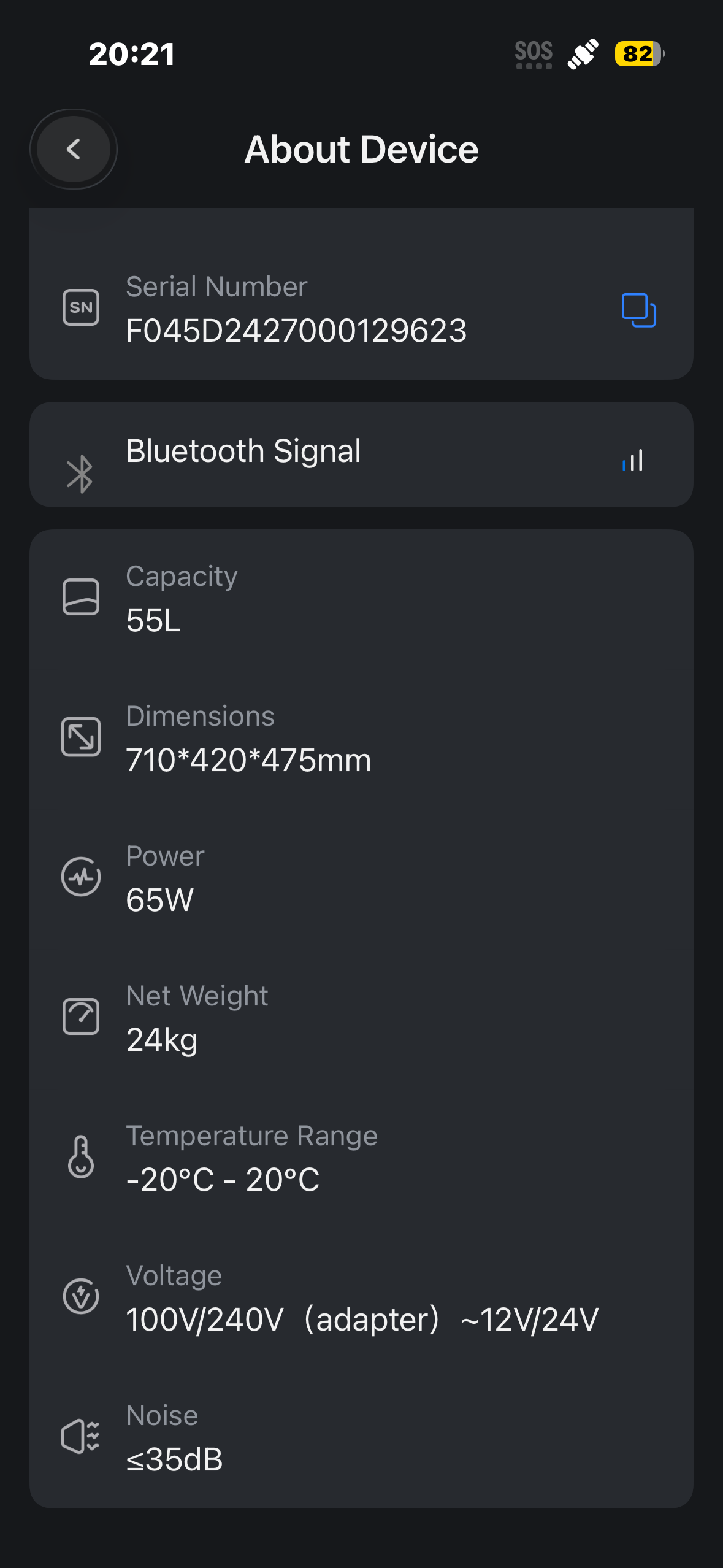

Issue with ‘Stopped Cooling’ occurs when powered by the 24VDC charging power supply supplied with the Multicooler.
So the fix for now was to just use the 12VDC cigarette lighter to Multocooler cable from the AC200Max.
This was faultless.
