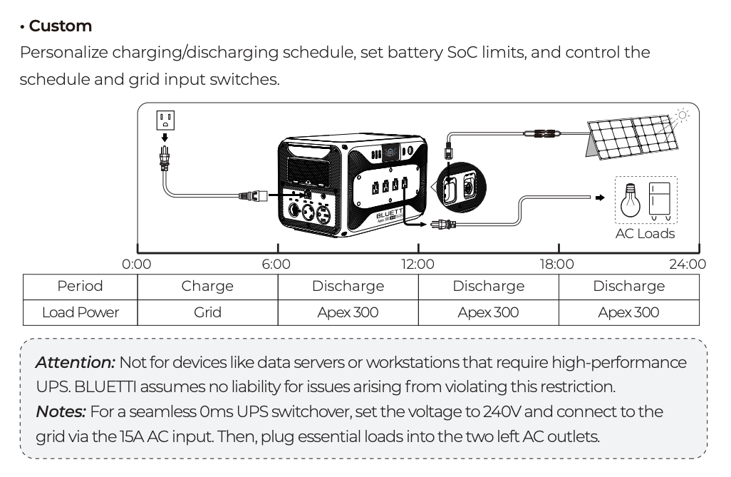

  1. How “Working Mode” works? I try to use “Custom”, enable “Charging”, enable TOU and configure my Time Setting for Peak between 15:00 ~ 23:00 and Off-Peak between 00:00 ~ 15:00 (again this setting is awkward, please refer to 1.1 above). But I can’t seem to understand its logic correctly. This is what says about custom working mode from manual:
    I am not sure whether it’s me or the document doesn’t seem to explain anything to the user at all. I have so much questions about this mode. For example:
    2.1. How do I configure charge/discharge time?
    2.2. Why there are four different zones between 00:00 ~ 24:00? Is this configurable or it is fixed?

  1. In the previous scrceenshot of manual, why in custom mode there are four period from 0:00 ~ 06:00, 06:00 ~ 12:00. 12:00 ~ 18:00, and 18:00 ~ 24:00? How can I change it? and for each of these separate period how can I assign various different routines (i.e. charge/discharge/AC/DC… etc)

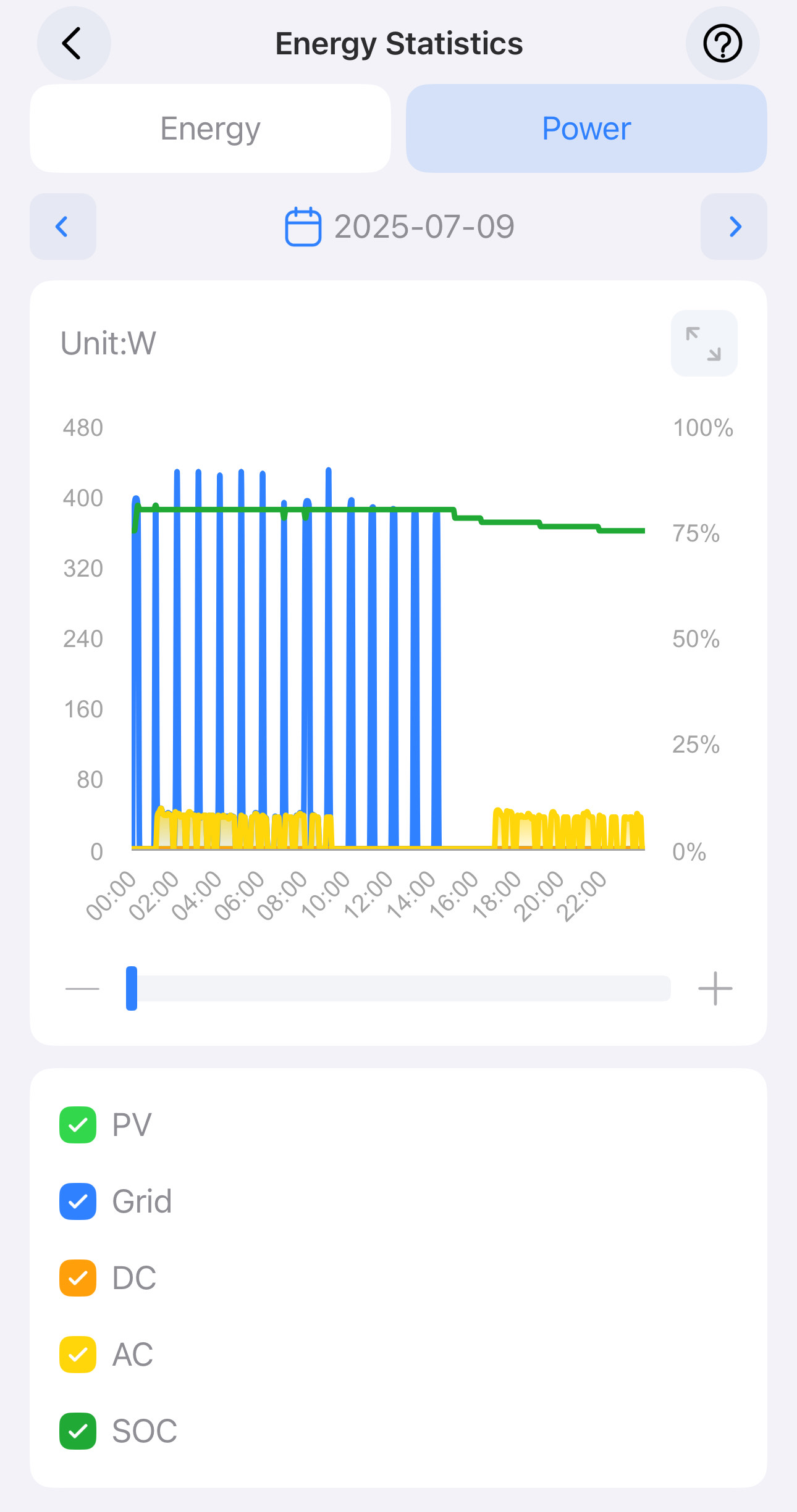

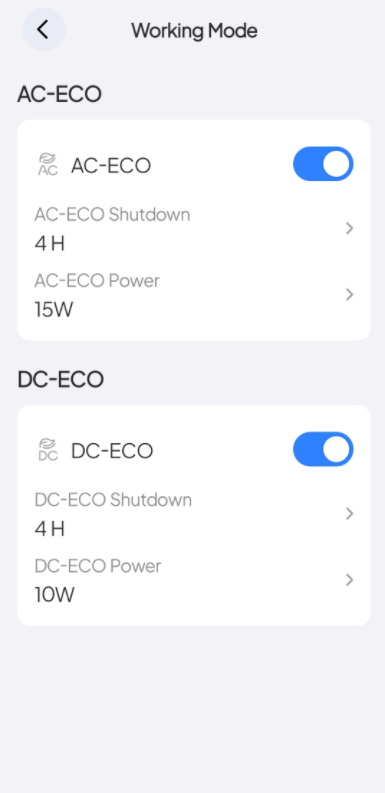

  2. How EXACTLY does the “ECO Mode” work? Do the power need to be under the threshold for the entire time, or only happen even once, for the AC shutdown to happen? For example if my AC output is 40 W, and every 5 minutes there will be a short moment (i.e. 5 second) that the AC output becomes low, and immediately get back to 40 W, will ECHO mode still be triggered? I need better explanation here because I suspect the accidental AC shutdown is caused by this feature. I am also attaching an image for your reference:

1. The four time periods of the custom mode mentioned in the manual are just examples. Customers can set the time by themselves in the APP. They can set the charging time (off-peak) to the period when electricity fees are low and the discharging time (peak) to the period when electricity fees are high.
2. The ECO mode is designed to save electricity. The original intention of this setting is to prevent the power station from continuous discharging when not necessary. The specific power and time can be set in the APP. For example, setting AC-ECO for 4 hours means that if the power station is not used or the power is below 15W for more than 4 hours, the AC output will be automatically turned off. If customers require the load to be online at all times, there is no need to enable this function.
When the power belows the threshold and the duration meets the set conditions, the AC output will be turned off, and this is not a one-time occurrence.
3. Daily power curve: Check the 24-hour daily statistical data of input and output power.
Energy statistics: Check the cumulative input and output energy data by year/month/day.
