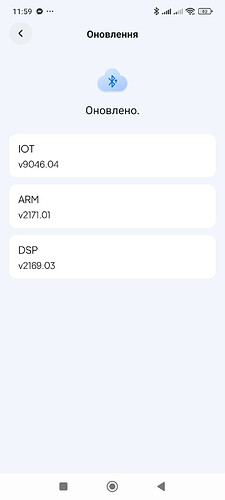

AC50P2544215863851
All of them are from the same supply, with the following firmware:
