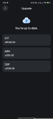

Hello, @BLUETTI
I have same problem with charging when the voltage is 160-180 volts. Error E114.
I would be grateful for your help.
SN: AC702434001988280
IOT v9046.04
ARM v2151.05
DSP v2106.09
