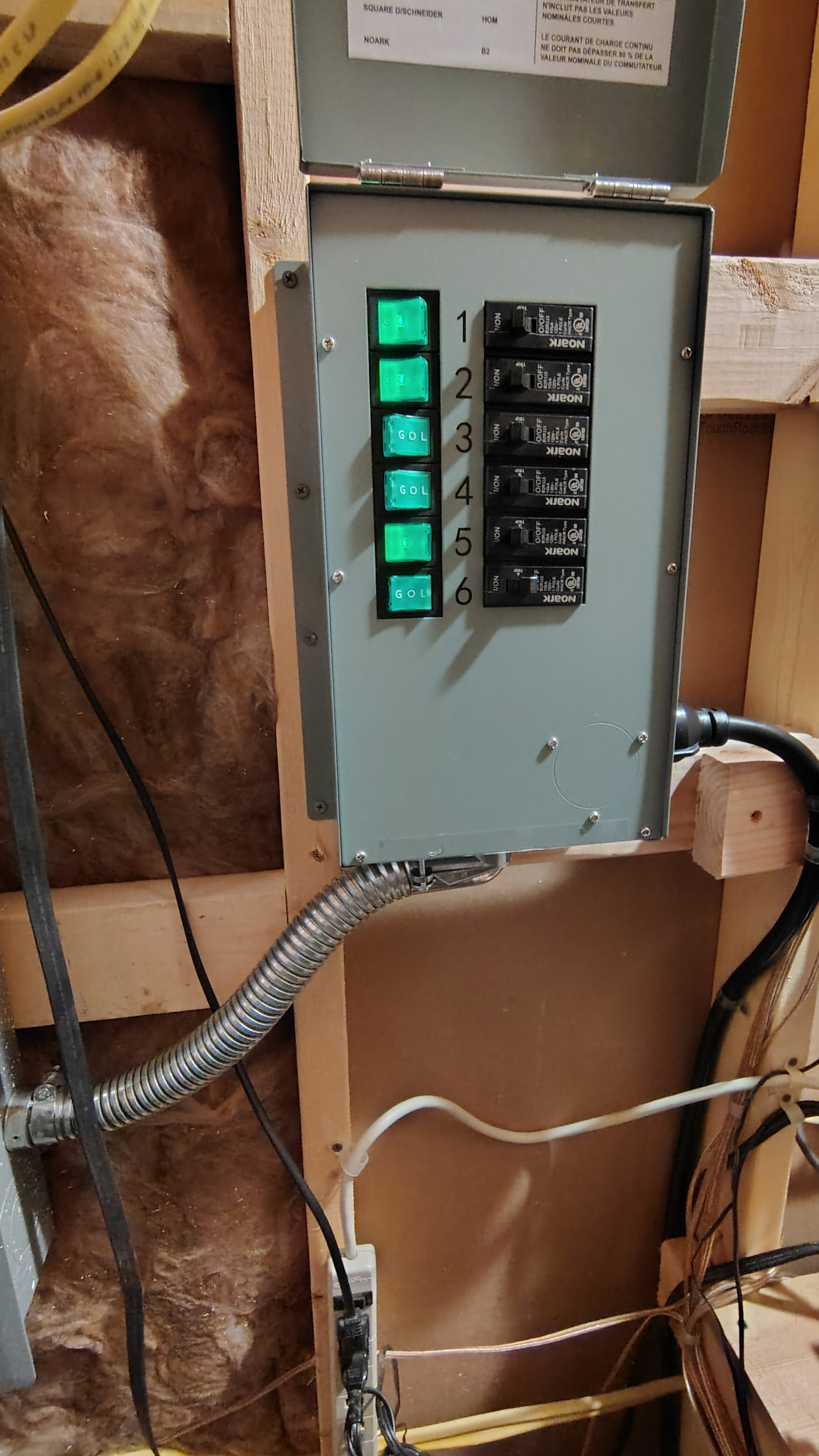

So with the help of a friend I found this device, I didn’t even know they existed, but for connection the circuits I want to keep on full backup this will be ideal.

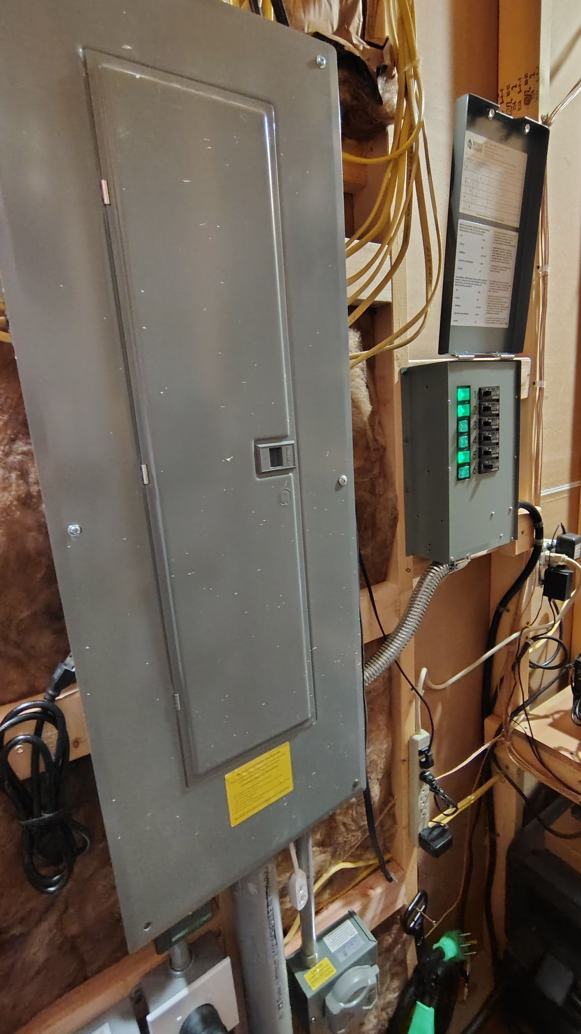

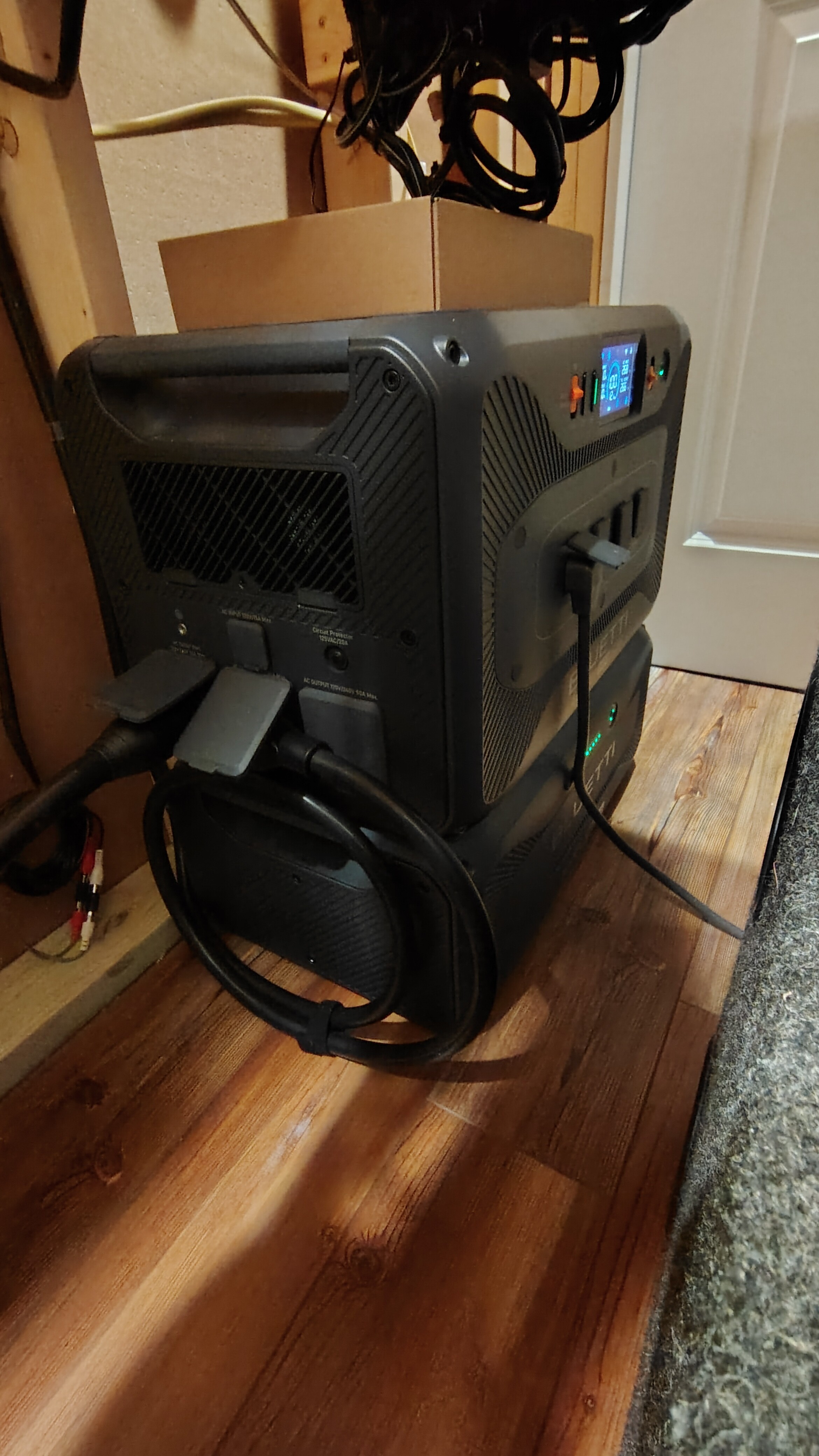

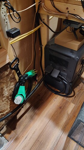

So I got everything installed over the weekend, I have 3 circuits that will be on full time backup, the first circuit will power both my son’s desk who does his schoolwork on a PC, and my wife’s desk that will have her work PC, it will also power some of the lights in our living room. The next circuit will power my office PC and office lights, the third circuit will power our internet modem along with my son’s bedroom light. I also connected our dedicated refrigerator circuit to one of the circuits, and the dedicated circuit that powers our deep freeze in the garage and our garage door openers. I will likely leave these on line power most of the time just to keep the load down on the Apex, but obviously all it takes is the flip of a switch to transfer them to backup power. I will probably transfer them to backup power if we are gone on a trip so they will keep running during outages if we aren’t home to flip the switch. I also have my network router, network switch, and my file server PC plugged directly into the front of the Apex these devices are located in the same room as the Apex and breaker panels

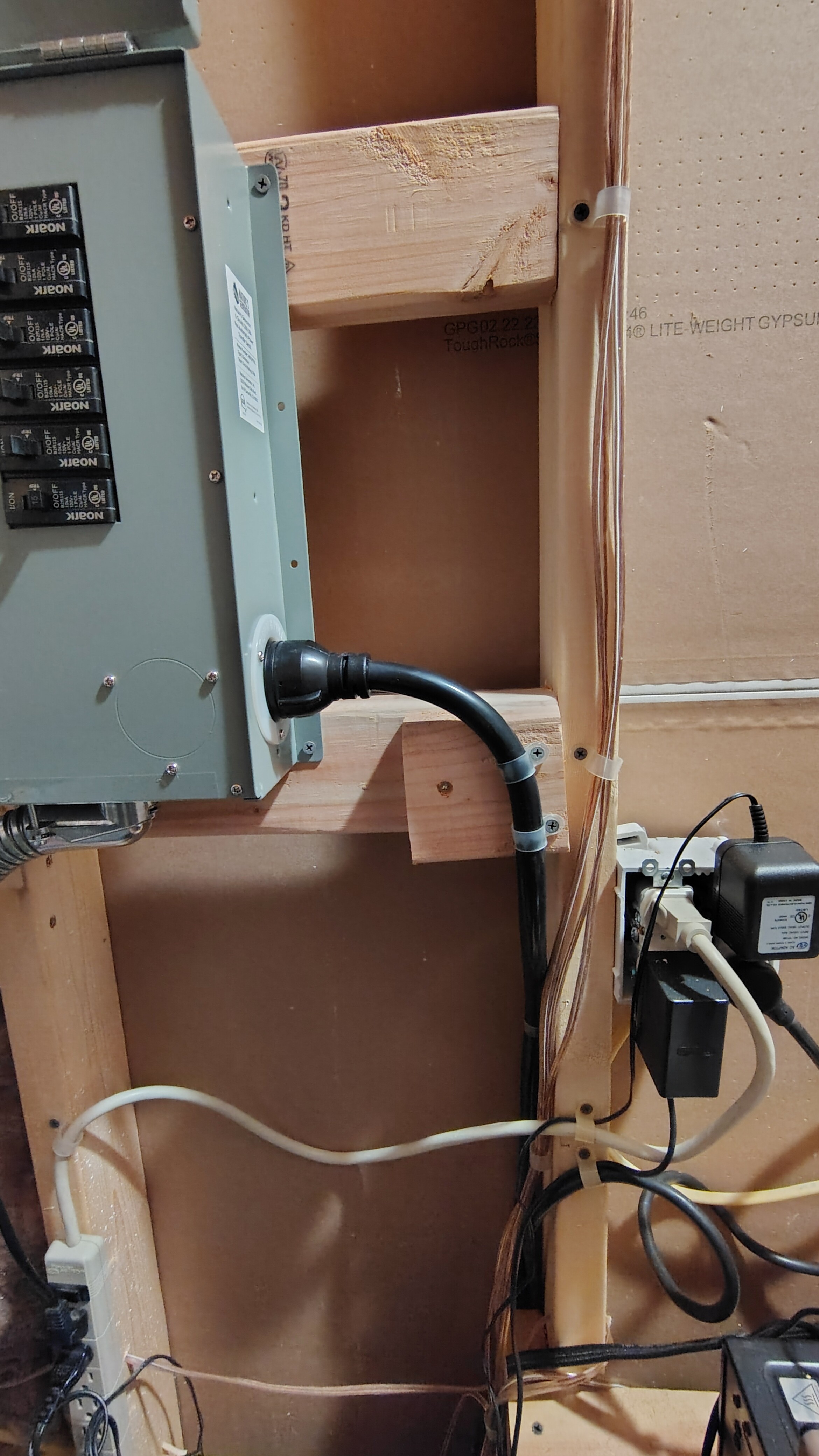

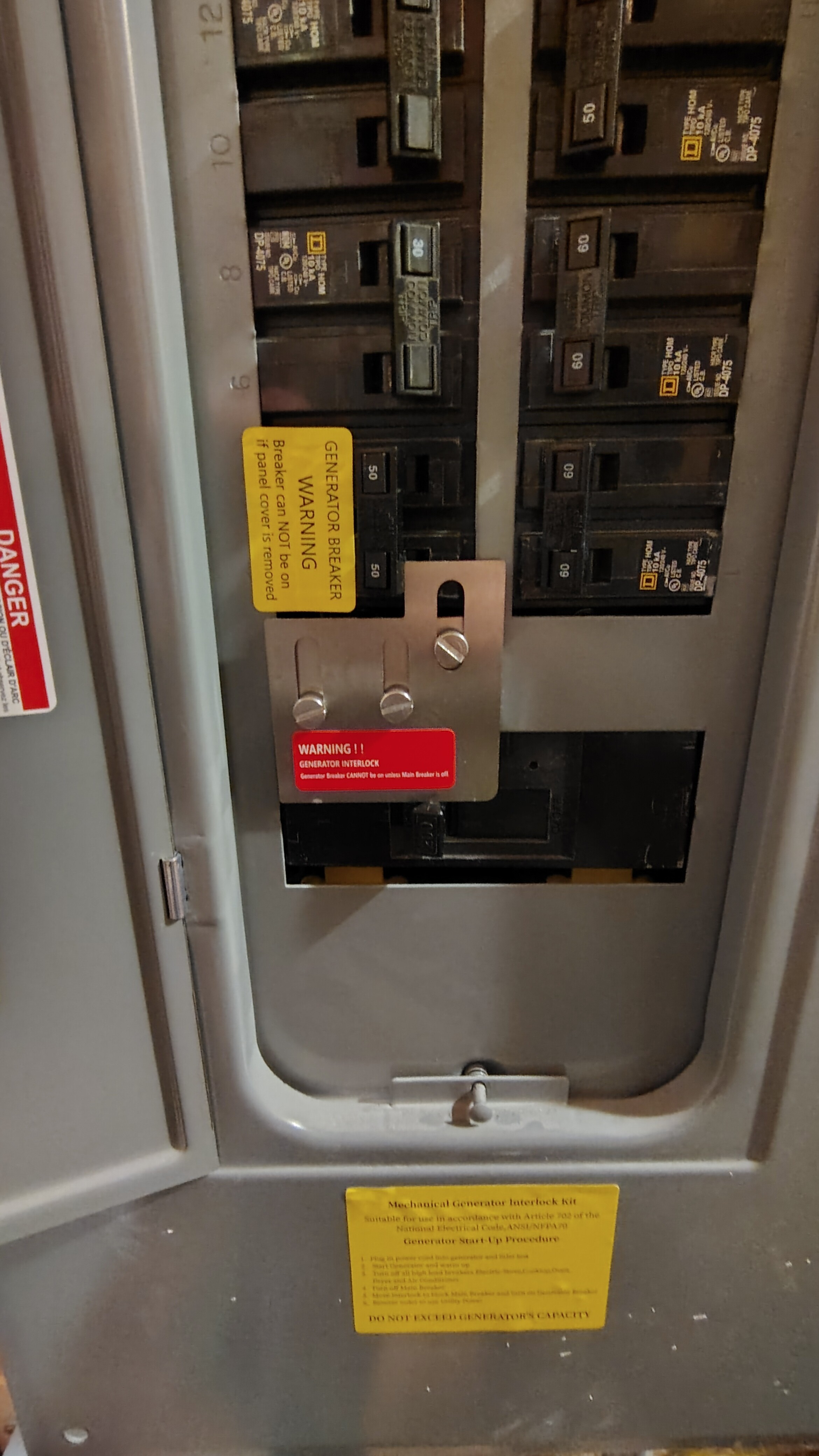

I also installed a 50 amp generator inlet on my breaker box using an interlock plate. This will allow me to power the entire house from the Apex if needed. Obviously I will have to monitor the loads carefully but it will be nice to have the option to do this if needed. I purchased a 6 foot RV power cord for this purpose and it worked wonderfully.

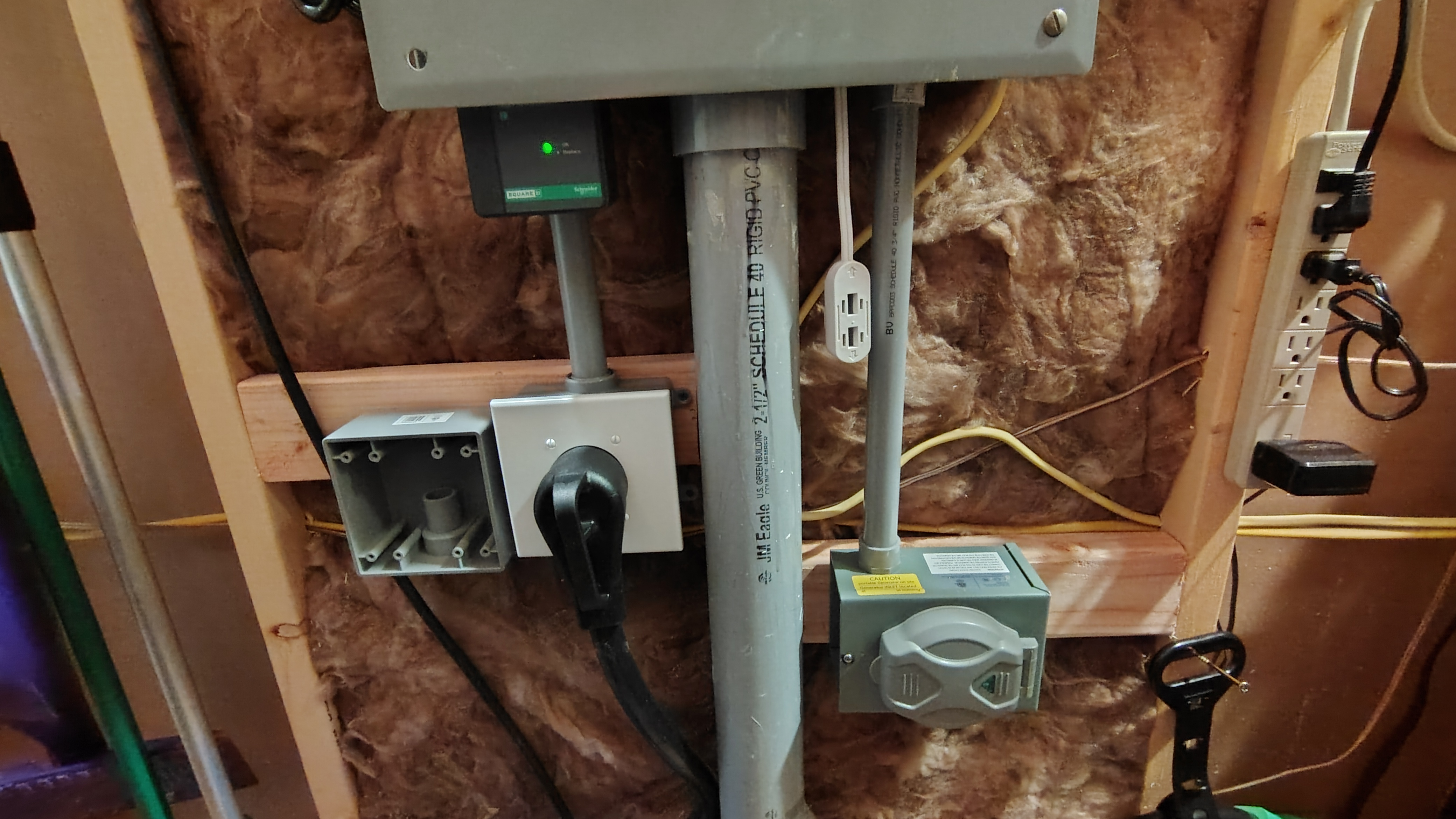

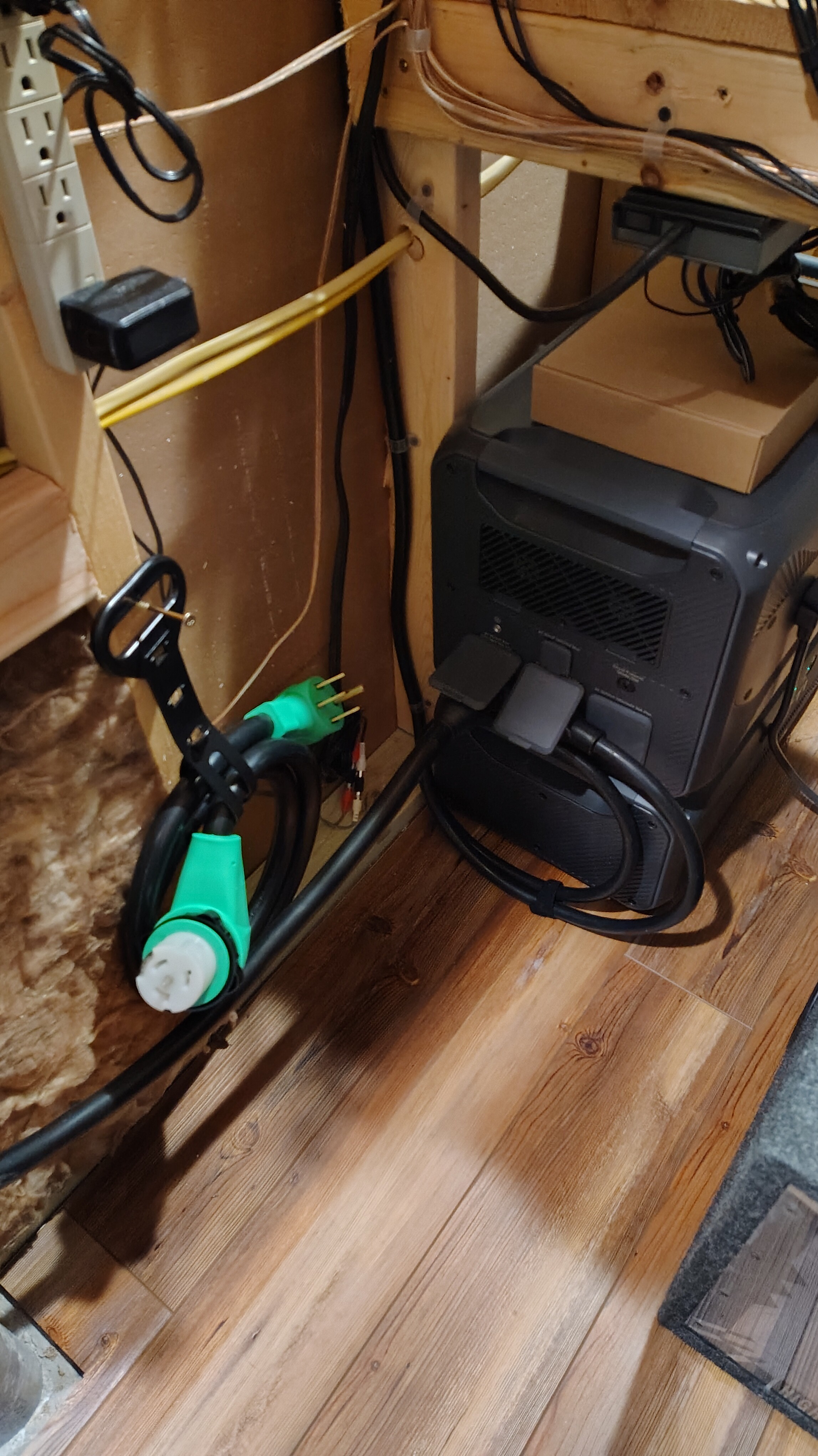

The next thing I did was installed a dedicated 240v/50amp outlet to charge the Apex.
The unused box you see in the pictures will be for another 240v/50 amp outlet that will hook to another generator inlet outside my house that I will use to connect my generator to during any extended outages, with this I can charge the APEX and use pass through power to power the entire house, or connect directly to the breaker box from the generator. I’m going to install a junction box below this outlet to feed solar power over to the Apex as well. Not sure when that will happen but I do want to add some solar panels at some point. I already have conduit running into this room to outside the house where my generator inlet will be located.

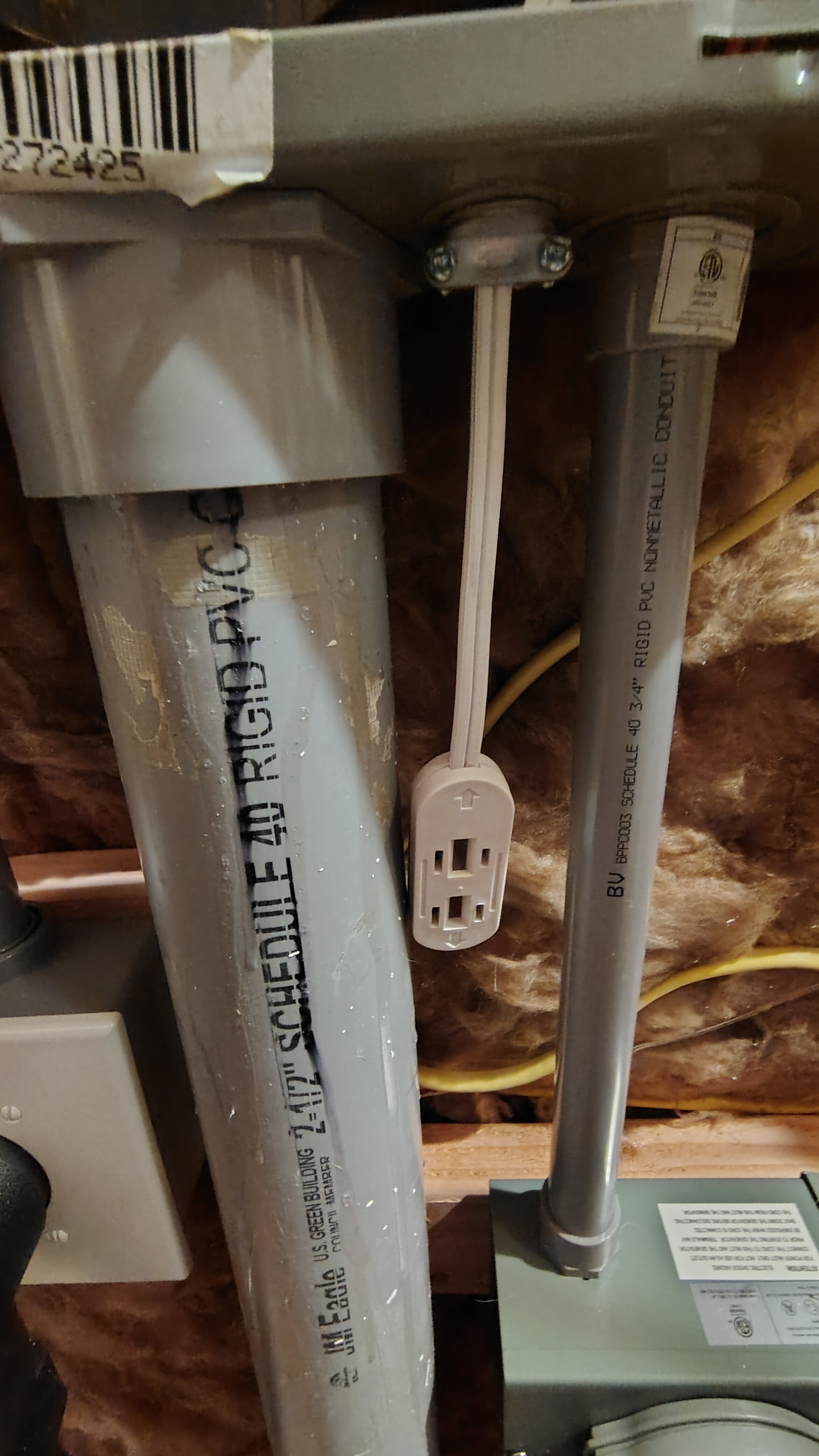

You might have noticed the small extension cord hanging out of the breaker box, this is connected to line power before my main breaker and protected by a 2 amp in-line fuse. This will allow me to plug in a very low power device such as a light or radio that will alert me when grid power has been restored.

Here is the transfer panel.
Here is the inlet to power my entire breaker panel and the power outlet that keeps the AC300 charged. The empty box on the left will have another outlet that will connect to a generator inlet outside the house, still need to pull the wires for that.
Here are the rest of the pictures. No longer moderated!
