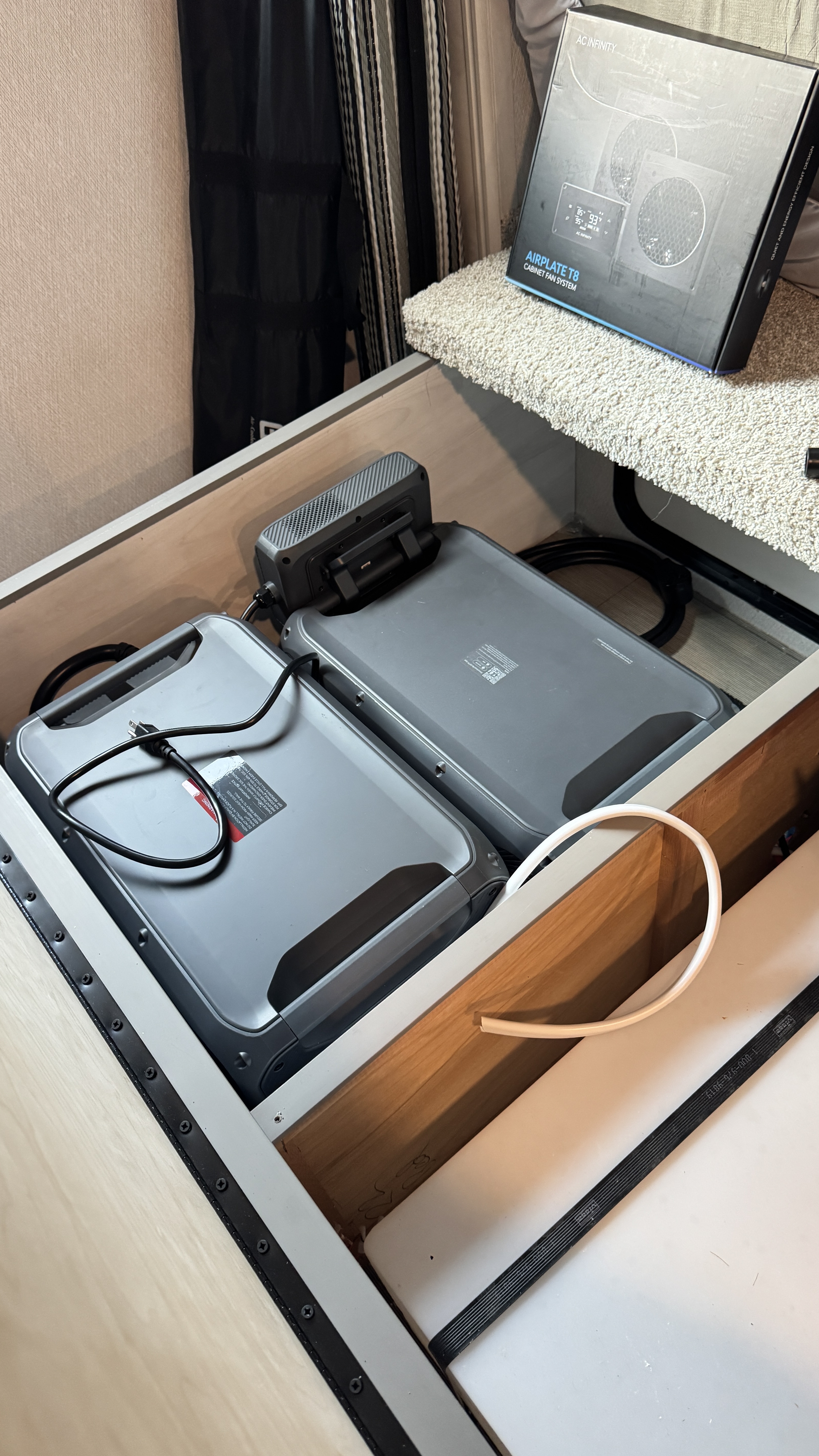

While trying to install a APEX 300 and 2 of the B300K batteries into our Class C RV build…we are realizing we can’t position the batteries “Stacked” obviously in our compartment…so the Short cables “with better low profile connectors” won’t work…
After buying what we thought was the cable we needed, from Amazon, because Bluetti does not appear to have anything in stock as far as cables go, we discovered it was a P090A to a P150 cable…and not gonna work…and honestly thankfully so as the cable connector is HALF THE LENGTH of the actual entire system itself?!
Regardless… after researching…what we need is the “P090A Battery Expansion Cable”…which of course is “out of stock”…everywhere…
Starting to get very frustrating and starting to think the lack of cables and the ridiculously sized plugs may be the downfall of using this system in an RV… Other than the new short cable connectors…which you would hope Bluetti could mack a longer cable with those sort of connectors…ASAP… otherwise they are two short.
Are and When…are these cables coming/available?

I also have the same issue because the battery expansion cable that came with the B500k is very short and only works stacked but I can’t do that in my RV also. What cable would I ask for? A longer P090A to P090a Battery Expansion Cable? I don’t see it anywhere.
Hello, could you please tell me which device you are using the B500K with? Different devices require different cables?
Yea no idea why these aren’t listed anywhere…but I had to contact them to get the cable I needed as well for our RV setup as we couldn’t stack them. Wish they would come out with a longer cable though without the huge connector…and something like the newer flatter connector.
New member here. I know this thread is a few months old, but I thought I’d reply in case anyone is still looking for the cable. I have the Apex 300 and BK300 in my teardrop. I was able to source a P090A on fleabay. I agree that it was a real miss for Bluetti not to make this cable easily available.
Ironically, I am no longer using it. I rearranged my batteries to be side-by-side, with the BK300 facing backward (only mildly inconvenient). The supplied short cable is just flexible enough to make that work, and giving up the storage space under my rear table is worth it; I am determined to have adequate power. :wink: I carry the P090A with me for backup. I love the 300 combo (though I sure wish the Apex had a built in 12V DC output; Bluetti WTF?!).
There are two new P090A cables on fleabay right now if anyone is still looking. And according to Bluetti’s website, they are in fact sold separately and should be available to order next month (April).
