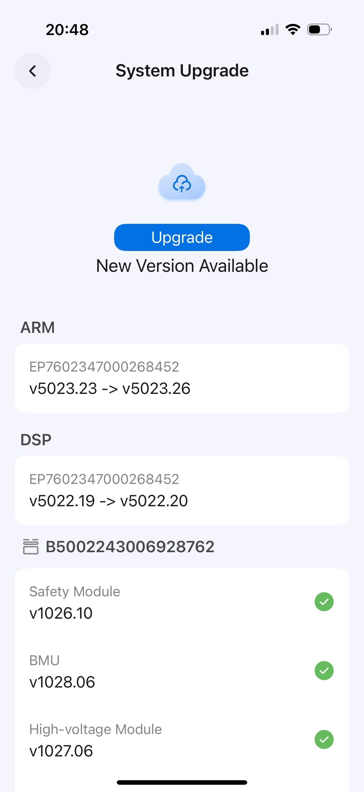

Hello, please try to place the switch on the battery side to ensure a 10ms switching time. Also, please upgrade the APP and firmware to the latest versions.
