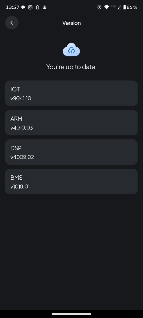

Since the IoT firmware has already been upgraded, could you please check whether there are any other available firmware updates (such as main firmware or BMS firmware) and try updating them first?
If there is no update available, or if the issue still persists after the upgrade, please provide the serial number (SN) of your EP500Pro and all current firmware versions (including DSP, BMS, ARM,and IoT).
Under normal circumstances, an IoT firmware update should not affect the touchscreen or on-screen operations, so we would like to review the full firmware information to investigate further.

I check every day to see if there’s a firmware update available. So far, nothing has changed. No update is offered
Hi @Bohdan_D, we have consulted our technical department regarding this matter, and they informed us that your firmware is already the latest version, so we are unable to push any updates to your device. They recommend that you arrange for a repair and return.
