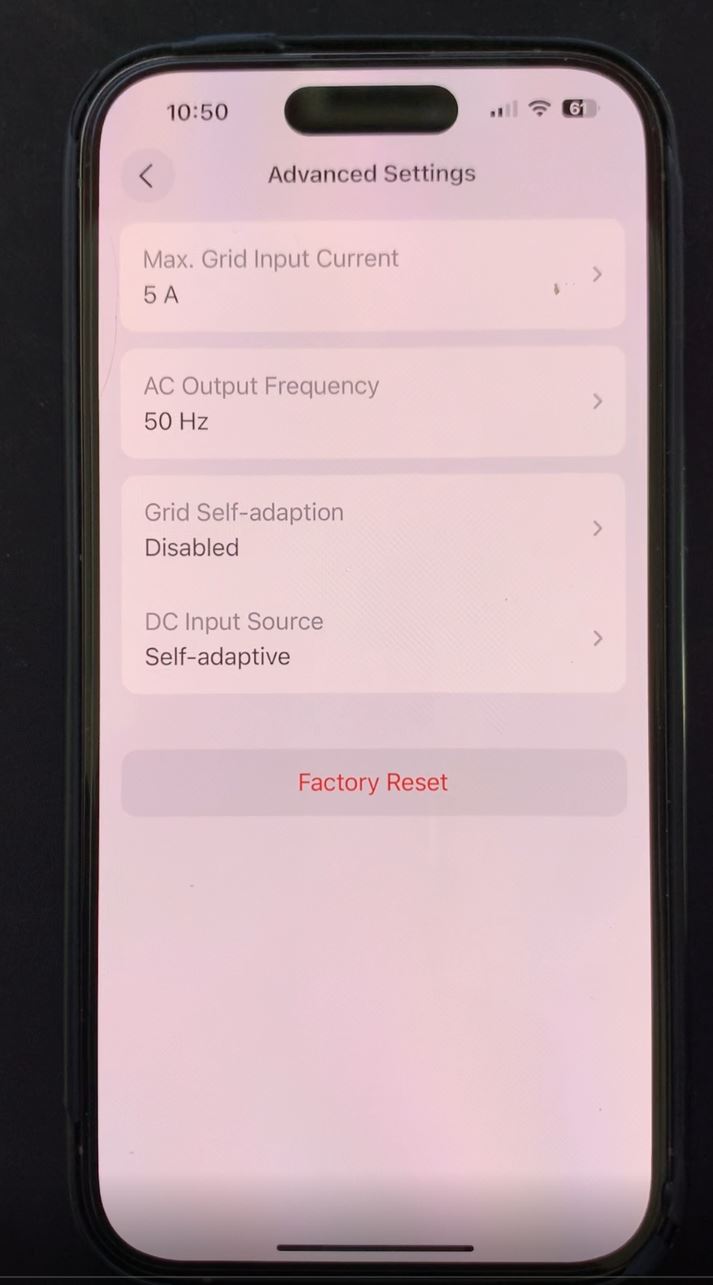

@BLUETTI_CARE Since the latest iPhone App update I have been having an issue whereby the advanced setting “DC Input Source” is stuck in “self-adaptive” mode.

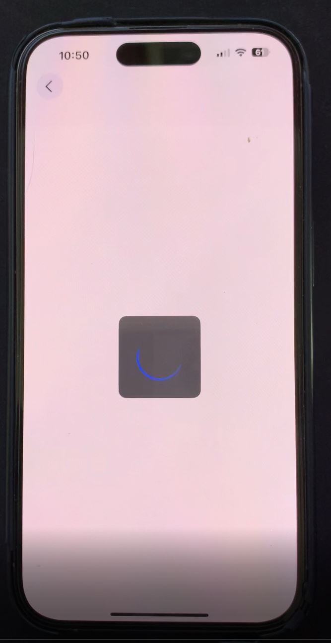

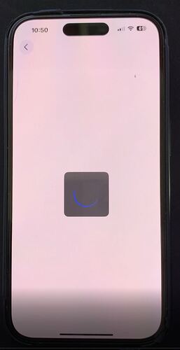

Any attempt to change this setting results in a square box with a blue spinning icon.

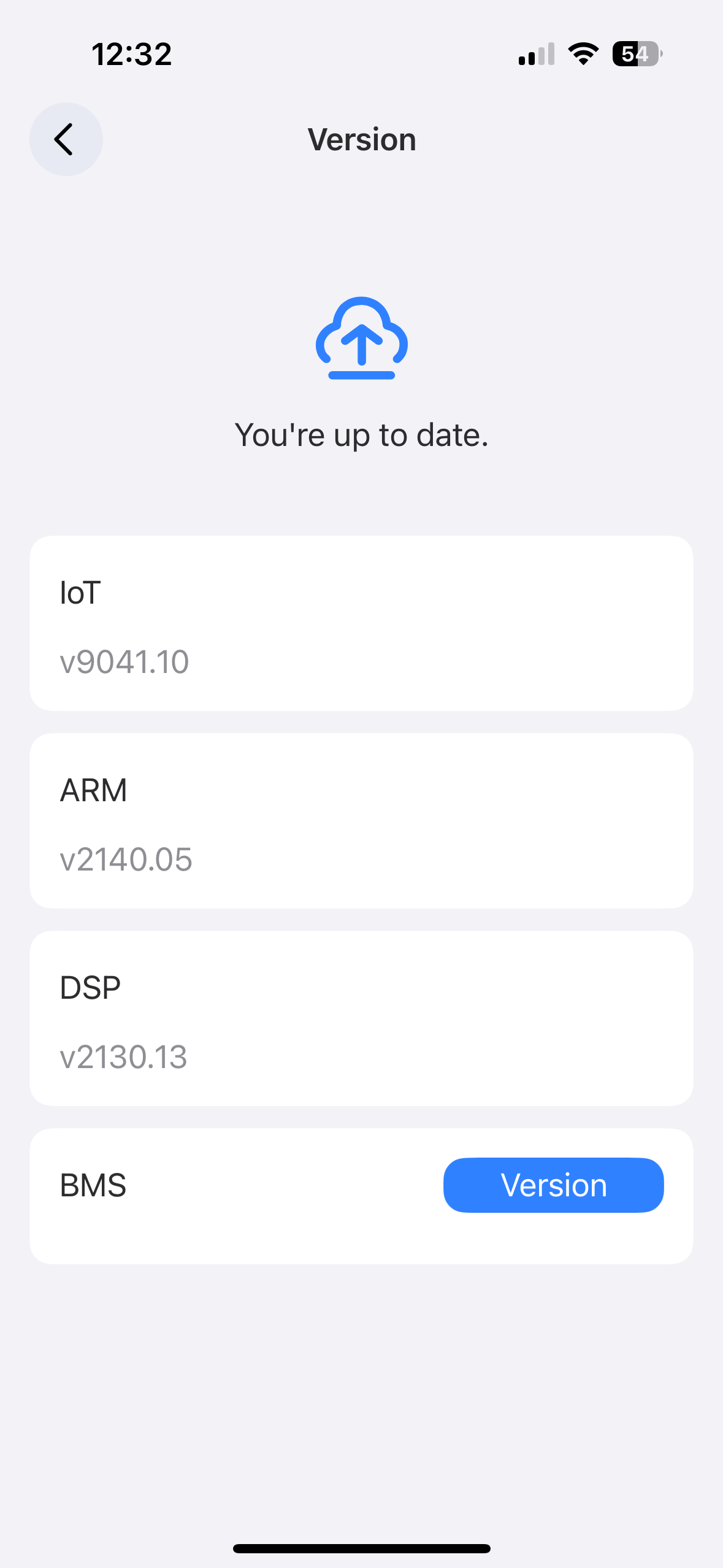

We would like to know the SN code of your AC200PL and its current firmware version. Our hope is to resolve the issue by pushing an updated firmware to your device.
Thanks @BLUETTI_CARE please find information as requested.
Serial Number removed as this is a public forum.

Hi @Teece, Unfortunately, the technical department has informed us that your firmware is already the latest version, so we are unable to push any other firmware to your device.

Hi @BLUETTI_CARE Yes, the problem only occurred after the last App update to v2.3.25.
I do not have access to a cloud drive but here are two images that demonstrates what happens as a the result of pressing the DC Source button.
The spinning icon remains until I press the back button and return to the normal menu options for Advanced Settings
