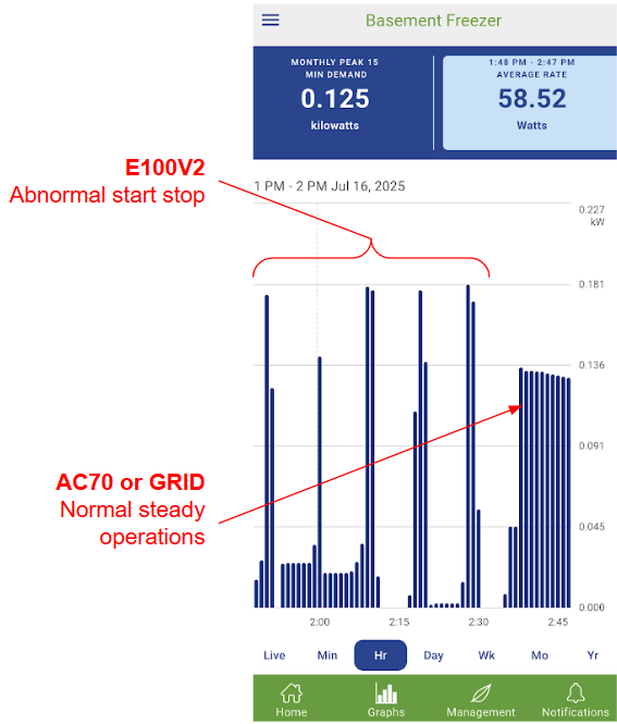

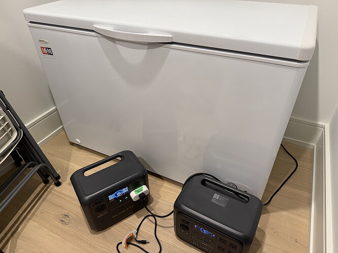

I believe I have discovered a potential issue with the E100V2 when powering compressors equipped fridge, freezer and AC units. I had been backing up a freezer using an AC70. Upon learning that AC70 won’t automatically restore AC power after it shuts down, I upgraded it to E100V2.
However, the E100V2 cannot power the same freezer.
This is a chest freezer that uses about 150w when in operation.
If this freezer is running, and I unplug it and plug it back in, it would try to pull 1000+ watt then the freezer would auto shut down, due to high pressure compressor lock, that is normal. The freezer would restart in 8 minutes or so. There is where the problem occurs…
On the AC70 (or Grid), the freezer would then pull 150w and run for as long as it needs to cool. On the E100V2, it would try to pull 300w, but the compressor will not make a normal sound, and would cycle off in 1-2 minutes, only to repeat every 8 minutes or so. It appears that something about the E100V2 isn’t allowing the compressor to restart properly. Turning on power lifting mode didn’t made a difference

I thought that the compressor pressure was high due to recent running so I let the freezer sit for 30 minutes before plugging the E100V2 into it. However, I didn’t observe any different behavior, it still runs abnormally for 2 minutes before stopping. It seems like this unit has a problem and cannot run / backup a fridge, freezer etc… which is a major issue that needs to be addressed.

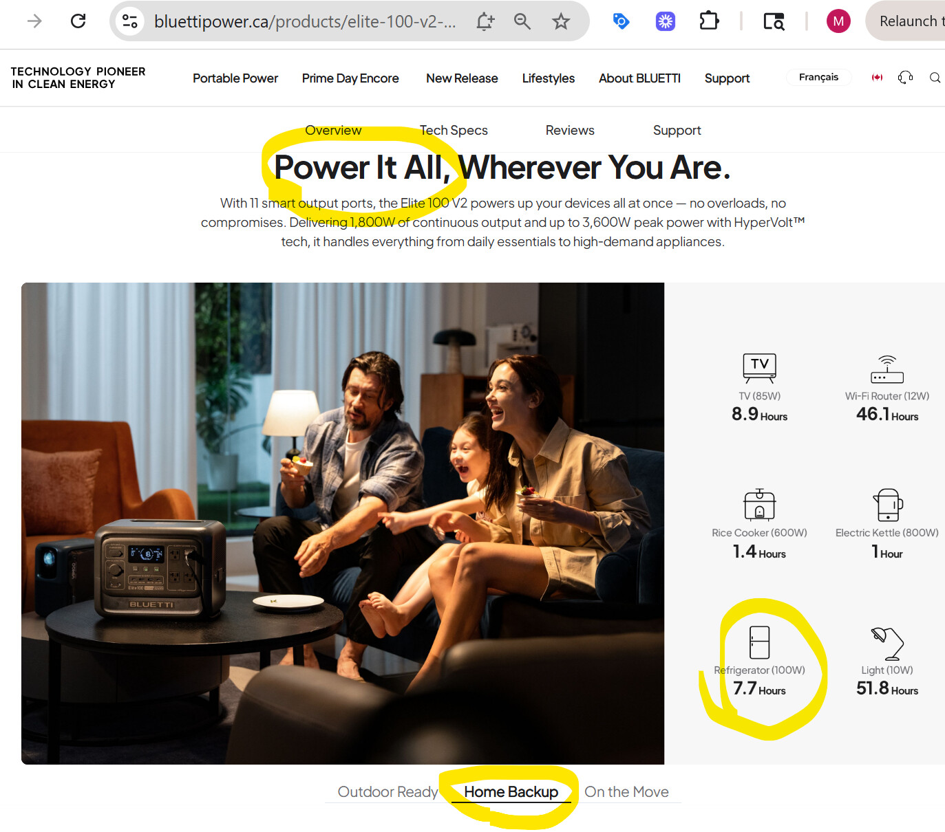

The Elite 100 V2 was explicitly promoted on their buy page for home backup and even has an example of run time on a fridge. So it is reasonable for one to buy it for that advertiser purpose. Let’s hope Bluetti team sees this and is working on a fix that can be applied via software.

That is an excellent observation @snowstorm . If it was not listed that would be one thing but advertising is another.

My freezer is still short cycling and won’t run continuously. It would try to start, pull 350w, stop after 1 minute, then retry again in 5-6 minutes. When on grid power or AC70 or Apex300, it would pull 120-150w and run for a much longer period of time. Another thing I tried to do is to run a hair dryer on low (350w resistive) together with the freezer, to see if a mid-sized resistive load would stabilize things by adjusting the blended power factor, but it didn’t seem to matter and it is still short cycling. I tried to run my miter saw with it, this is also an inductive load and pulls >1800w for a split second on startup, but then stabilizes around 800w when spinning. There are no apparent issues, though this is a “dumb” device and would keep going no matter what so it might not be the best indicator.change.

My concern here is that the new E100v2 is not capable of powering my 120v AC chest freezer which usually uses 100-150w when running. The AC70 and AC300 and Apex300 can.

My freezer is a Danby Designer chest freezer DCFM289WDD
