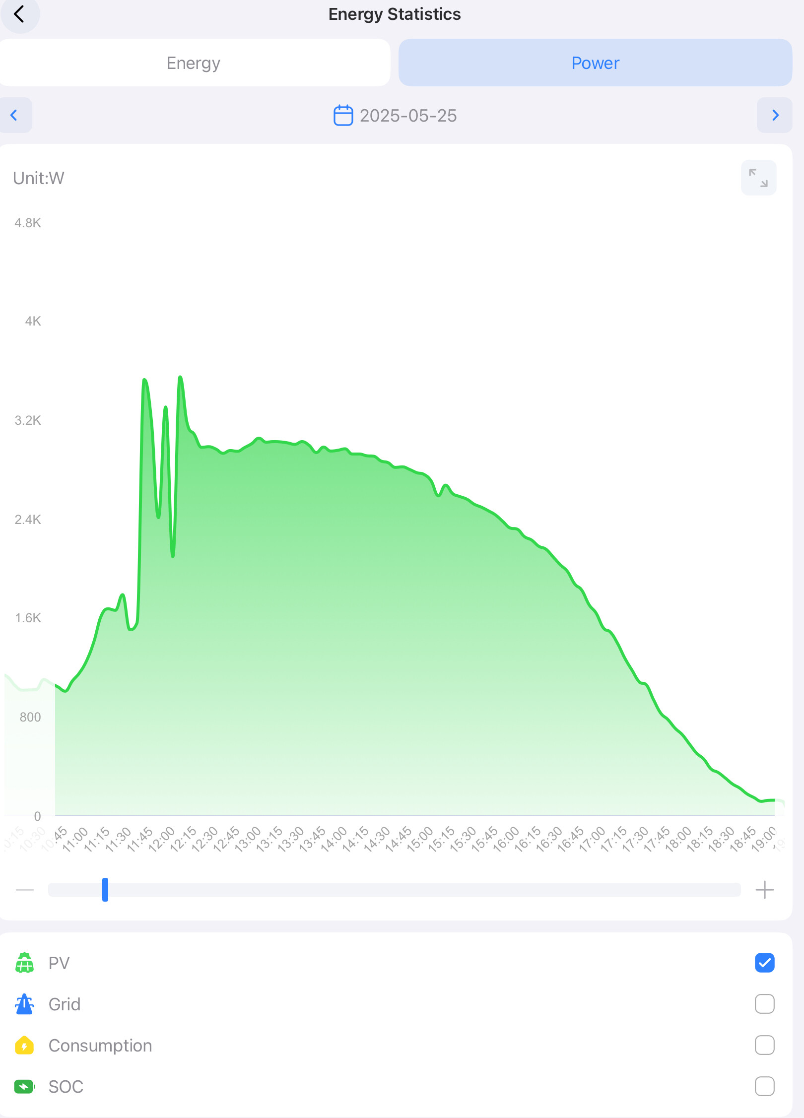

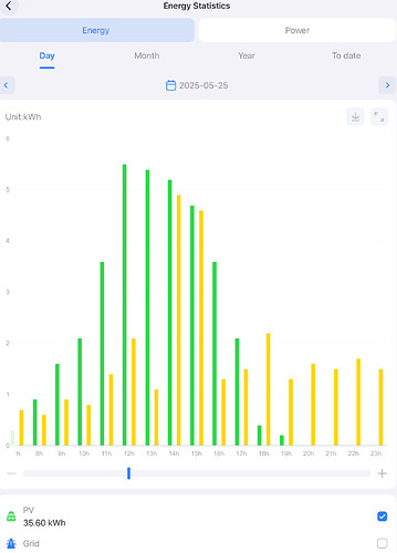

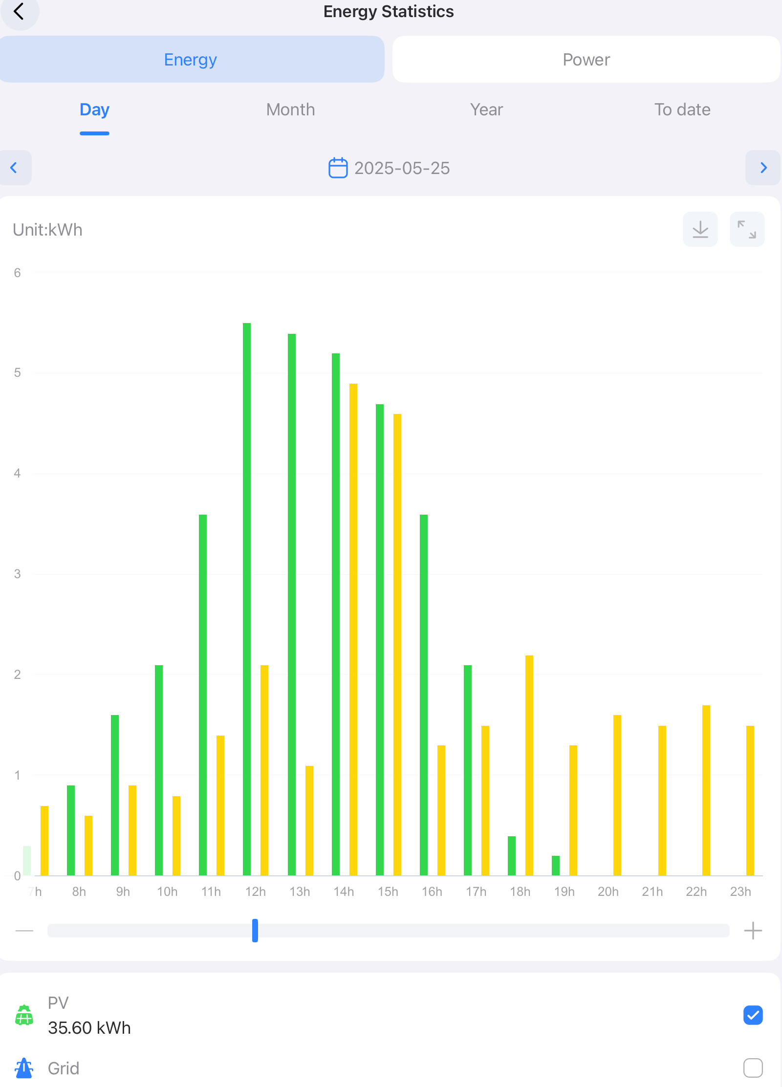

I only have 10 panels (370w each). the Power wattage throughout a day looks reasonable in the report, no where exceed 4k watts. But the I don’t understand the Energy kWh report. At some peak hours, it says my panels generate more than 5kWh electricity per hour. It doesn’t align to the power report in my common sense. Is there a reporting bug in the app? see attached screenshots.
