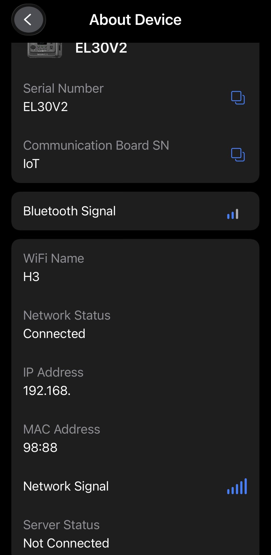

I’m experiencing an intermittent connection issue with my Bluetti Elite 30 V2. From time to time, the unit fails to connect to the cloud service for about 8–10 hours, after which it starts working normally again.
Issue
When I open the Bluetti app and select my Bluetti Elite 30 V2, I’m prompted to connect via Bluetooth instead of Cloud.
In the app, under Settings → About Device, the Server Status shows Not Connected (see screenshot).
screenshots (click to expand)
I’ve tested this on both my home Wi-Fi network and a mobile hotspot, but the result is the same — the device only connects via Bluetooth during these outage periods.
Main Problem
The unit occasionally fails to connect to the cloud service for several hours before the connection restores itself. As a result, the energy data is not recorded during these periods.

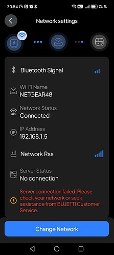

Also having cloud connection issues since yesterday. It was back up this morning, but keeps going offline. I think this is a temporary problem, and will be fixed soon.
Hi @mr.stone, Thank you for your detailed description—we have understood the issue, but are not yet certain of the cause.
We have submitted it to the app team for discussion. Meanwhile, we would like to know the SN code of your Elite 30 V2. Could you provide it to facilitate our ongoing analysis?
Thank you for @Sideeffect’s attention and sharing.
Hi @mr.stone,
I’m experiencing the same issue with my Elite 200 V2.
However, when I try do access the unit and I get a message like you do I noticed that, if I pull the Home Screen down to update it, the unit becomes accessible. If I don’t pull down, it keeps giving the same error message like yours. I think that, when I request the update (pulling down the Home Screen), it retries the connection and it get back online again.
I believe worth a try by your side.
Both of my Elite 200 V2 have the same issue
It’s happened a few times lately.
The first time it helped to restart my router, but it doesn’t help anymore!
It should be said that all my wi-fi devices work without problems
