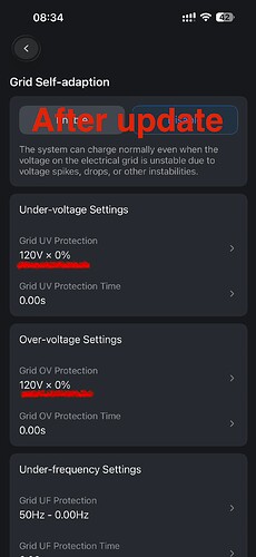

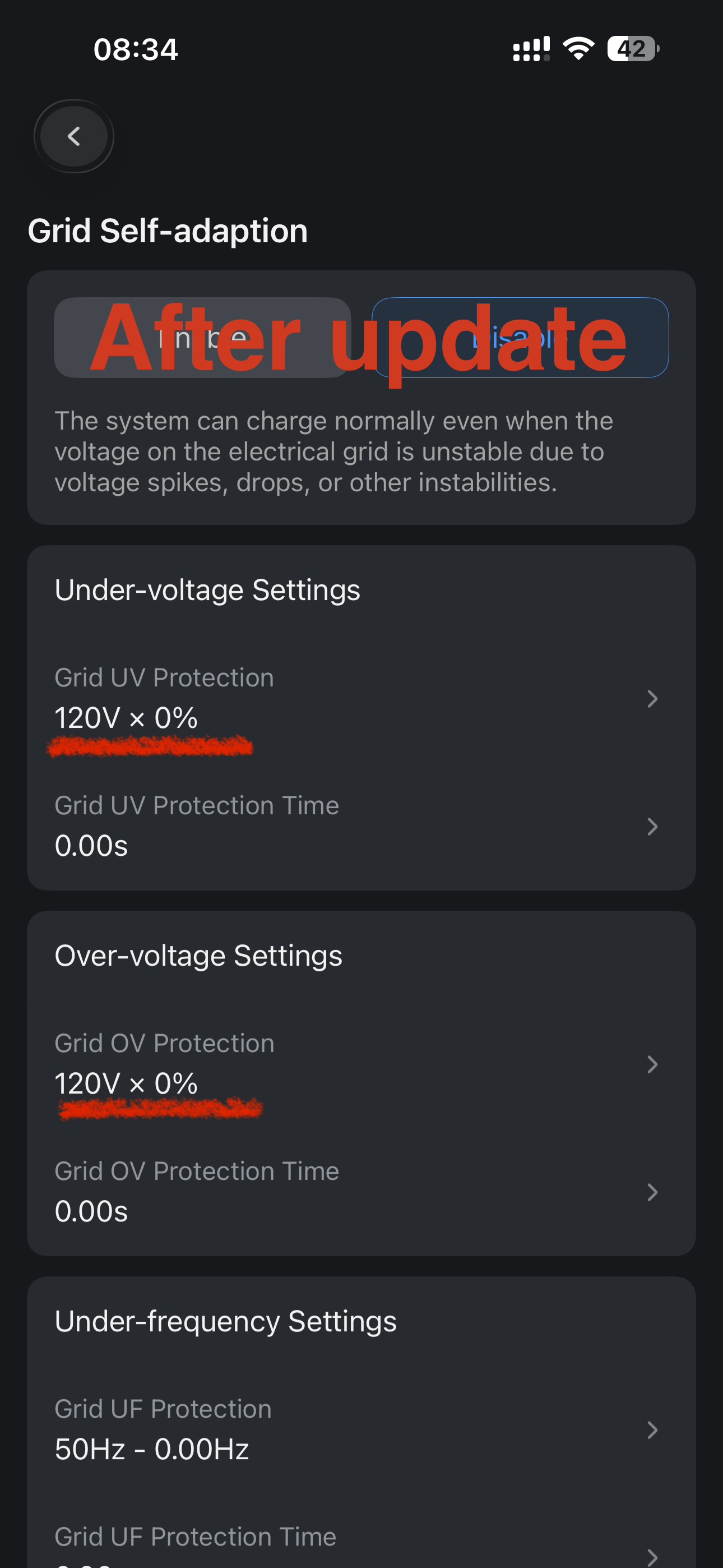

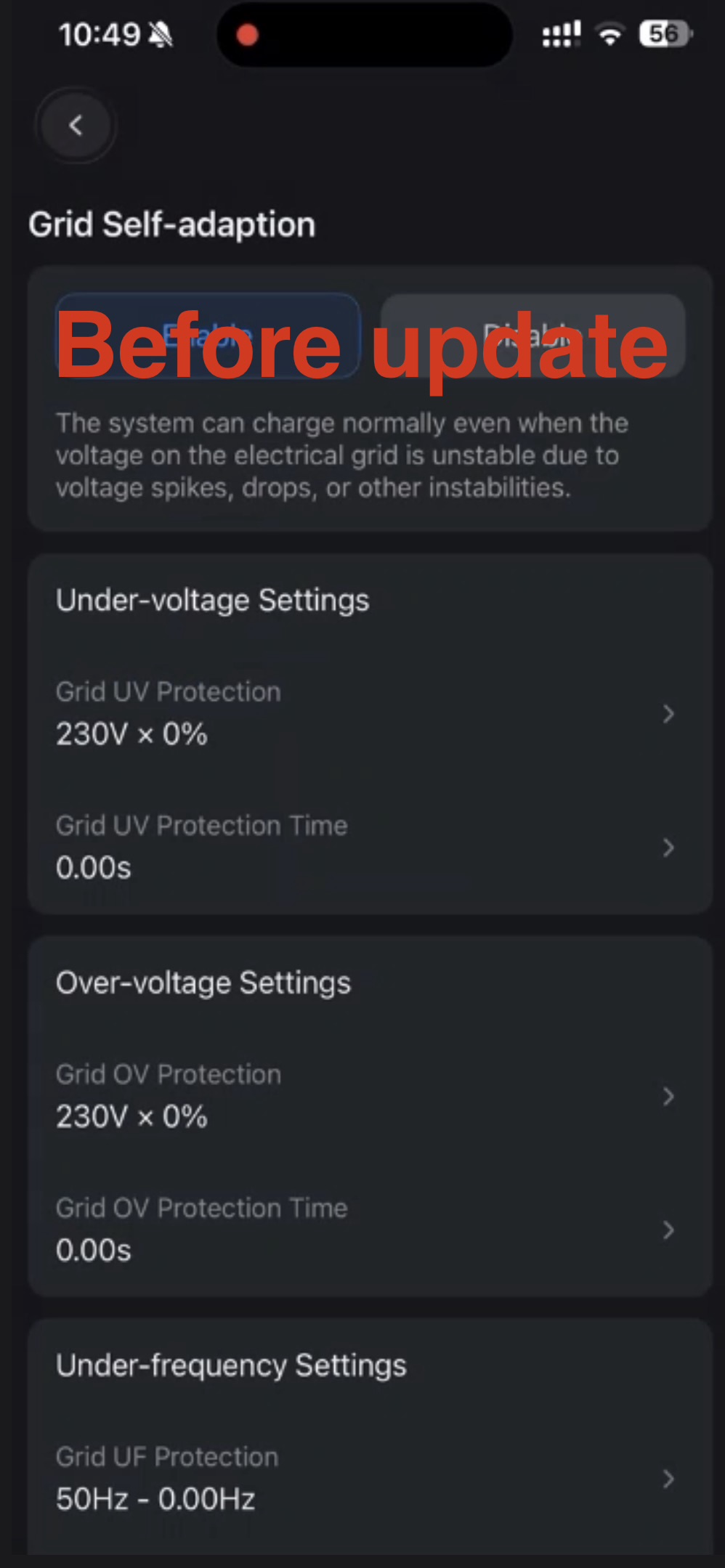

I have successfully updated my AC200PL to ARM v2140.06. I have noticed two issues that seem incorrect for my region (Ukraine, 230V standard):
Issue 1: Incorrect Voltage in the Grid Self-Adaption settings
In the “Grid Self-Adaption” section, all settings now show 120V.
Before the update: It was showing 230V.
Current situation: My country’s (Ukraine) standard is 230V, but the app shows 120V.
Is this a regional firmware error?

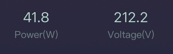

Issue 2: Low AC Output Voltage
When the device is not connected to the grid (AC Input: 0W) and running on battery with a 40W load:
Actual Output: The AC output voltage is only 210V - 215V.
IMG_8741
Expected Output: It should be 230V.
Is this drop in voltage normal for this firmware version, or is it related to the 120V/230V discrepancy mentioned above?
