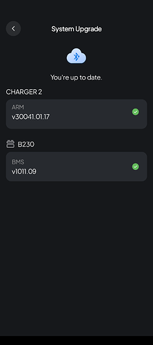

I am still having this error occur.
My charger 2 Arm is v30041.01.17
My B230 BMS is v1011.09
@BLUETTI can you confirm if my charger 2 needs an arm upgrade and when the development team is expecting to release the update?

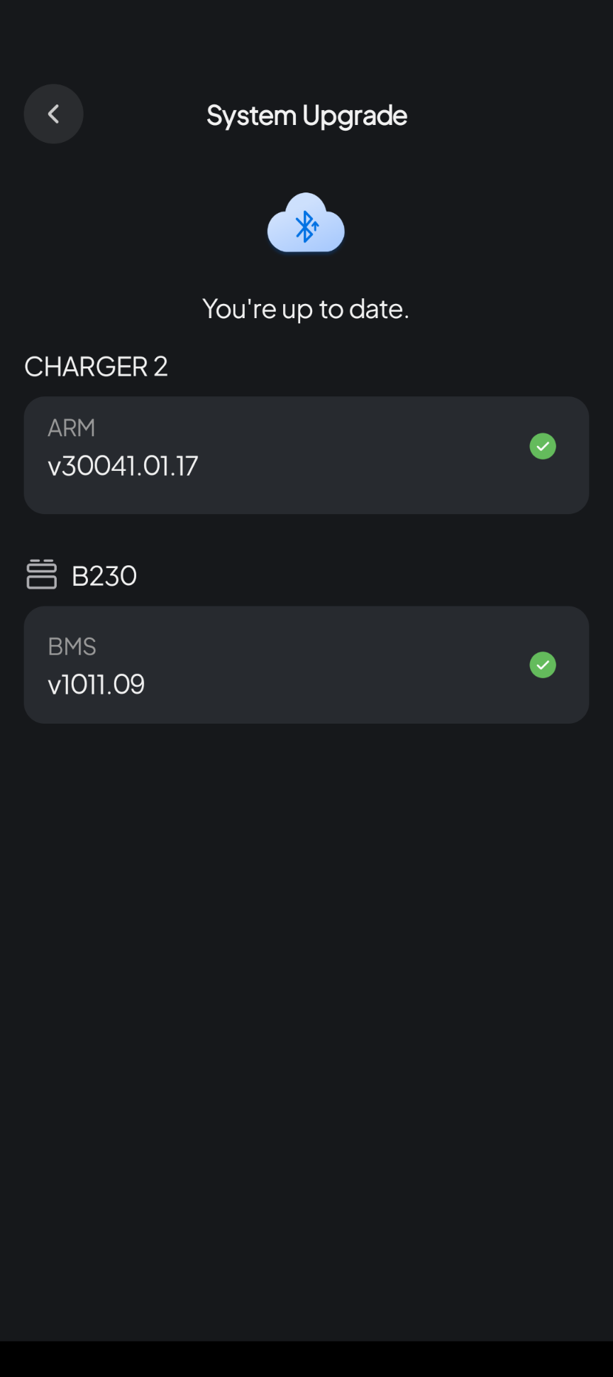

I updated the charger 2 to the newest firmware but am still having this issue. I also do not see an update available for the B230, has that been pushed to my serial number yet? Here is a screenshot of my current firmware for charger 2 and b230
Sorry for the late reply. We’ve just pushed a new version. Also, please note that once the vehicle stops, CH2 stopping charging is normal behavior—this is designed to prevent the vehicle battery from being drained. If it doesn’t stop, the vehicle battery could be depleted.
