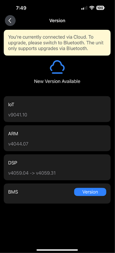

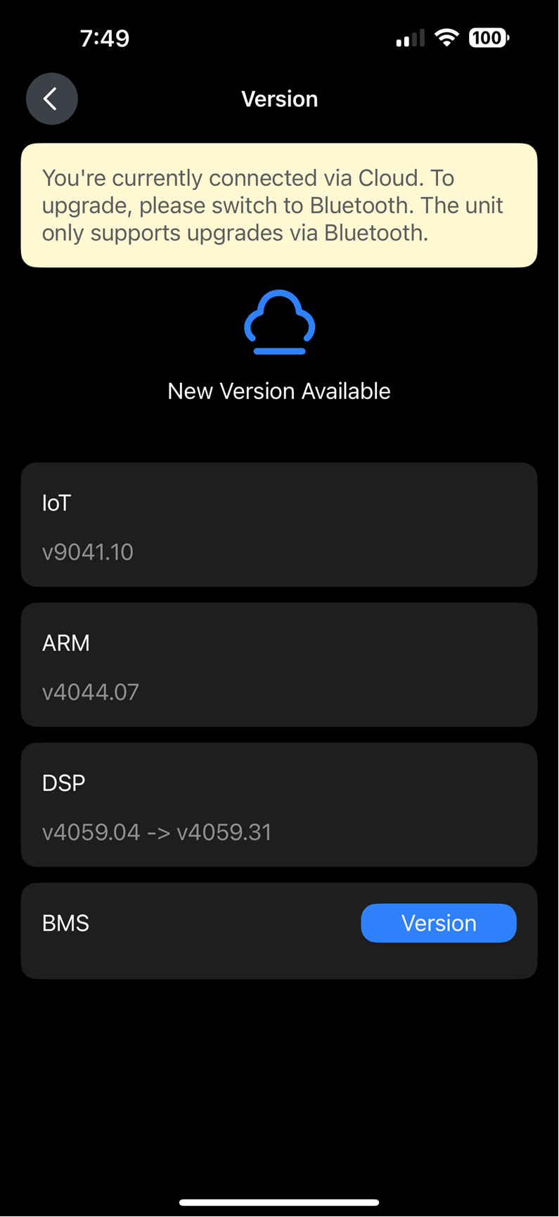

Thank you for the response. The app wants me to update by Bluetooth only and you say not to. So How do I update the firmware?
Hi @TxPacker, When upgrading the firmware, Bluetooth connection is indeed required, which means you need to register and log in to your account, and bind this device.
It is not the Bluetooth direct connection mode. This mode does not require registration and binding, but only has limited operation permissions and cannot upgrade the firmware.
Please refer to the following screenshot to correctly log in and bind the device, and then perform the upgrade.

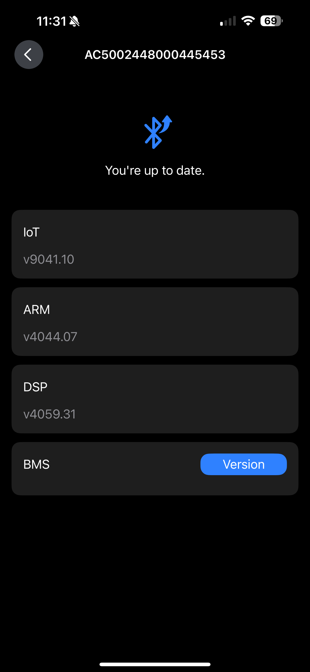

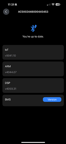

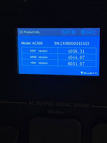

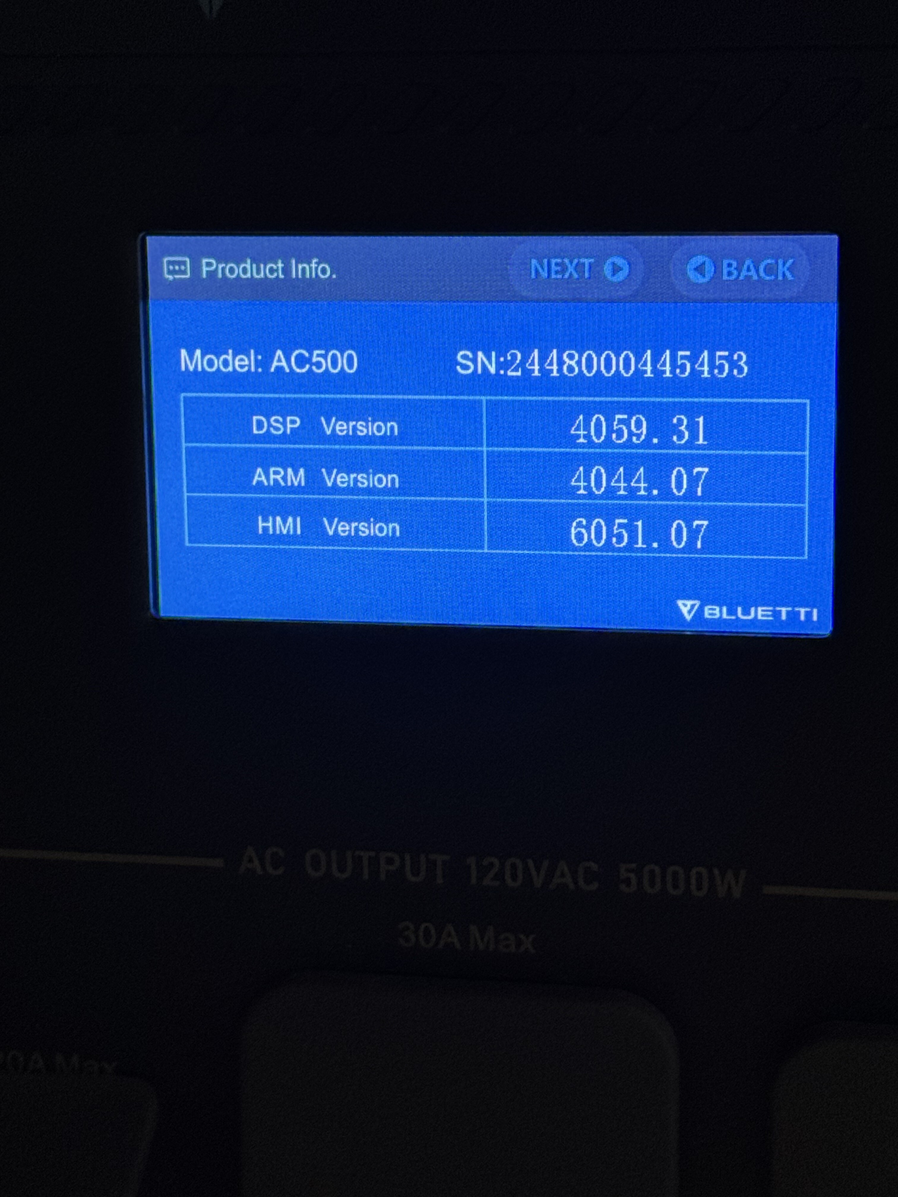

So I’ve updated the firmware as instructed and the unit is still behaving as before. I was able to get to 3150 watts without shutting down but at 3600 to 3800 it shut down. It’s reboot up and turn power back on as before. I do believe I have a AC300 just marked as an AC500. I’ve seen on Youtube videos of the AC300 going as high has 3600 and the AC500 going to about 5300 before it shuts down. I purchased this from Amazon and am ready to do a return if we can not get this resolved. Do I have a defective unit? as I believe no firmware will resolve this. What other action can I do?
Here is the Firmware that was installed
