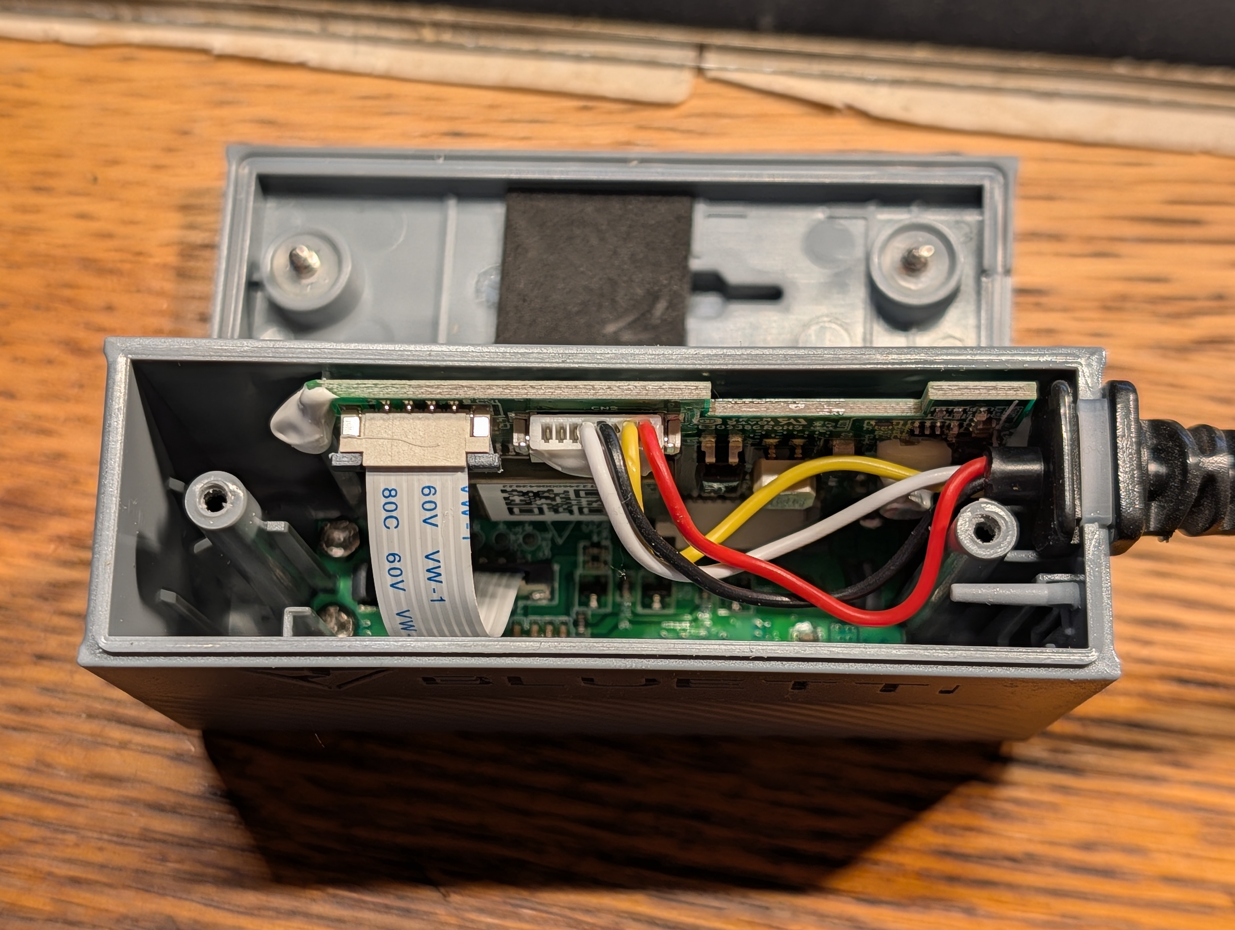

The IoT box itself is connected to the EP600 via a 4-pin cable; presumably, two wires are for power and the other two are for communication—at least that seems logical to me:
Has anyone tried this before, or does anyone have a pinout diagram for the IoT Box that I can use to identify the wires?

Wiring is as per your assumption: power and CAN L+H communication.
You could intercept the red wire to shutdown and restart the unit.

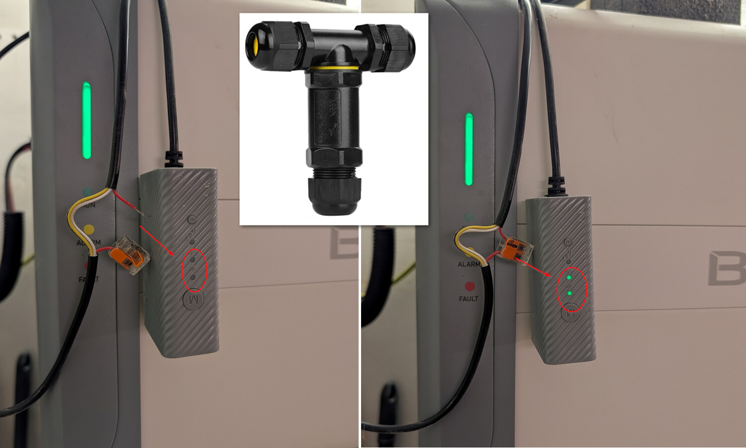

I just ran an initial test by disconnecting the red wire.
It works as expected: the IoT box turns off, and after reconnecting the red wire, the IoT box turns back on and reconnects to Wi-Fi and Bluetooth. ;-)
I’ll then replace the terminal block with one of those fancy T-cable connectors and connect it to the control cable. Then I can use the relay to turn the IoT box on and off remotely as I please.

For what regards the wire coloring, to keep in mind:
RED: shared negative between CAN and power (yes it’s RED and not a positive), you disconnect this to cut the negative of both the power line and the CAN bus line, which is the correct way to restart the unit (and also safest if you accidentally short it to ground)
YELLOW: positive 12 VDC
BLACK: CAN H
WHITE: CAN L
The WAGO is really just for testing; that’s where the T-connector will go, and a relay will handle the disconnection in the future.
