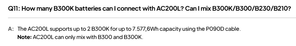

Cable for synchronization with the station, is it definitely included with the 300K? I asked a question on one of the well-known Ukrainian sites - and received an answer that there is no cable included.
@N1k3 Please refer to the screenshot of the B300K official manual. The P090A cable included with the packaging is compatible with AC200PL/AC200L;
however, I can’t be sure if the local distributor in Ukraine will sell the cables separately.

@Protspace Sorry, man, but I don’t think you can mix b210p and b300k with AC200PL. It’s only an option for AC200MAX. And I didn’t know that. At least that’s what public info says.
@BLUETTI can you confirm?
