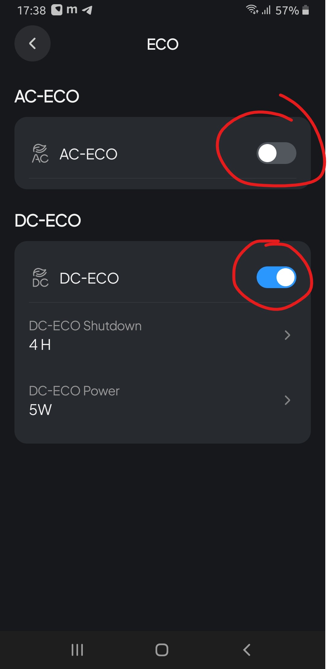

Hi this is the first time I have used this Forum. I own the Elite 100 V2. I need to permanently disable the ECO mode to enable me to run a compressor fridge in my campervan. I am able to disable it for 4 hours via the app on my phone, after which time it turns the power station off and the fridge defrosts!!! Can someone please tell me how to do this? Thanks

Tap on these :arrow_down:

A lot of people get confused by Eco mode. The 4 hours that shows on the Eco mode settings page is how long it will wait after there is no power draw before turning itself off. The time setting can be changed.
As VSM showed in his reply, Eco mode can just be turned off via the buttons (for AC and /or DC). I’m sure some people find it useful, but in over 2 years I have never needed to use Eco mode so it’s always turned off on all my devices.
Thank you, just tried it, solved my problem
