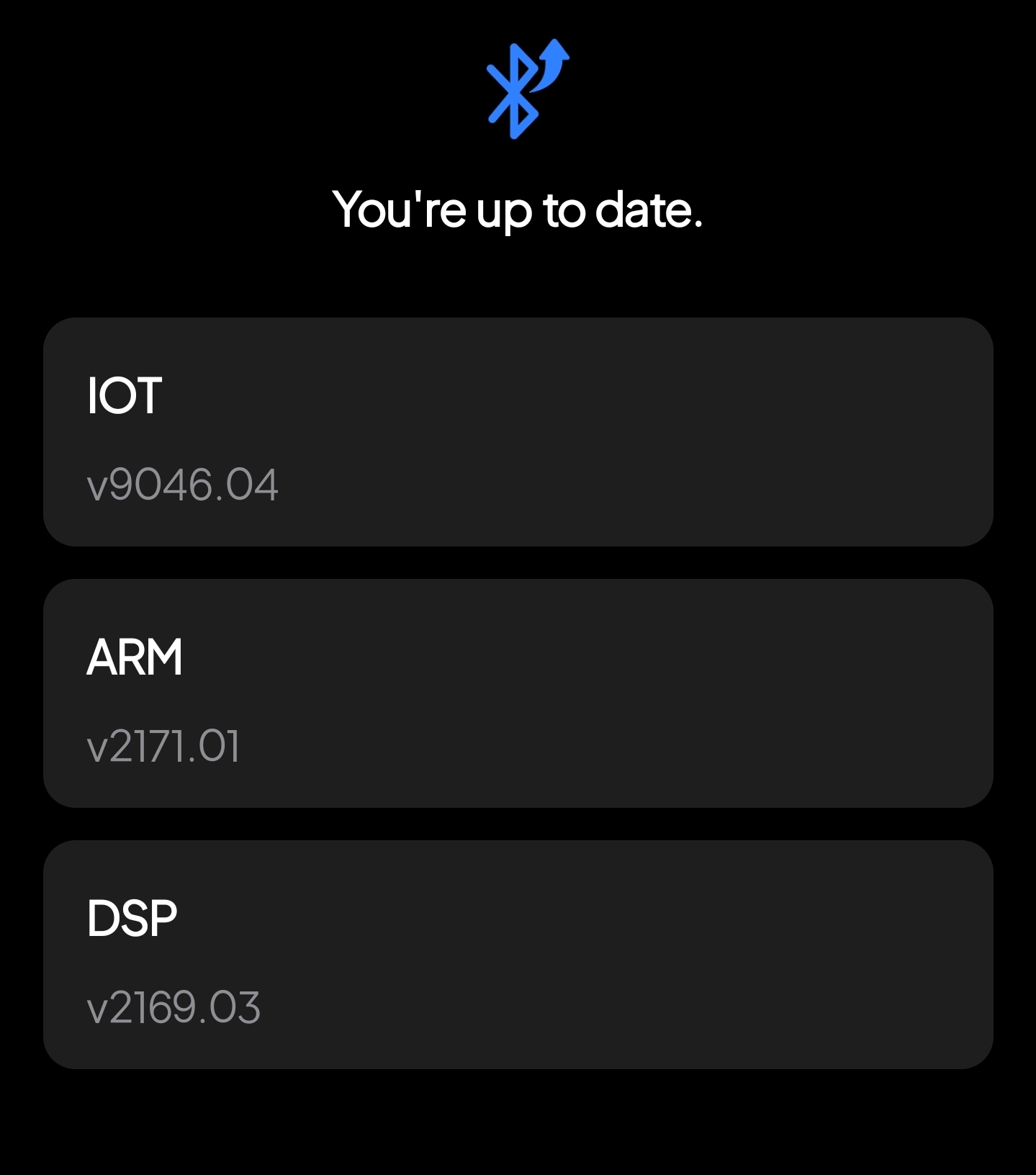

Hello @BLUETTI,
I have the same issue as dj_oni and Roland98 with the System Switch Recovery function on my AC50P.
When the battery reaches 0% and the unit shuts down with AC output active, after reconnecting to grid power and the unit starts charging, it does not restore the AC output state even after reaching 5% SOC or higher. The System Switch Recovery setting also gets automatically disabled after the restart.
Could you please push the ARM217102 firmware update to my device as well?
My device details:
• Model: AC50P
• Serial Number: AC50P2528001120008
• Current Firmware: v2171.01
Thank you for your assistance!
