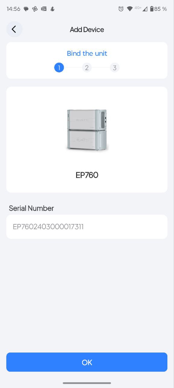

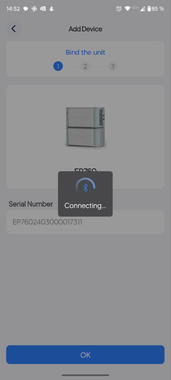

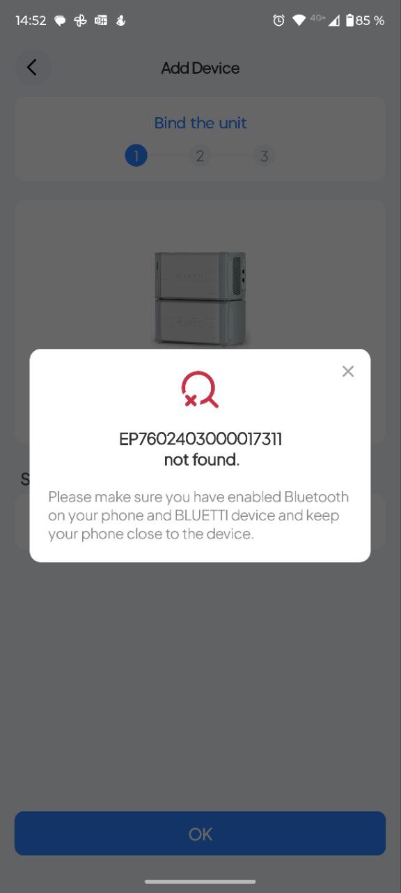

I re-logged into the app and account. Rebooted the station and controller. Deleted and re-added via scanning EP760. Still can’t connect via Bluetooth. On Bluetooth I still only see the controller.

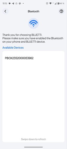

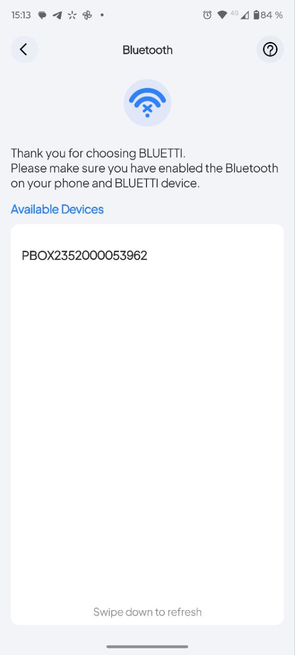

As I described before, I can connect to the IOT via Bluetooth (after the update it is called PBOX…). But, I cannot connect to the inactive EP760…311 in any way, neither via Bluetooth nor via Wi-Fi. That is, remote control is not available.

I have followed all recommended steps: re-logged into the app, rebooted the station and controller, removed and re-added EP760 via QR scan, and activated Pro Mode — but the unit remains greyed-out in the app, and I still cannot connect to the EP760 (only to the controller).

Hi @Bohdan_D, Regarding this issue, please note that after updating the PBOX, the SN code of the EP760 will no longer be usable—only the SN code of the new PBOX can be used for connection. Please test this and let us know if it works.

As I described earlier, I can connect to PBOX23…62 via Bluetooth, which is visible in the Bluetooth section (last screenshot). But, the functionality is limited (compared to the possible connection via My Devices) and Wi-Fi control and remote control via the cloud are not available. Also, the possibility of subsequent software updates even via Bluetooth is inactive.
