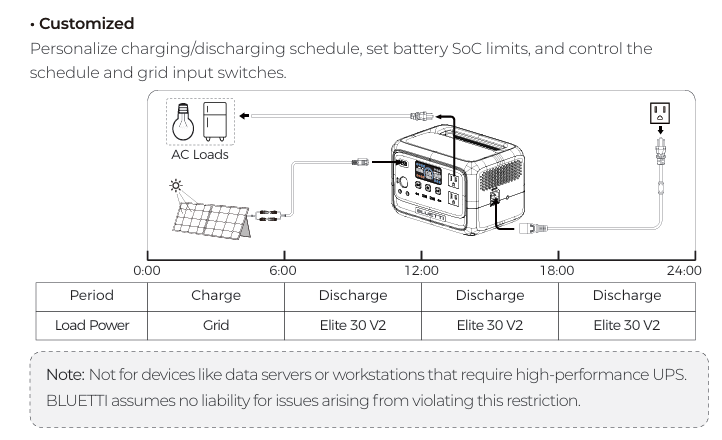

The Elite 30 V2 supports 4 UPS modes. We recommend using the Customized UPS mode, where you can set the SOC value and choose whether to charge from the grid based on your needs.

In addition, I’m using the customized UPS mode with the settings shown below:

Hi @mr.stone, We have already responded to your other post with the same content, and we are repeating the reply here.
Thank you for your attention to this issue.
You hope that the Elite 30 V2 can set the maximum SOC value to 80% when charging and the minimum SOC value to 20% when discharging—Is that correct? This is indeed helpful for maintaining battery life.
We have forwarded your request to the R&D department, they are very interested in it. However, due to hardware limitations, it is difficult to add this function to the already released power stations.
We anticipate that this function will be applied to new models.
