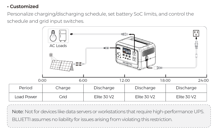

Hi mr.stone, Thank you for your attention to BLUETTI.
The Elite 30 V2 supports 4 UPS modes. We recommend using the Customized UPS mode, where you can set the SOC value and choose whether to charge from the grid based on your needs.

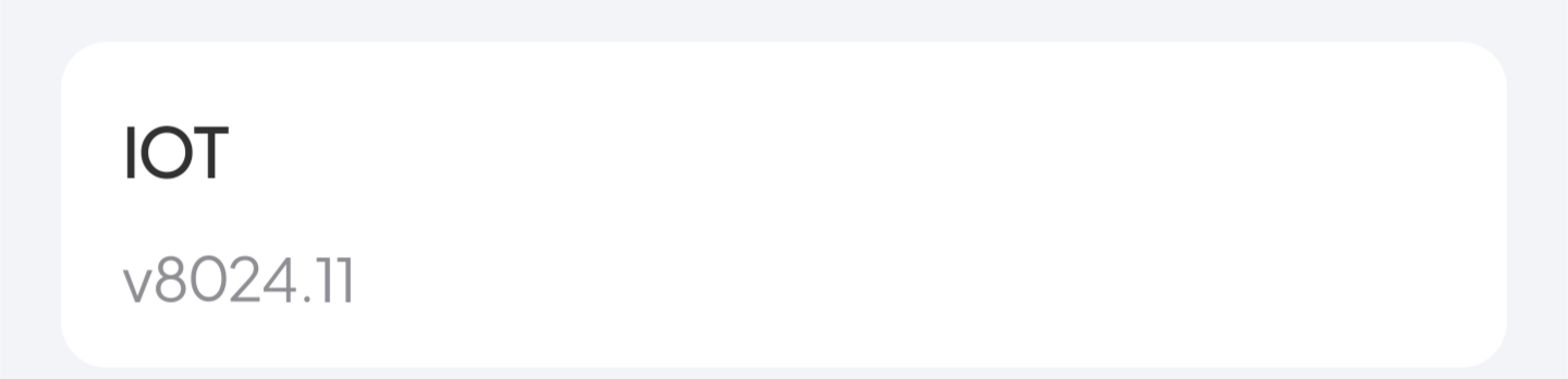

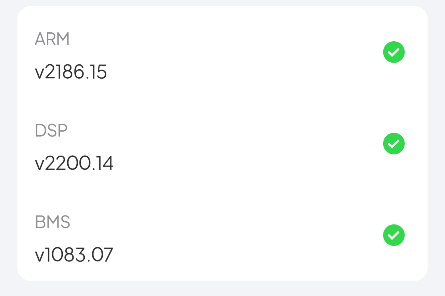

Firmware Versions
Module Status Installed
IoT Up to date v8024.11
ARM Up to date v2203.08
DSP Up to date v2202.11
BMS Up to date v1087.05
