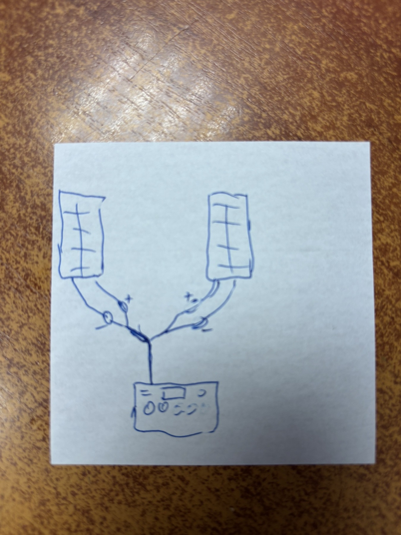

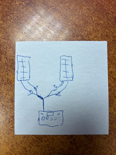

2 series of 2 solar 425w per panel, using the connector of Bluetti to paralel the 2 series and connect to the AC 300. I regularly get error 065, PV paralleling error (but that also disappears again). See enclosed pictures. Does anyone know the reason and a solution?

to be honest, i dont understand why you even connect it like that. You have 4 Panels and 2 pairs that connected in series. Why not connect Pair 1 to MPPT 1 and Pair 2 to MPPT 2?
When connected like mentioned, you dont need PV parallel at all.

Hi @Roel, @Selfmadestrom’s opinion is correct. Please turn off the PV parllel, connect solar panels and try again. Does it help?

The solar input cable that you have comes with 2 pairs of connectors. Check for labelling on the connector so that you can determine which is the pair for MPPT1 and which is for MPPT2. You then connect your 2 series solar panels to the MPPT1 pair, and the other 2 series panels to the MPPT2 pair. Don’t mix/cross any of the connectors like you were doing previously in your drawn diagram.

Good afternoon, today I bought two 200-watt panels and connected them as shown in the picture. They worked for two hours and produced 130 watts. There was little sun, and now it also displays the error 065 pv parallelin error.
