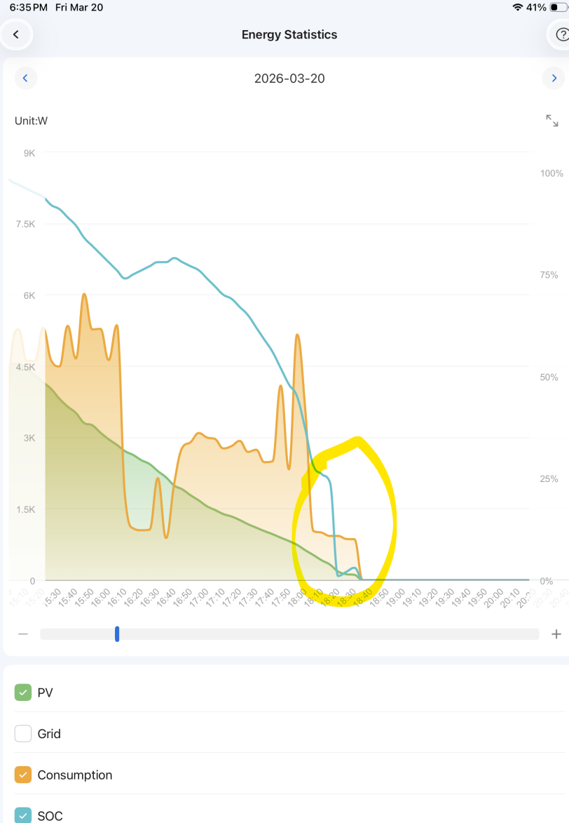

EP800 batt drop from 20% to 3% in 10 mins

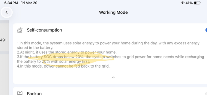

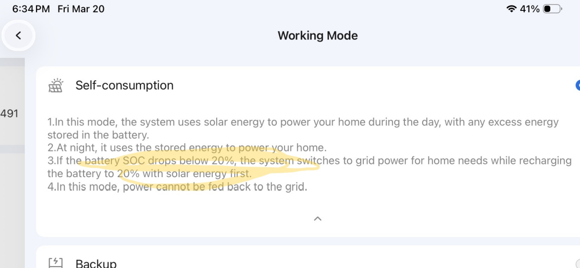

yesterday, my EP800 battery suddenly dropped below 20%, down to 3%. in 10 mins. It’s in self-consumption mode, which should prevent it from dropping below 20%. Is it a red flag to the controlling system or bad batteries? The whole system only 1 year old.

P.S.: The 20% SOC low protection is, of course, only valid for your current SOC low value; if you’ve set a different value, the 20% is no longer accurate…

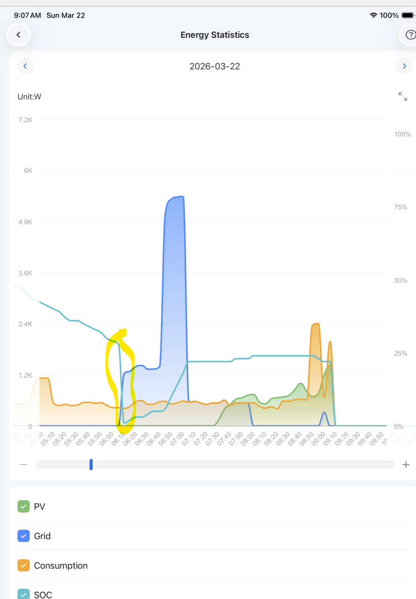

Unfortunately, the “Grid” diagram isn’t visible in your graph. It’s possible that your home is already connected to the grid, but the battery level is still dropping because it isn’t being charged—or isn’t allowed to be charged.

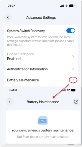

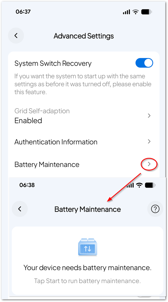

if you refer to the battery maintenance under advanced settings, I will give a try. I thought the system should do it routinely without human.
20% is SOC is the default threshold, I didn’t change.

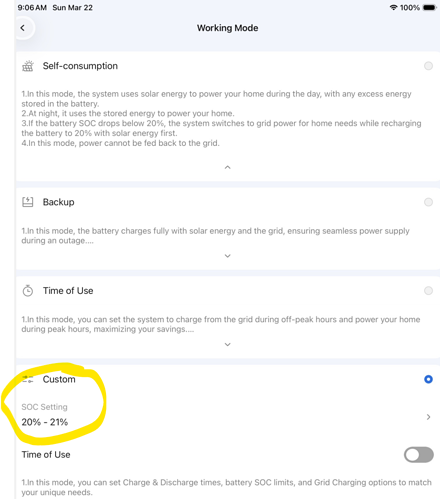

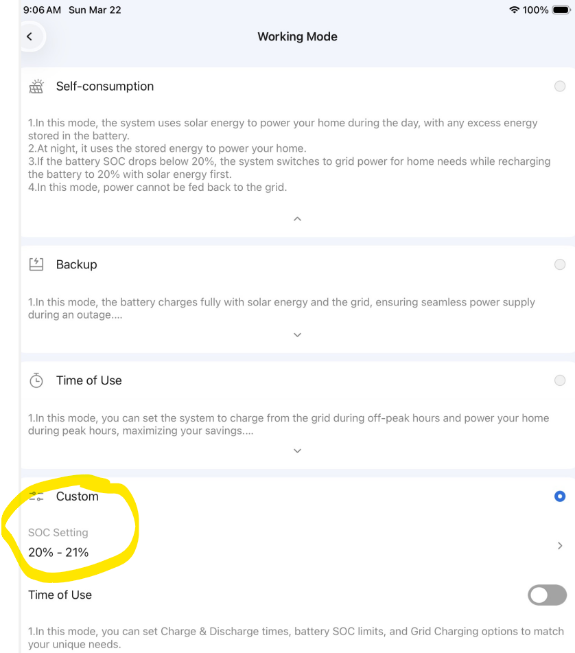

can you confirm if the maintenance option is the calibration that you said? I launched a maintenance last night and it finished successfully. But today, I see the SOC drop to 3% again. To be safe, I changed the working model from self-consumption to Custom, and set as 20%-21%. Will see if this fix the issue.

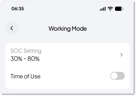

The app looks a little different for me in [Working Mode]; I don’t have a “Custom Mode,” which might be due to the different EP Models.
Yes, the battery maintenance option starts the BMS calibration.

The reason is due to bad batteries: b500. Unfortunately, both B500s on my system went bad within a year.
Good thing is Bluetti’s premium service. They can quickly identified the problem and arrange the replacements in couple days.
