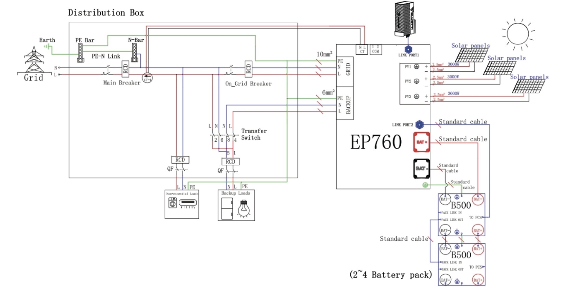

Goal: allow ep760 to offset loads on any of the three phases…
Current state: ep760 ct clamp monitors one phase, and I don’t have ac coupled solar pv.
I have purchased a Acrel ADL-400N CT 80A(CT sensors rating)…

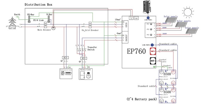

Current wiring:

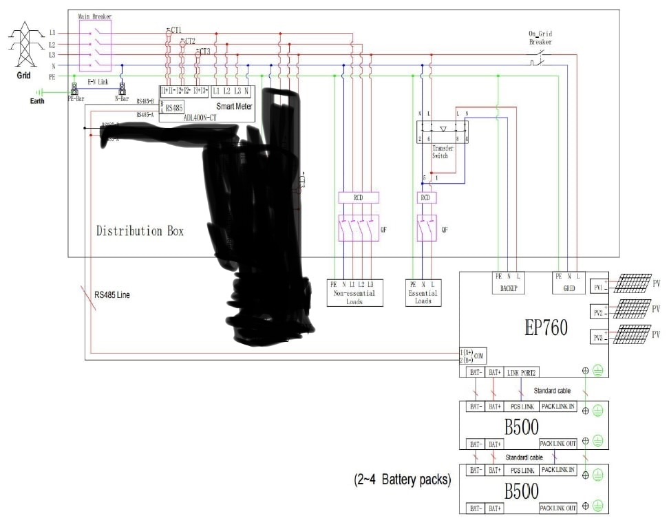

Target:
I can change the wiring around easily enough with a licensed electrician.
So questions:
  1. Can I change the ep760 settings over? If so can I please get a list of the required changes?
  2. I suspect there is configuration required on the ADL-400N, is there a list of the required settings?
  3. Are there any other considerations or concerns with this?
