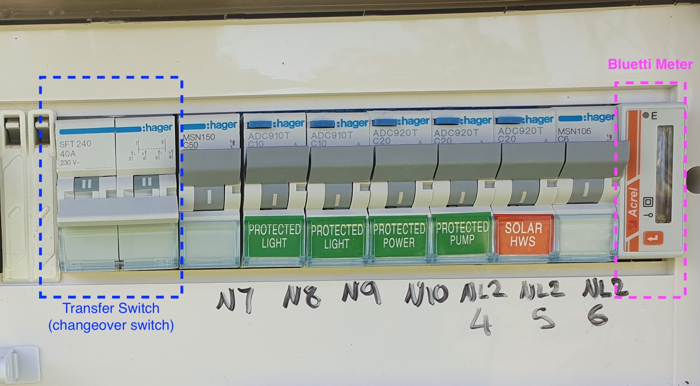

A Bluetti EP760 Inverter Energy Meter needs to be installed into the switchboard. My Bluetti meter was wired into a 6A circuit breaker. The Bluetti meter is connected by RS485 cable to the COM port of the EP760. A Current Transformer (CT) cable and clamp is attached to the Bluetti meter which is then clamped to the AC live and neutral wires between the SolarEdge HD5000 inverter and the SolarEdge Import/Export Meter (on grid side). The current direction arrow of the CT points from HD5000 towards grid. This allows EP760 to know how much solar the HD5000 is producing and sending into AC side.

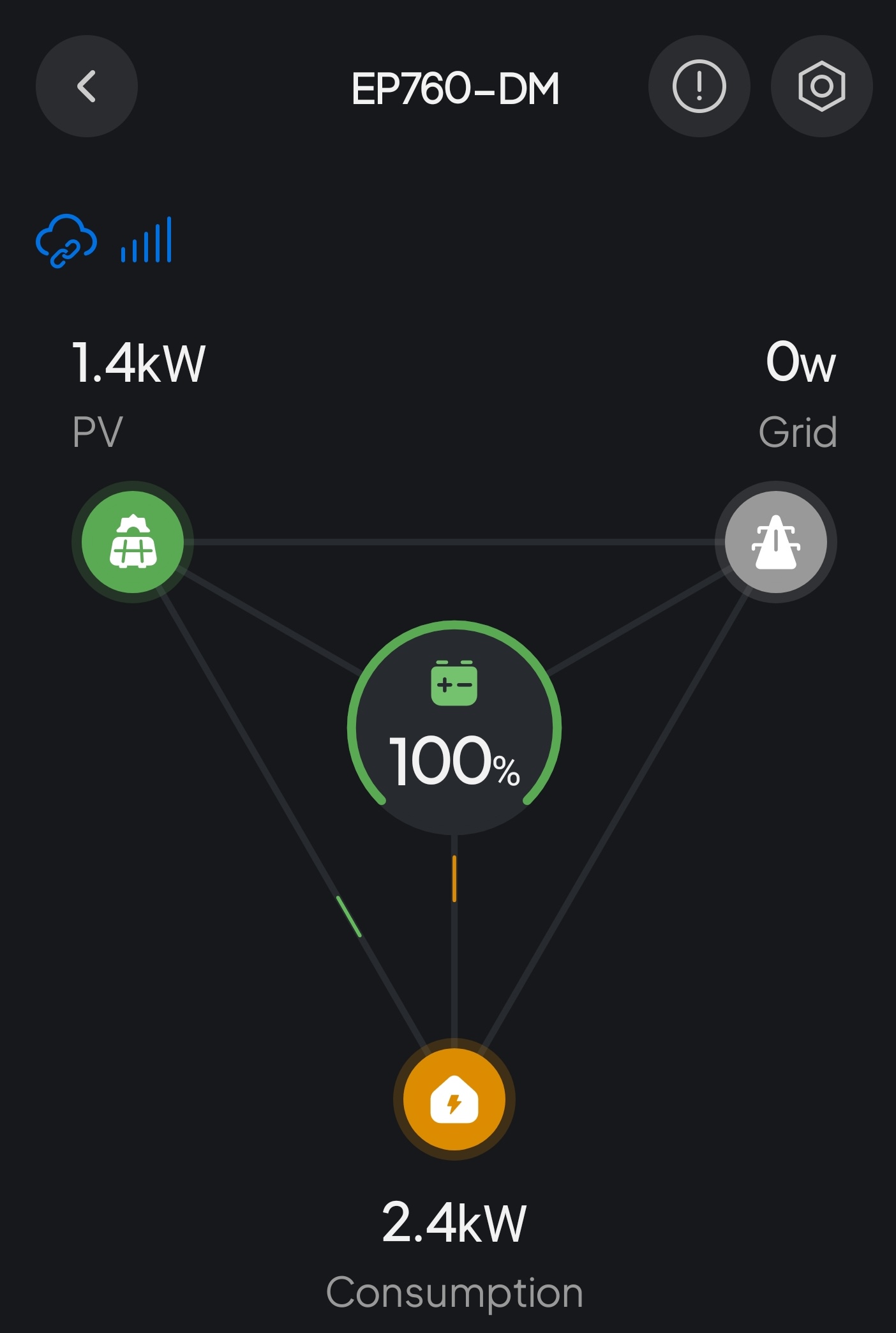

Because of the meters and CTs, the EP760 is aware when the SolaEdge is exporting and the Bluetti app updates the export counter under Energy Statistics.

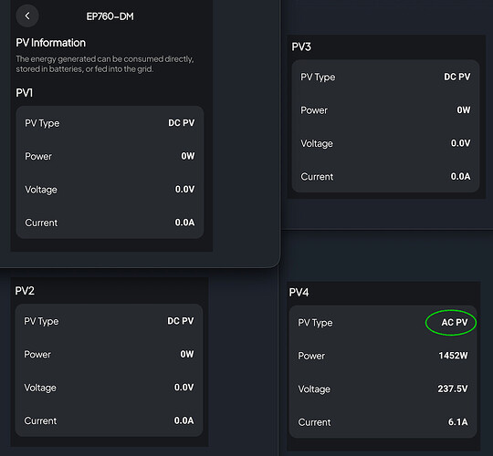

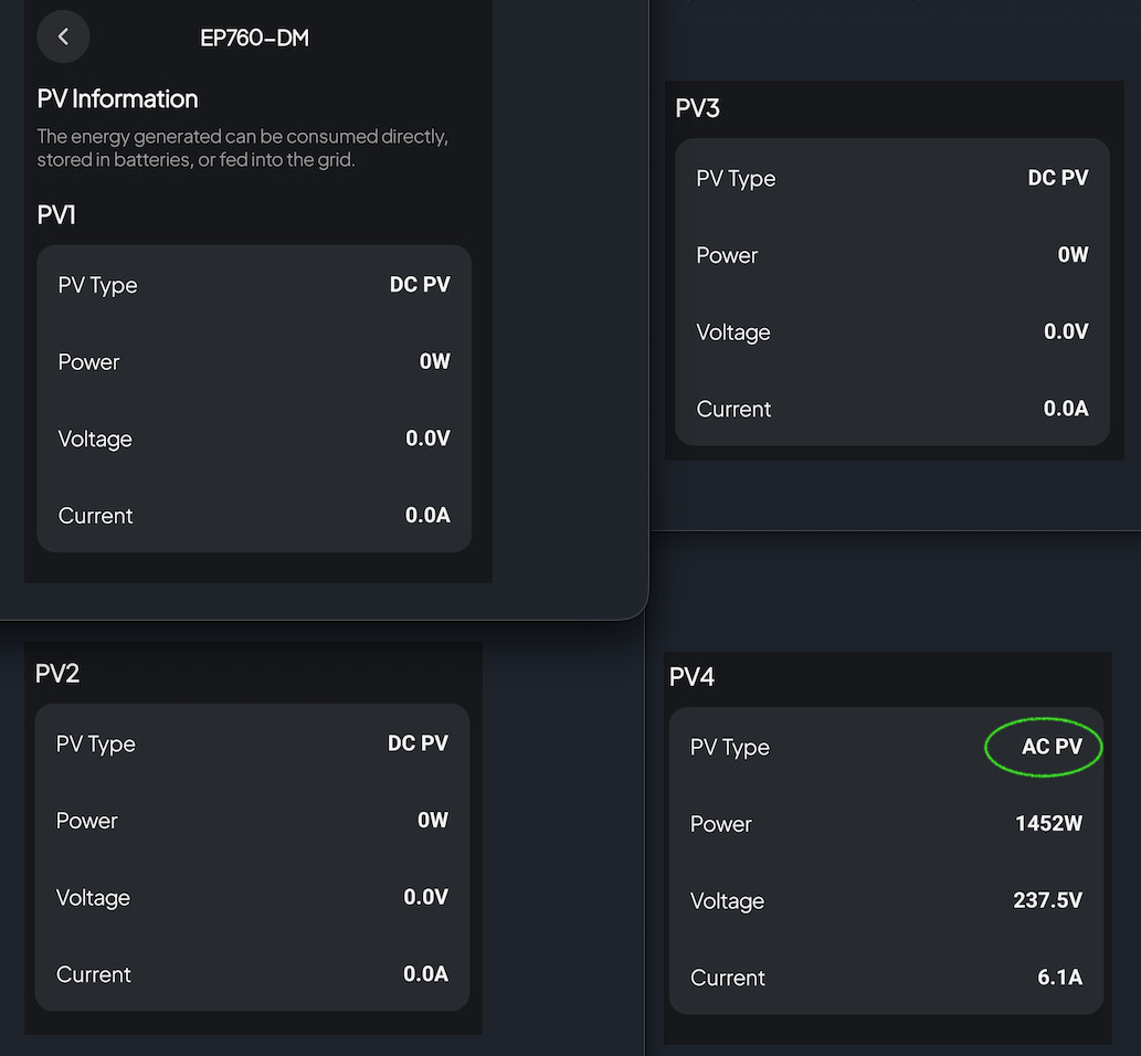

The app sees the energy produced by SolarEdge as “AC PV” rather than “DC PV”. It knows how much is currently being generated, how much is being used (even by unprotected loads not connected to EP760), how much is being exported by SolarEdge and how much is being imported (for both protected and unprotected loads).
When one taps on the “PV” icon in the app it reports the stats under PV4 and type “AC PV”.
