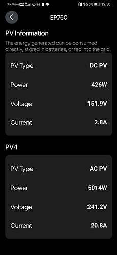

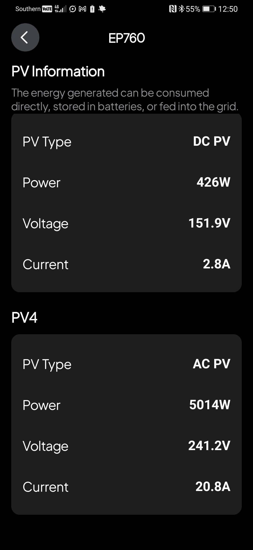

After adding some additional solar panels directly to the PV3 connection on the EP760, I found that the additional power generated is simply added to the power from my AC coupled solar system in the main view of the Bluetti app.
If I tap on the “PV” icon, I can then see an individual breakdown of the power from PV3 solar panels separately to the power generated by my existing AC coupled solar system (PV4 - AC PV).
See screenshot below.
The power generated by PV3 and PV4 are simply added together to either charge my B500 batteries, or run my local loads, or to send to the grid.
