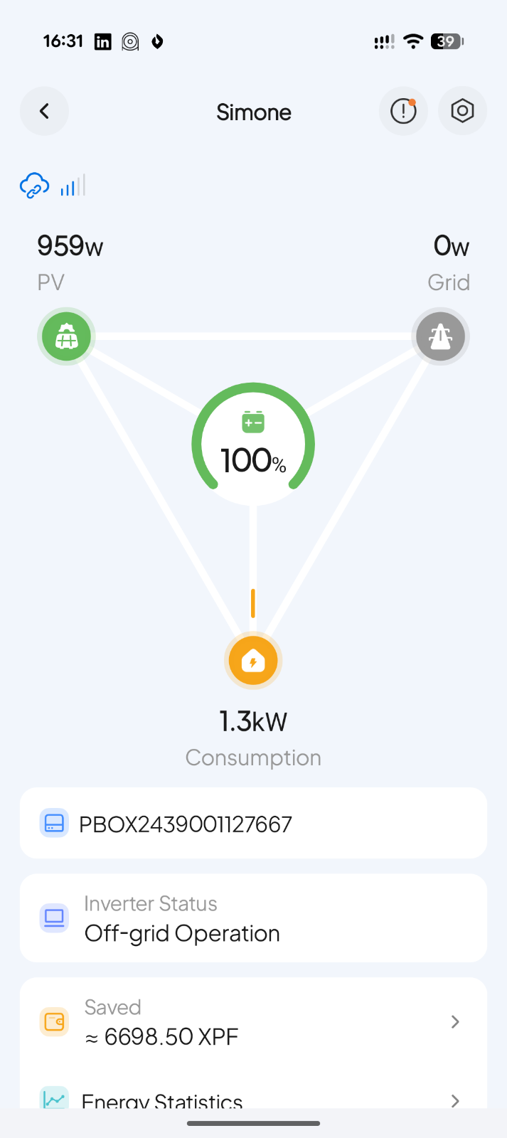

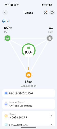

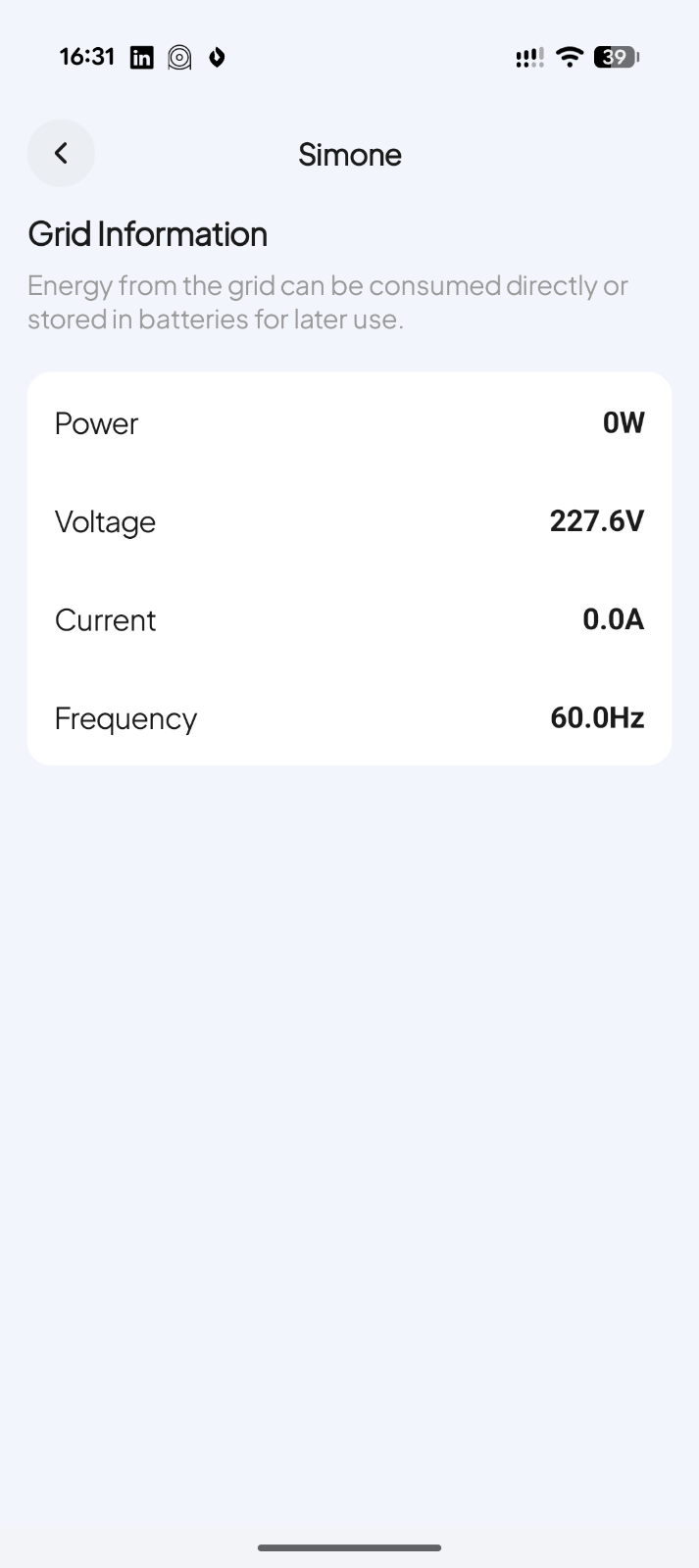

@BLUETTI_CARE I just proceed to the update of the FW of my EP760 and battery pack B500 and now my inverter is staying off-grid.

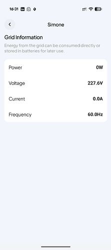

As you can see, my grid is proper (230V@60Hz) and the system has been working properly for more than 1 year now.
Can I revert the FW? I tried the self-adaptation to no success.

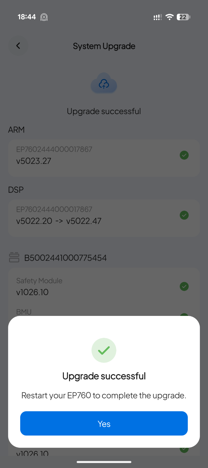

Thanks. Just received a DSP update. Installed it, say “Success, please restart your EP760 to finish it”. Toggle the On/Off switch on the app, same error, and the upgrade is still available.
Is there anything to be done to make the system accept the update @BLUETTI_CARE ?

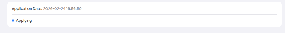

Thank you very much. I haven’t received the revert yet, will let you know.
I applied for the pro access to make sure the proper country is setup on my EP760, this seems likely to be the issue with the new FW (using 50Hz country setup when in a 60Hz country). It’s still pending. Is there anything to do to make the application go forward?

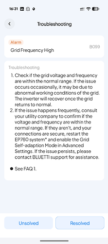

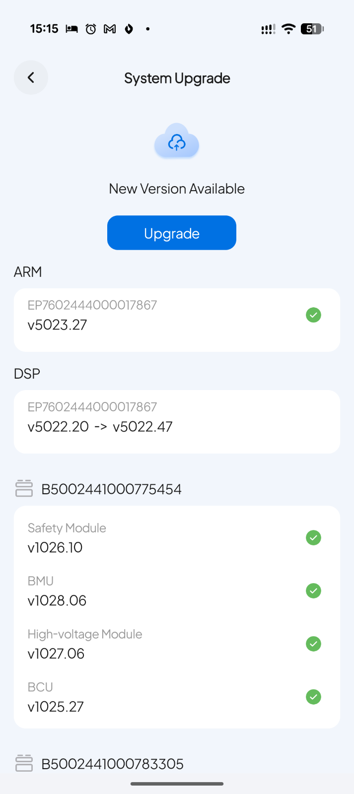

Just the screenshot of the situation - Tried another time, still the same issue and not updating the DSP

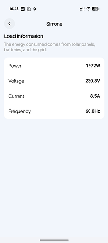

@BLUETTI_CARE Any update on the Pro mode to fix the country setup? Or on the FW update? I still can’t use the battery and my grid as a backup. Also the load is now fed with a 50Hz signal (rather than the expected 60Hz), which is not great for some of my appliance like the microwave.
The help is appreciated to fix this.

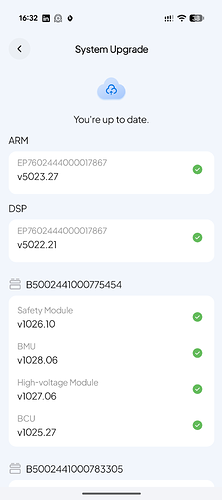

Hi @jbtheou, thank you for your update.
Since you previously applied to roll back to the original firmware, you will keep receiving upgrade prompts—but you only need to upgrade once.
We have confirmed that your rollback was successful.

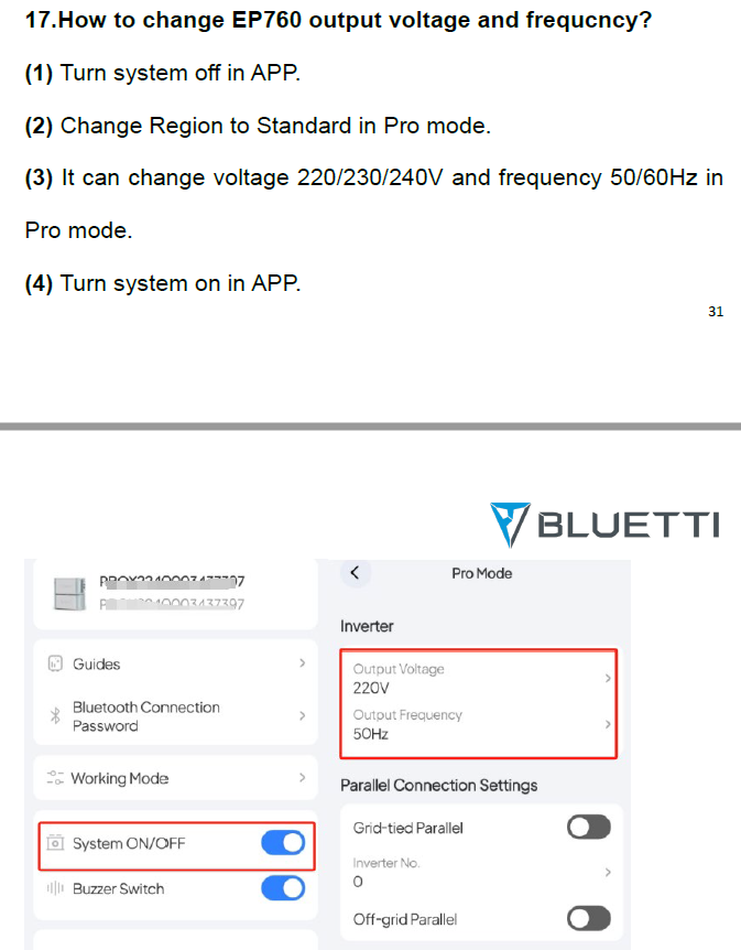

For how to adjust the frequency, please refer to the screenshot below.
Thank you very much @BLUETTI_CARE - That allowed me to fix the system, I am back on grid-connected operation!
Now that the issue is fixed and with the proper pro access, should we cancel the revert and move back to the latest FW ?
Thanks again for your prompt support.
