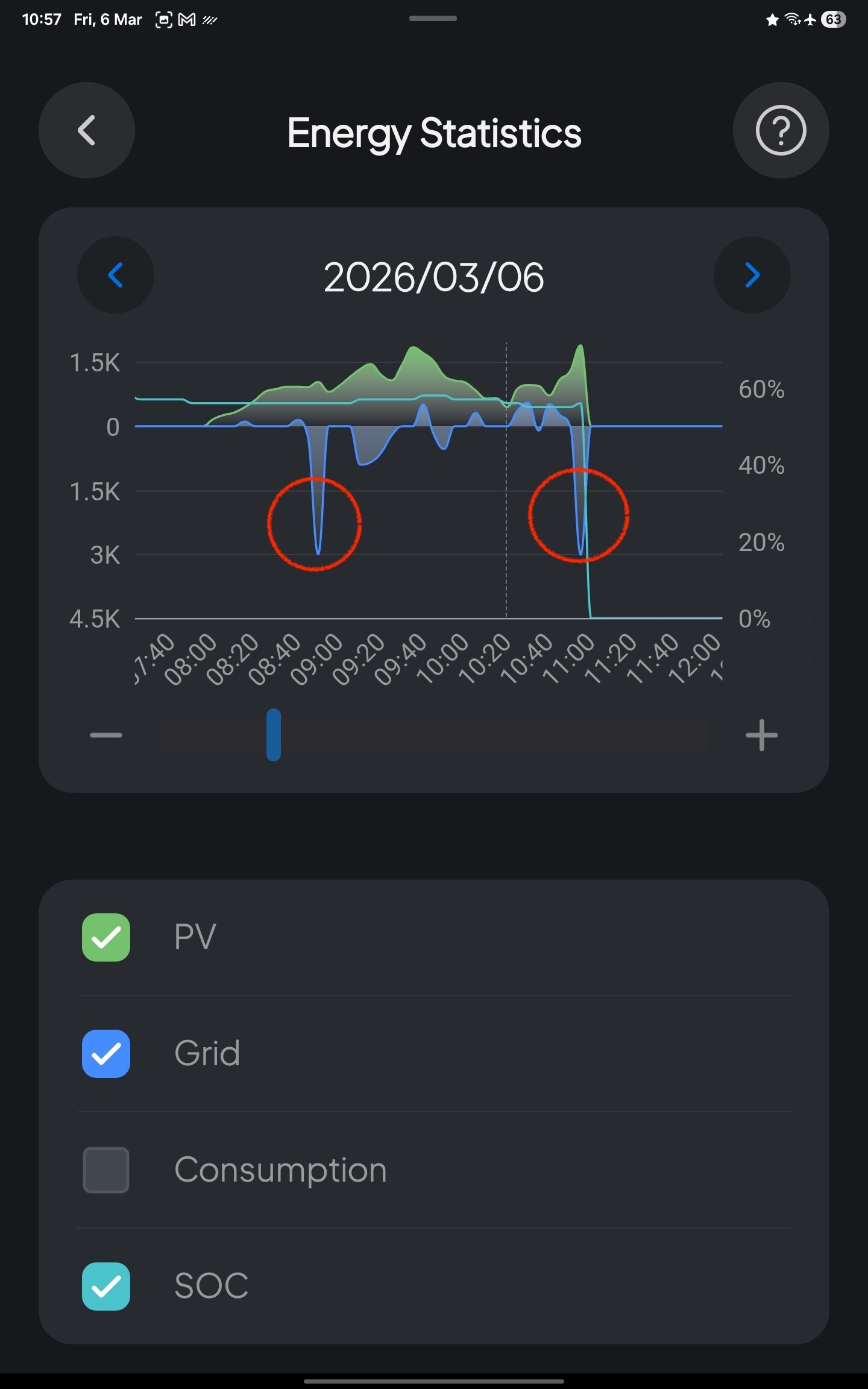

My Max Discharge Power is set to 3000W and 33A. When I enabled Feed Into Grid at 08:45 the current SOC was 56% and EP760 immediately output 3kw to grid. I then turned off Feed Into Grid and turned it back on at 10:53 when SOC was 55%. Again it immediately fed into grid 3kw. Both times 0845 and 1053 are inside the 0645-2359 Discharge (peak) period so EP760 is correct with obeying schedule.
But I expected feed into grid to only start after also reaching SOC High value 75%. The SOC High value is clearly ignored in the feed to grid decision making. Is this working as designed ? If yes, can Bluetti please improve EP760 to also obey SOC High value before feeding to grid in the peak period ?

If the EP760 works in the same way as the EP600, the SOC high value is only taken into account during ‘charge from grid’, whereas during discharge (feed into grid) the SOC low value is taken into account.
This means that discharge only continues until the SOC falls below the low value, i.e. during charging, as soon as the SOC high value is reached, charging from the grid stops.
Charging from PV, on the other hand, is always supported until the battery is completely full, SOC = 100%.
And since you asked, yes, it works as designed.
Thank you @SigiKa for your great advice! I tested and confirm feed to grid stops when SOC falls to SOC Low value.
