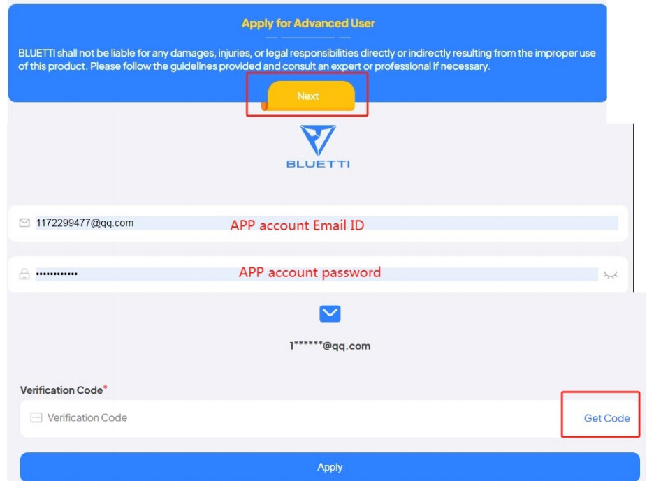

Nǐ hǎo, huòdé pro version kěyǐ xiūgǎiguò yā diǎn, qǐng gēnjù xiàmiàn de bùzhòu huòdé Pro version (1)Please get pro mode access as installer in link below https://H5.Bluettipower.Com/app/apply-vip/index.Html (2)We will approve your request after receiving it on our system, please wait patiently. Then you will see Pro mode after login APP.

Hello, you can modify the overvoltage point by obtaining the pro version. Please follow the steps below to obtain the pro version. (1) Please get pro mode access as an installer in the link below Apply for Advanced User
(2) We will approve your request after receiving it on our system. Please wait patiently. Then you will see the pro mode after logging into the app.
