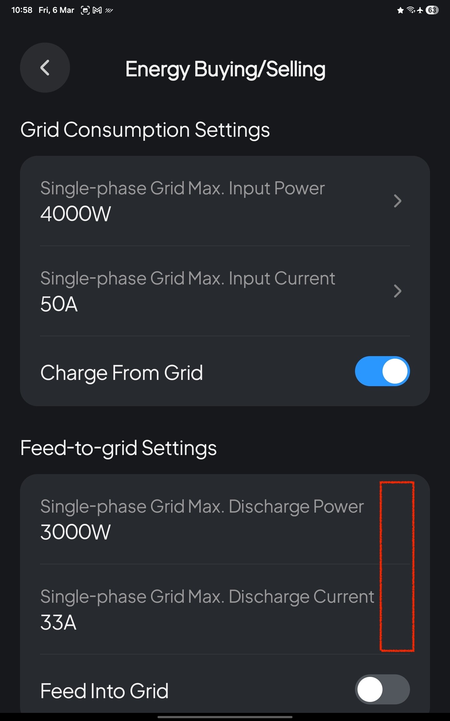

EP760: Can't edit Grid Discharge Power value
@BLUETTI_CARE Under Energy Buying/Selling settings I can enable or disable Feed Into Grid. However I do not see the > symbol to tap on edit the value. When system was installed couple of weeks ago I had to ask a Bluetti tech to change the value for me remotely. It would help if I can this myself. I was told it does not need Pro Mode and it should be editable. I have tried on another Android device and same issue.
Android on tablet: Version 16 Kernel 5.15.180 patch level 1 Dec 25.
Android on phone: Version 12, Kernel 4.14.113 patch level 1 Mar 23

Hi @dmc, regarding the issue you mentioned, please first disable the discharge time and then enable Pro mode to adjust the feed power. We believe this will help.
For instructions on how to enable Pro Mode, please click the link below for details.

@BLUETTI_CARE Thank you for approving Pro Mode. I can now edit the Feed to Grid power level.
