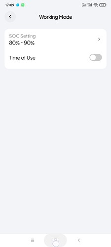

What does your ‘Working Mode’ look like? Do you use the ‘Schedule’ function? If so, what settings have you chosen? Please post a screenshot of the app here.
What settings have you chosen for ‘Energy Buying/Selling’? A screenshot would be helpful…

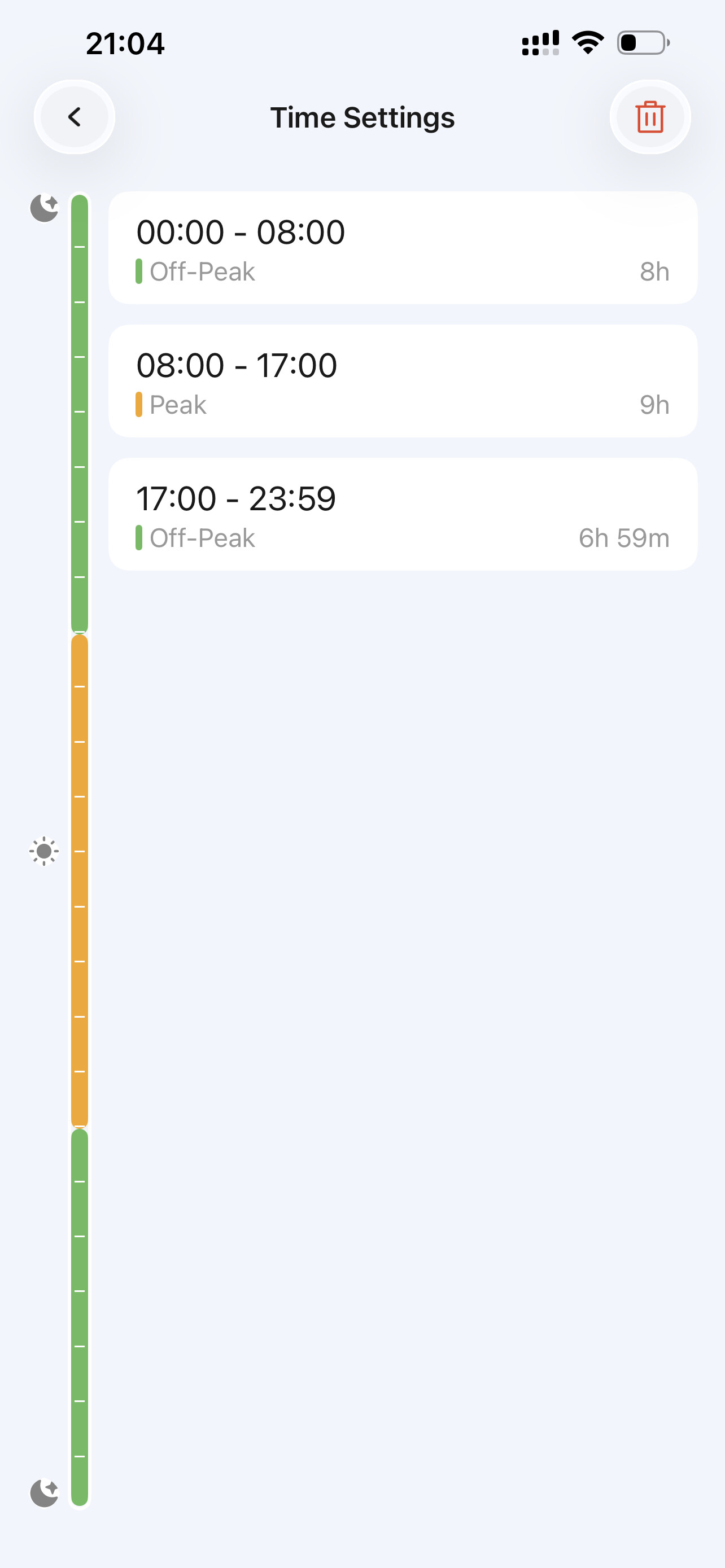

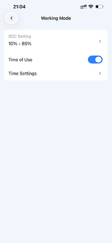

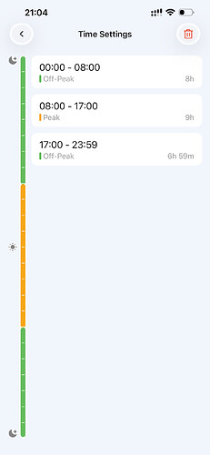

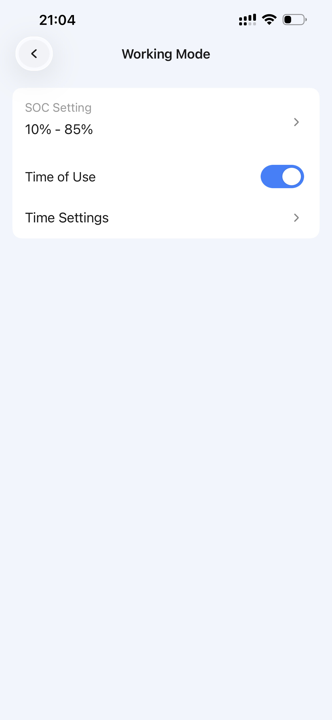

I have a Bluetti EP600 with 16 solar panels. I want to cover my consumption with solar power during the day, and when there’s no sun, I want to use energy from the grid. Can this setup be configured automatically? Is simultaneous usage of solar and grid power supported, or do I have to disconnect from the grid when there is sun? Foto with current settings attached.

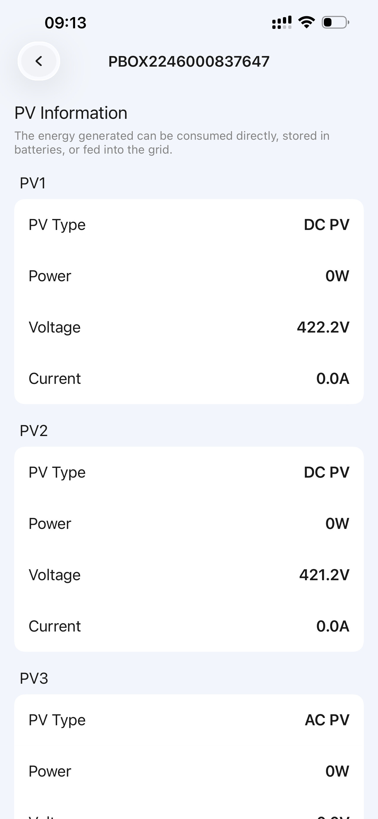

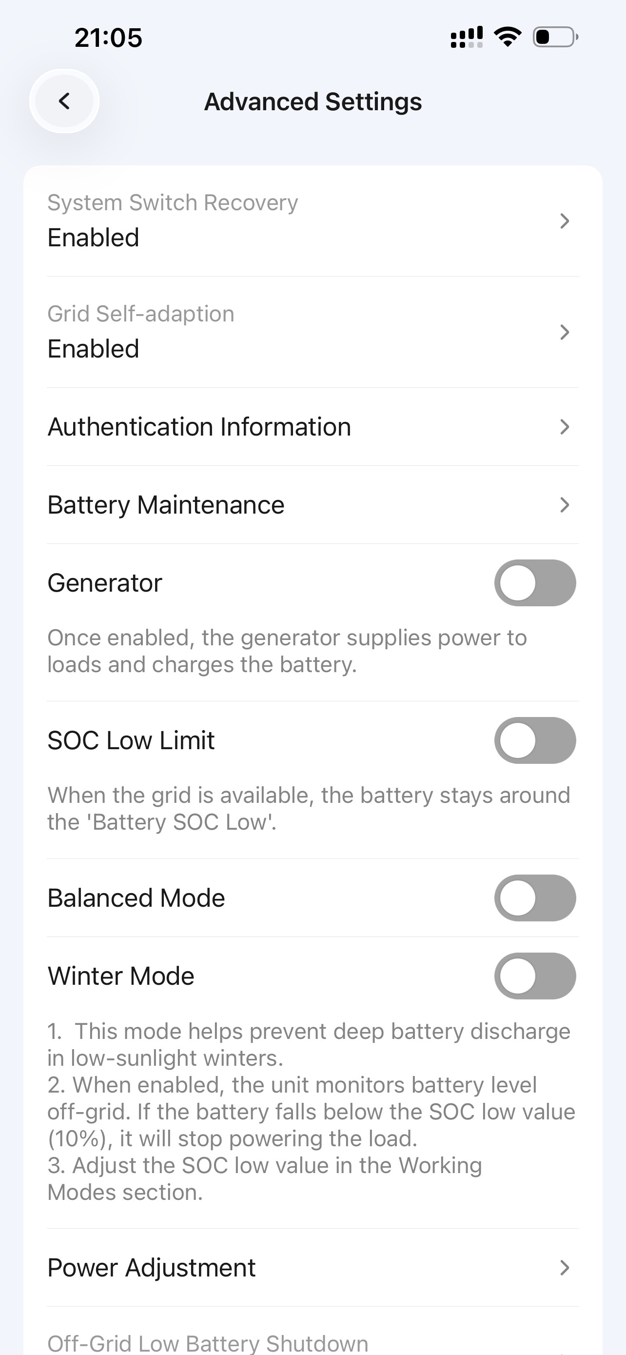

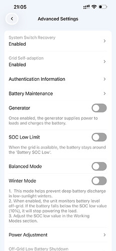

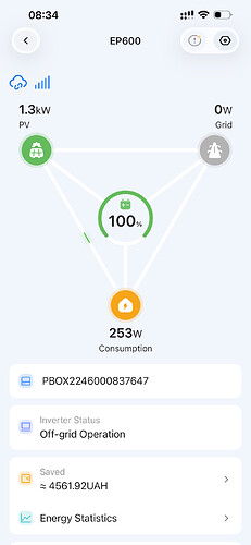

Yes, I have the latest version — 3.0.6. With the settings shown in my photo, the EP600 always takes power from the grid and does not prioritize solar energy for consumption.

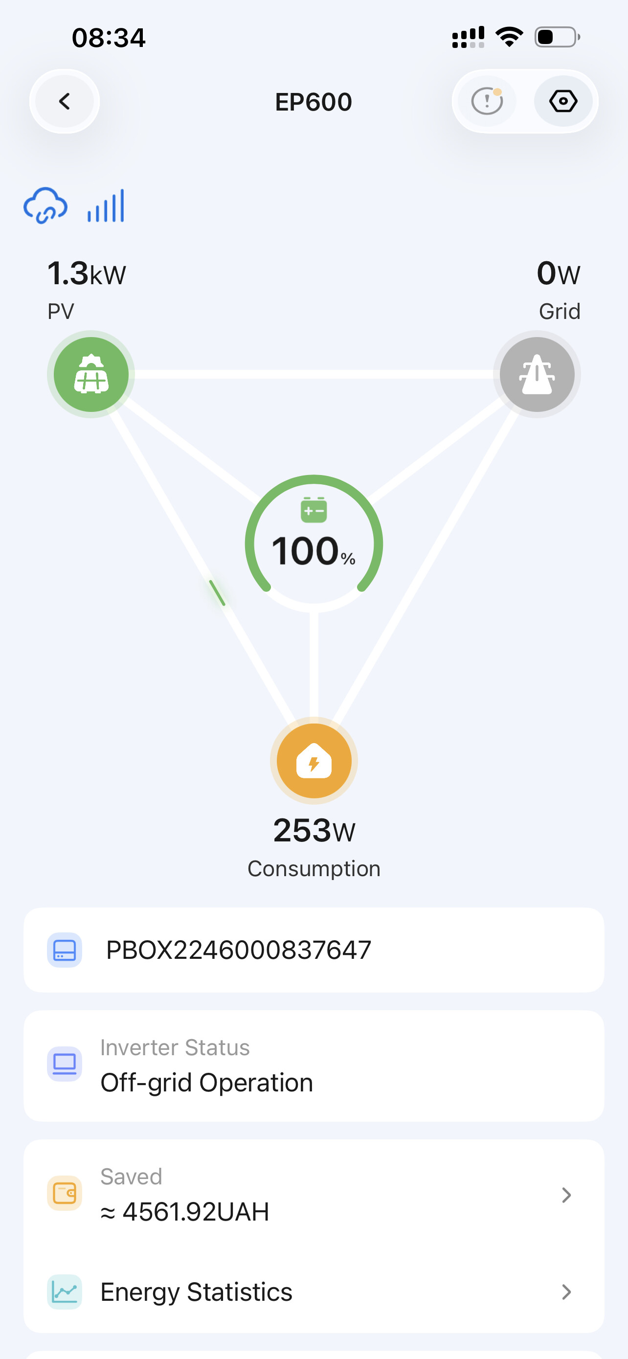

Here is how I test it: for example, if the consumption is 600 W and the solar panels generate 300 W, then 300 W should come from the grid and 300 W from solar.
But what actually happens is that the app shows that all 600 W are taken from the grid. As soon as I disconnect the grid, everything works as expected — 300 W from solar and 300 W from the battery.
Right now I have 10 kW of solar panels installed, and during the day the only way to prioritize solar energy is to disconnect the grid manually, otherwise the system keeps charging or supplying from the grid instead of using solar.
Could you please advise what I might be configuring incorrectly? I have already run out of ideas about what else I could try.

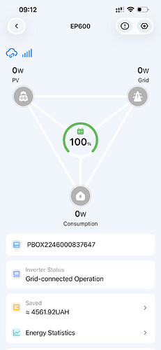

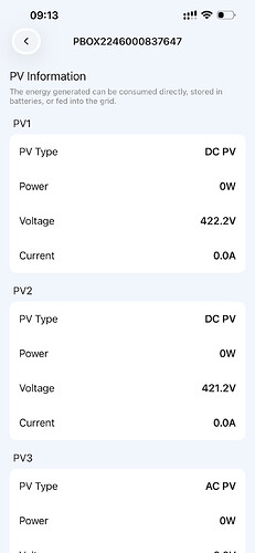

I’m attaching photos. In the first one the grid is disconnected and solar power is working. In the second photo the grid is connected, but everything shows 0, and as I understand the power is coming from the grid.

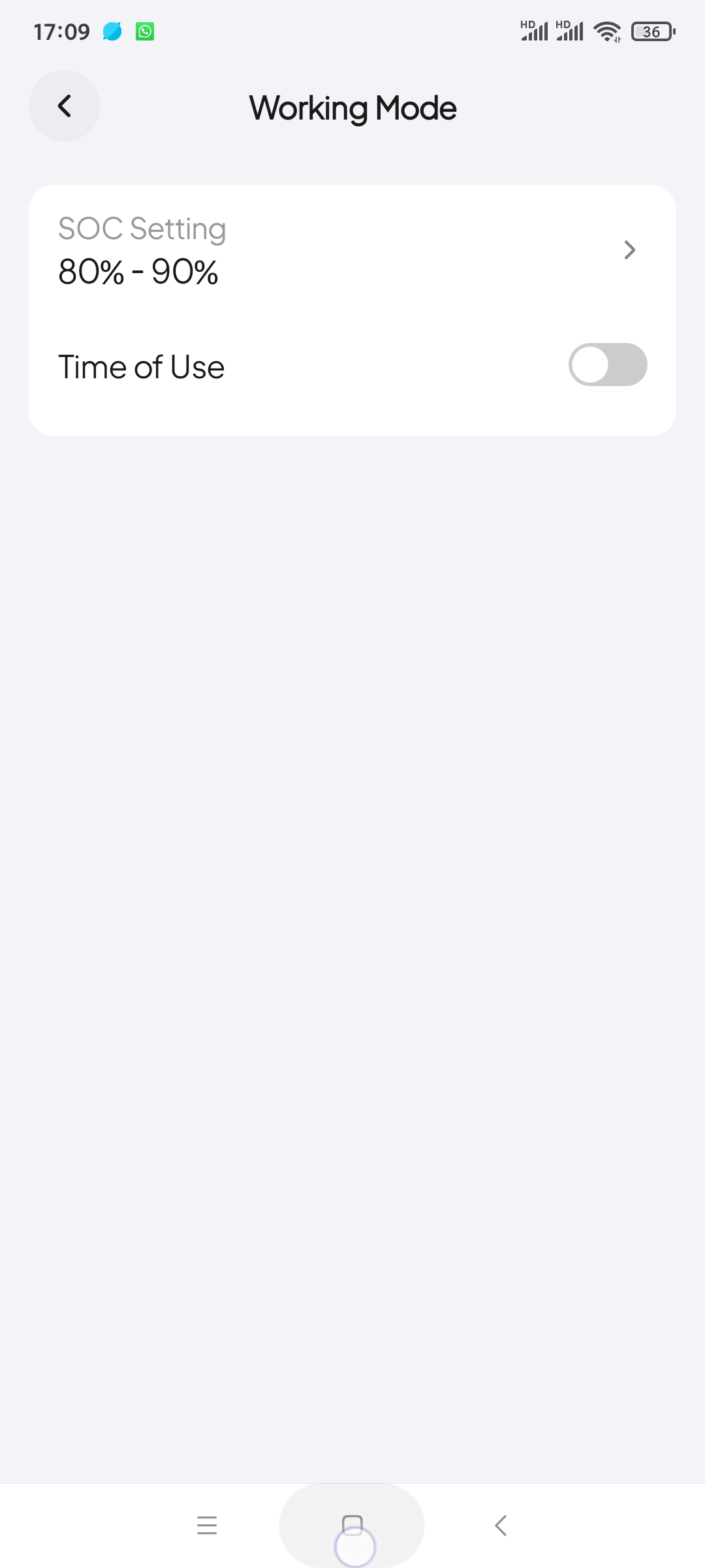

Hi @OleksiiS, regarding this issue, please configure the settings according to the screenshots below and test again. We believe this will help.
Thanks to @SigiKa for the kind explanation.
