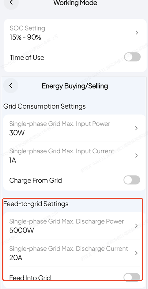

Hi @BLUETTI_CARE ,Today, for the first time, I tried letting the AC PV and DC PV charge without throttling and then feeding the entire surplus into the grid.
In doing so, I noticed the following behavior:
a) Up to 100% SOC, both the AC inverters and the EP600, as a DC-PV inverter, operated at full power.
b) However, upon reaching 100% SOC, the EP600 completely shut down its own DC string on PV1; the modules were only operating in idle mode.The remaining power is now only AC-PV.
What did I set incorrectly, or is this still a bug in the EP600? I have disabled the setting described above for throttling the feed-in power, yet the EP600 still exhibits this incorrect behavior. PV surplus should go into the grid, right?
PV1 is in idle mode, why?
The AC-PV Inverters are going on with full power
Time of use and feed-to-grid are turned off, so there shouldn’t be any further throttling, right?
P.S.: When I set Feed-to-grid to a higher value and activate it (10,000W), the battery begins discharging into the grid, but the DC string on the EP600 remains off until the SOC drops to 99% or below; only then does PV1 become active again, but only until the batteries are fully charged… (The second arrow in the first image above indicates the brief activation of the PV1 string on the EP600)

Hi @CurtisNolting76,
So far, I have observed the same behaviour with both of my EP600 units running in parallel. As soon as ‘Feed to Grid’ is switched on, but the power value is lower than the AC PV output, the EP600 reduces the feed-in from its own DC PV.
I have therefore tried various settings to get the EP600 to feed in the entire surplus (AC + DC). It cannot influence the AC-PV portion, as this is controlled by other inverters.
I am currently using the following Feed-to-grid setting, which finally feeds the entire surplus into the grid:
  • Single phase max. Current: 20A
  • Single phase max. Power: 4,500W (3 phases = 13.5kW)
The solution was that the max. power value must be greater than AC + DC PV; only then is the entire surplus recognised, as the EP600 also measures the feed-in from the AC PV inverters and adds it to its own DC string!
A nice side effect I also noticed is that as soon as I reduce the SOC max. value (e.g. 90%), the surplus starts earlier in the day and I can finally prevent my batteries from being charged to 100% every day. As soon as the SOC value is reached, charging stops and the surplus feeds into the grid.
