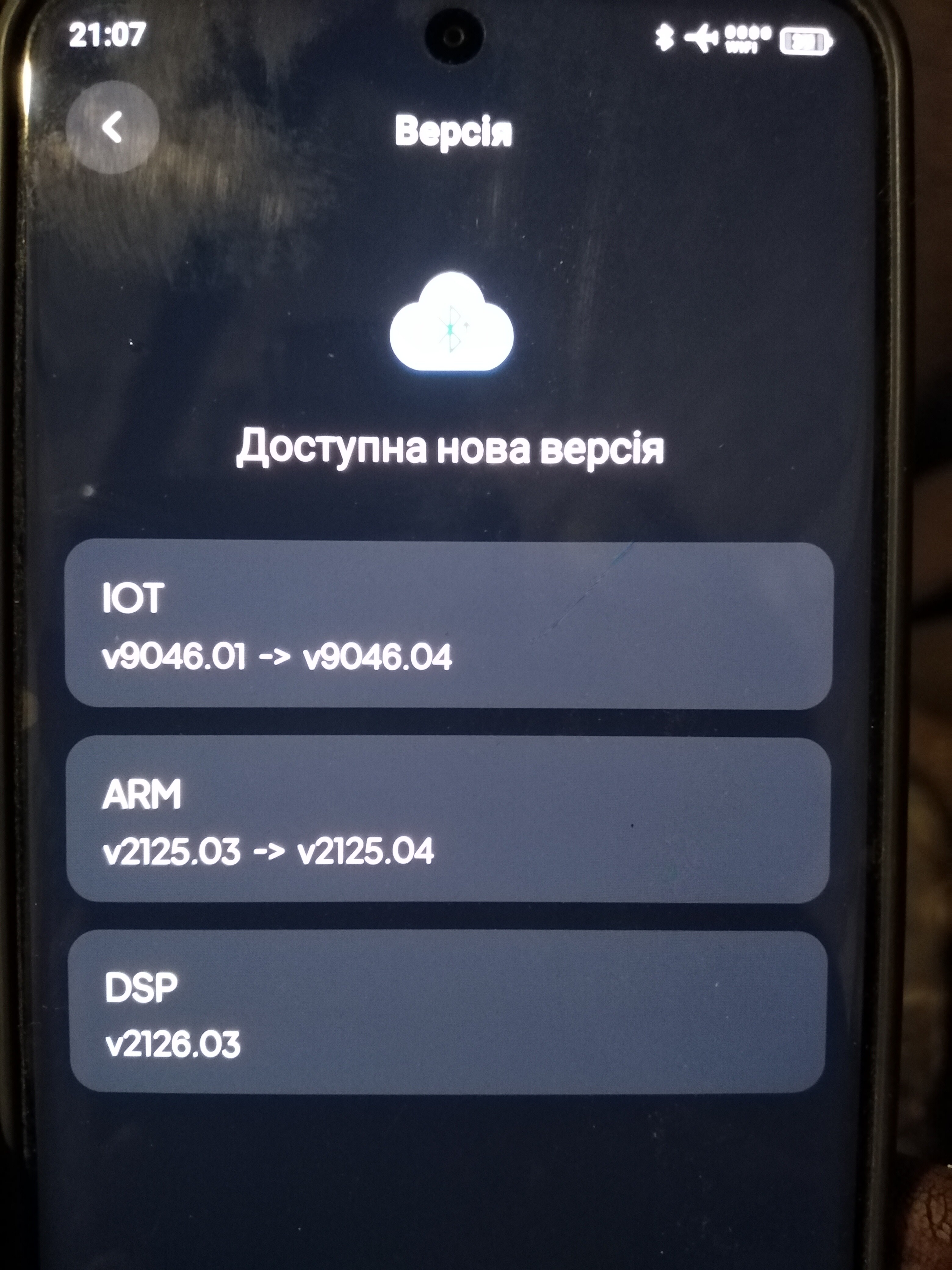

AC180P2445000176645
Please help me
update firmware on My AC180P
Hello, Thank you for your message. Could you please let us know if you are experiencing any issues with your AC180P? If there are no problems, you can click on the firmware update section in the app to update it yourself.
If you need any further assistance, please feel free to reach out!
