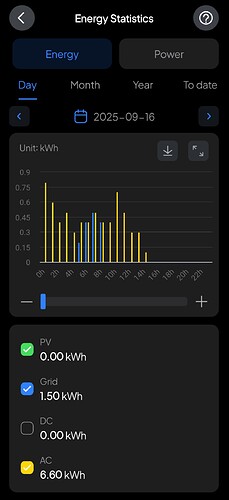

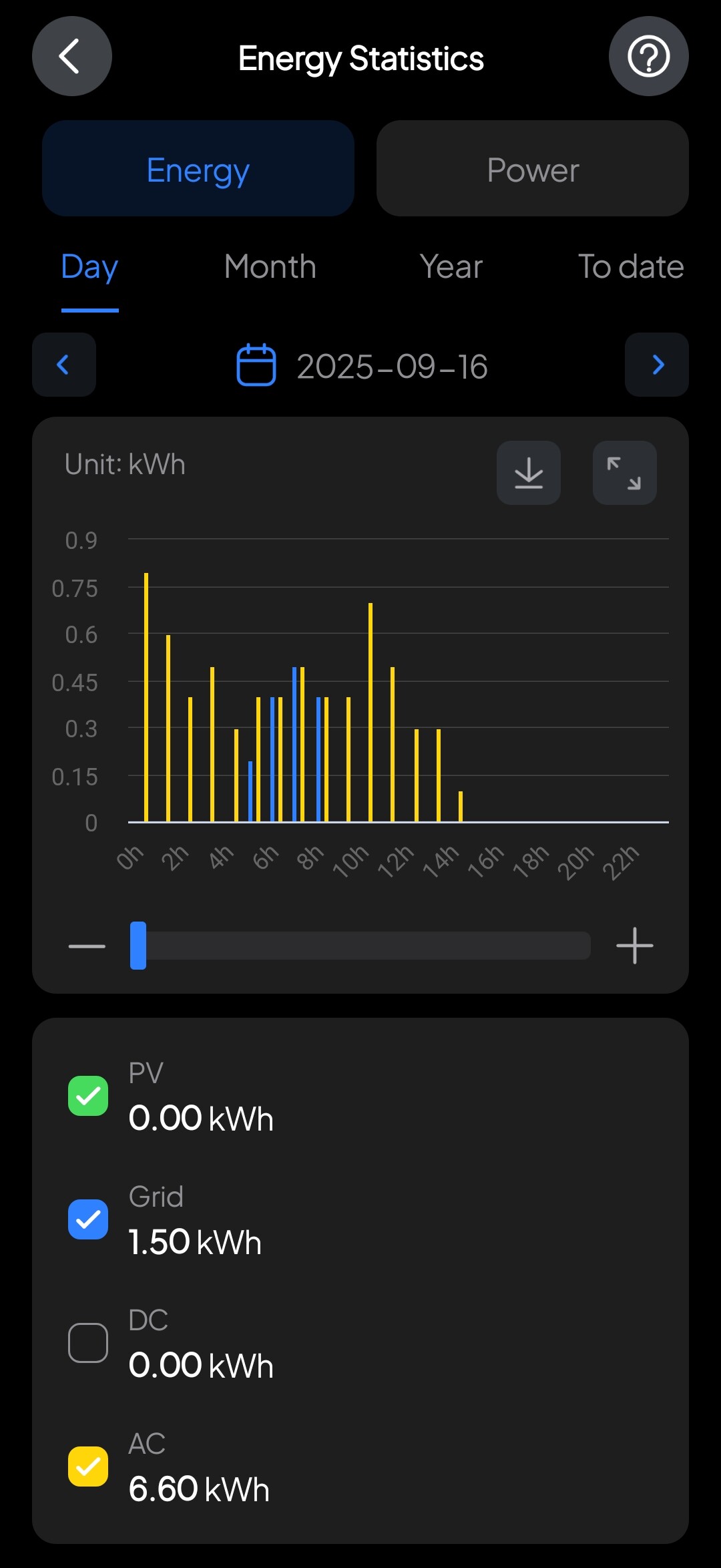

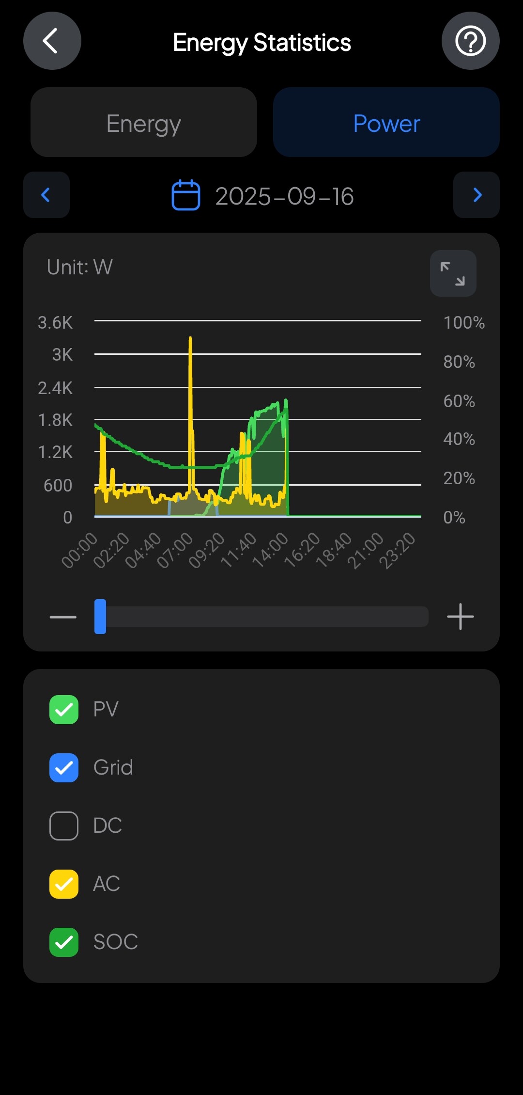

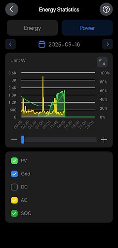

I have been using my Apex 300 along with my SolarX 4K since September 7th, but I have noticed that the Energy tab does not display how much solar energy was received from the SolarX 4K. Interestingly the Power tab does show it on the graphs. The pictures below show each tab’s display from today from about 2 PM (ET).
Can the app be updated to display that data on the Energy tab?

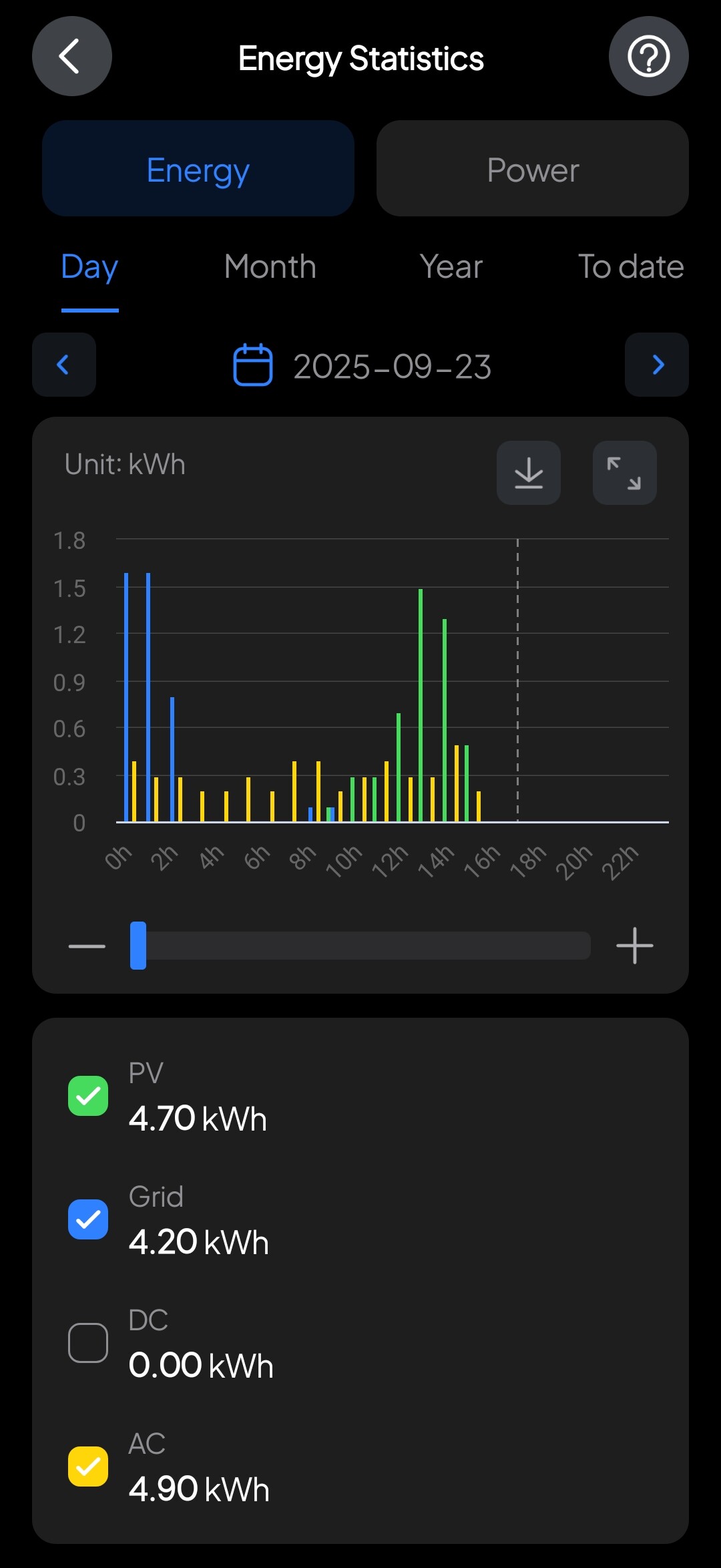

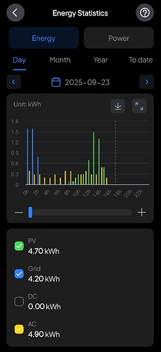

Hello!
I found that there was an update for each of the components of the Apex 300, so I installed all of them. My app was already at the latest version. And today I have PV data for the SolarX 4K!
As usual, excellent and fast support. Thank you all!
