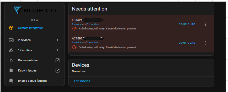

I have two Bluetti’s an EB3A and an AC180.
The AC180 is a replacment, to one that used to connect to HomeAssistant, with a variation of the “warhammerkid/bluetti_mqtt”.
But the replacement does not work with HomeAssistant any more, due to, “Bluetooth wireless messages are transmitted using ciphertext”

I have now installed/integrated “hassio-bluetti-bt” as the refered to example in the bluetti link.
