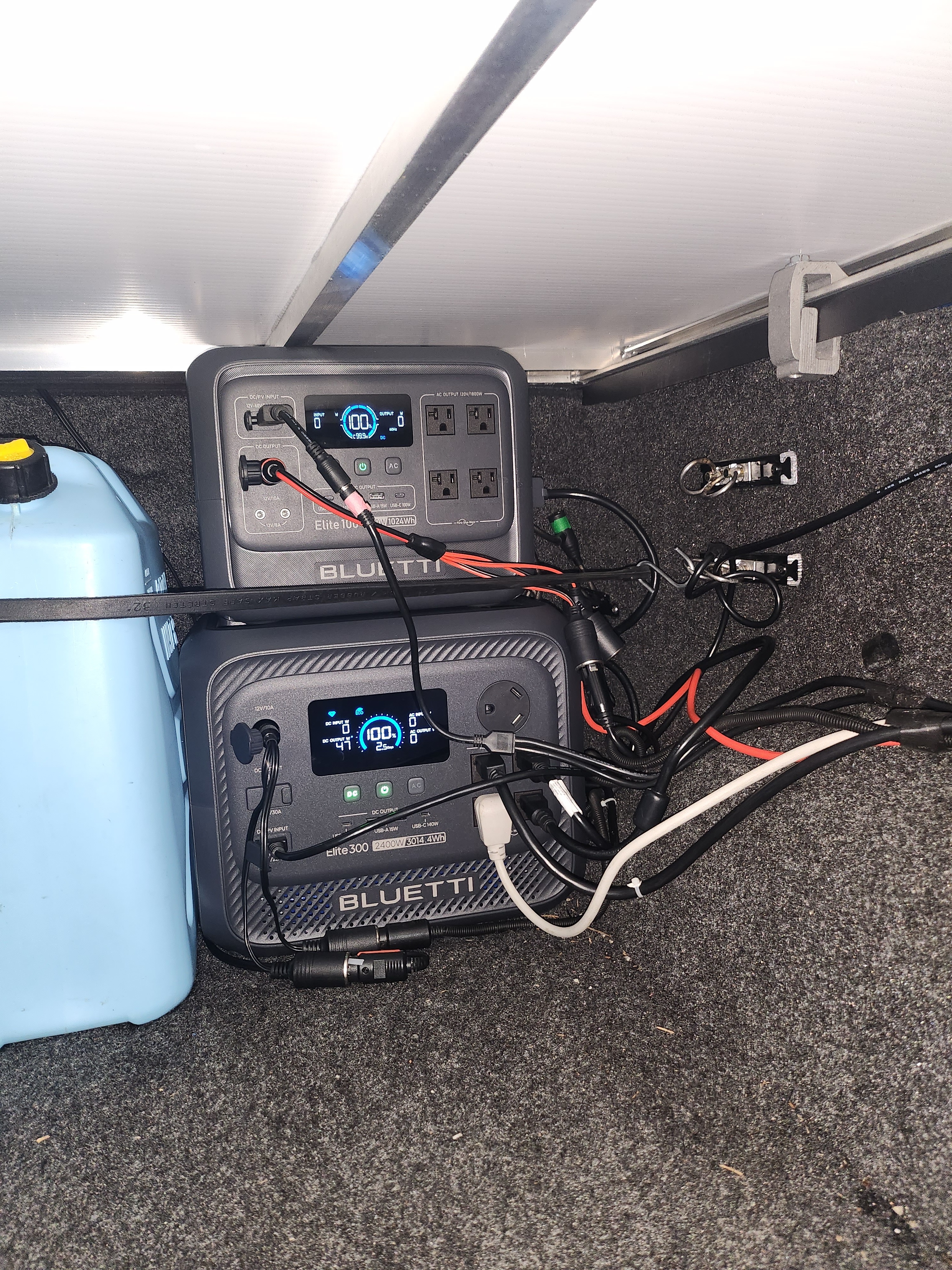

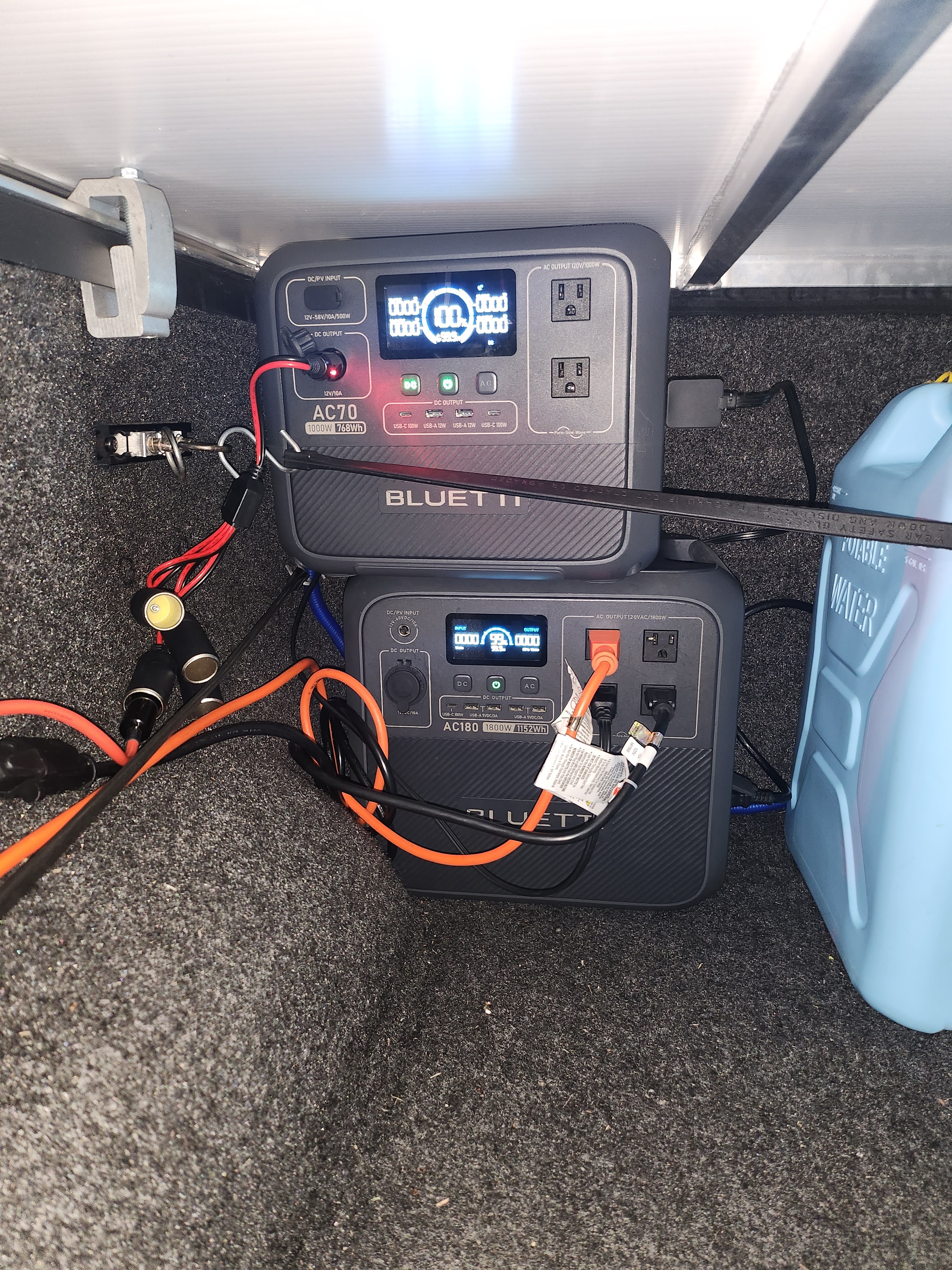

The Elite 300 does not feature a dedicated expansion port to directly interface with an expansion battery such as the B300. It was designed as a standalone unit with higher energy potential in a compact size. With that said I did purchase an Elite 300 myself and I use it in my truck camper to AC charge my Bluetti AC180, Elite 100 and AC70. I prefer AC for piggyback charging so I don’t have to stress the DC port constantly at 120W to heat warp/burn out the cigarette lighter port/wire. The stuff I have plugged into DC is fine since its occasional use or low power, but having to always recharge a power station at 120W DC not only takes forever, but is a slight fire risk. If I could get rid of the cigarette lighter port altogether and wire all my DC appliances to a fuse block which then connects to a secured XT60 or XT90 port on the unit I would. I’m aware the Elite 300 has a 12V/30A XT90 adapter which would accomplish part of that, however the problem is I have DC devices on both the passenger and driver side. For example I converted my EX4100 NAS, Asus MB249C 24" portable monitor, network switch and Dreo CF714S fan from AC to DC using a 12V to 19V step up adapter. Ignore the cable management mess, I’m working on a solution for that lol.
