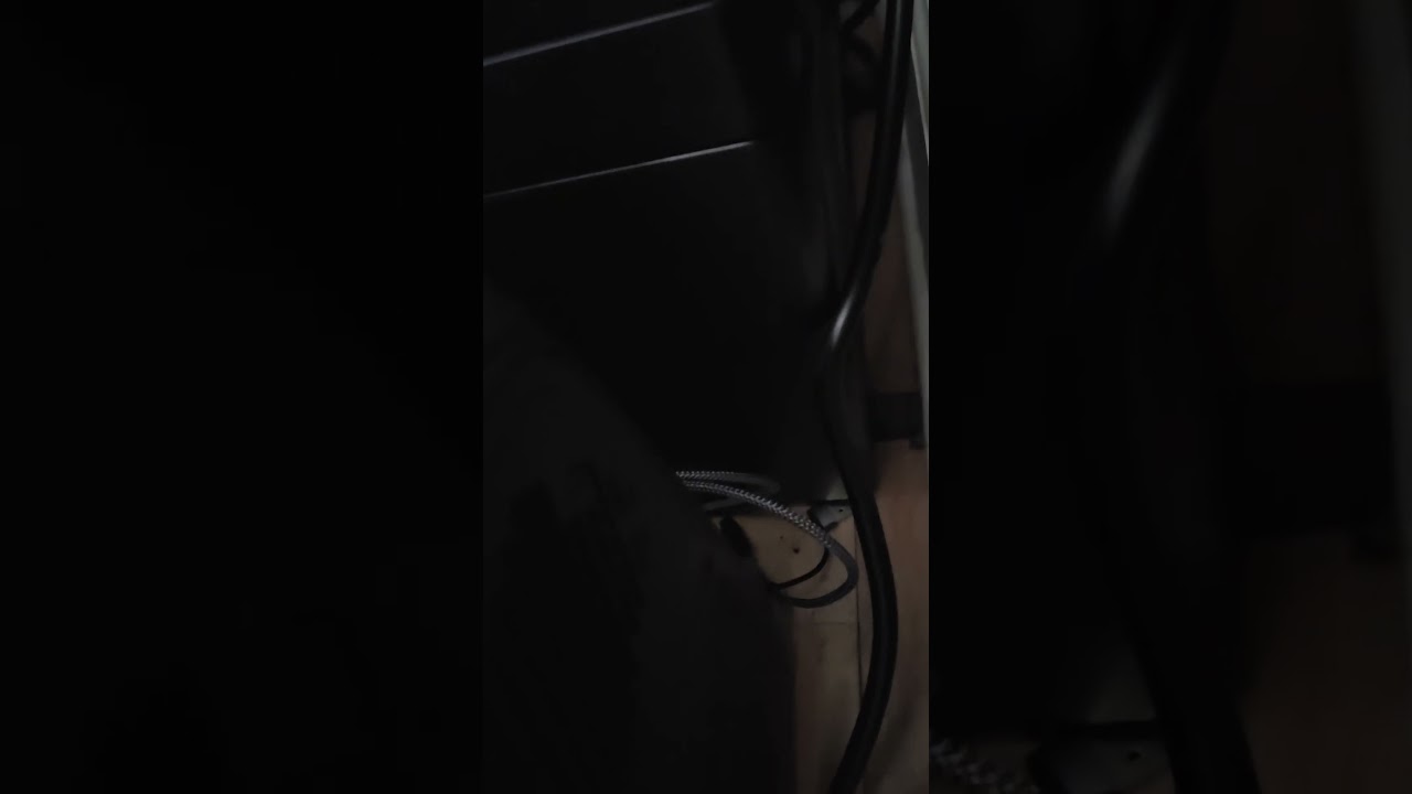

Hi @dredge999 it would be really helpful if you could post a video of the noise issue,Bluetti would want you to do this anyway when they are trouble shooting your problem. Also is all your firmware up to date? @BLUETTI_CARE could you help please.
Turn up your volume. However, sitting in my chair in my office - without my headset on, this is VERY annoying. It’s constant, with the draw that I described (PC draws 150-500 watts, depending and the fan noise is constant).
I don’t think a software update can fix this. This a sub standard fan. I just wish at some point Bluetti would use quality fans (Noctua or other). If this is a warranty issue I have the box. However, I suspect I will receive a unit back with the same problem and I do NOT want a refurb (someone else’s broken unit that has been repaired).
