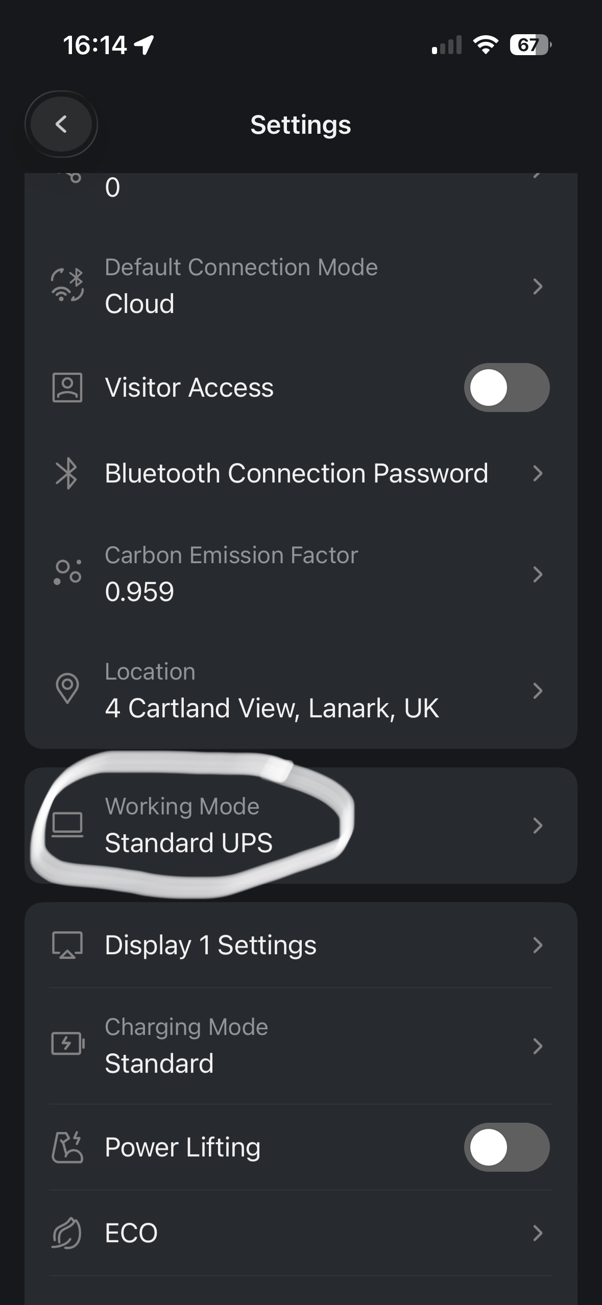

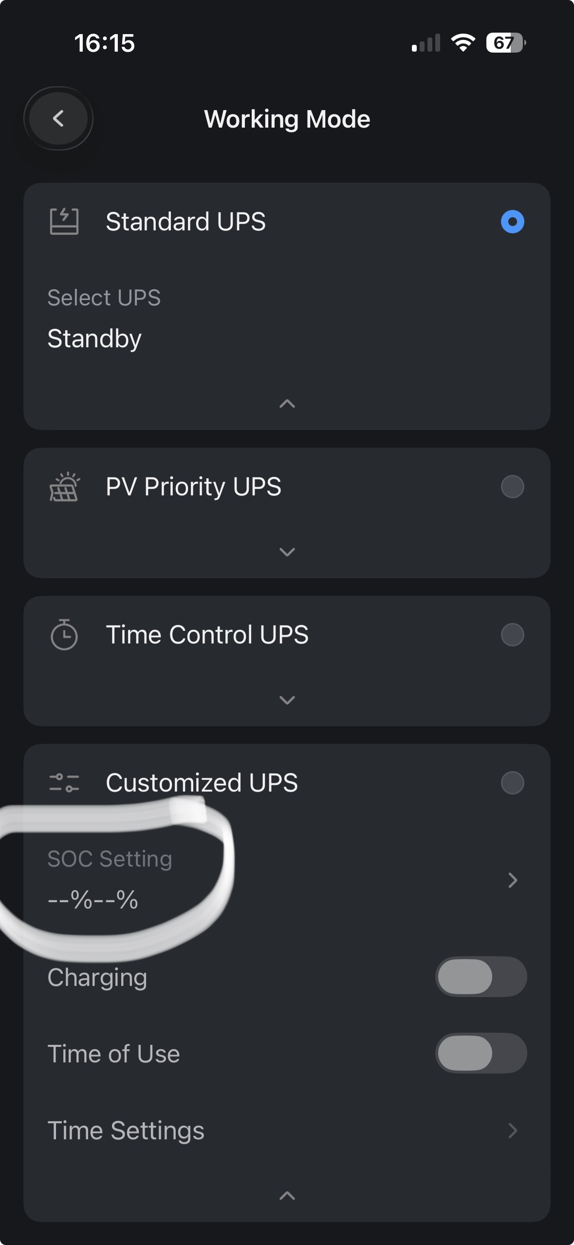

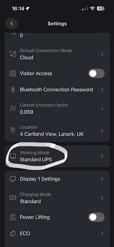

Sorry you can change the setting for that if you go to settings in the app and change the working mode there you can change the percent of charge.
Thanks again, that helps. I’ll do some experimenting with the custom UPS and compare that to the standard UPS to figure out what’ll work best for me.
