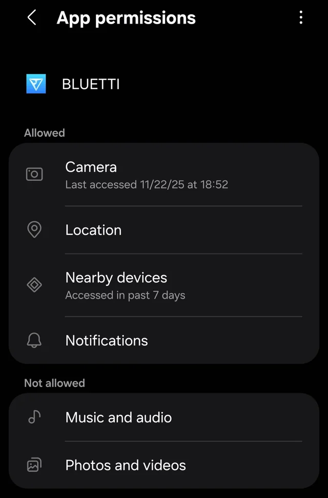

Hi, I recently bought a Bluetti elite 30 V2 (in EU) I can’t connect to he device over Bluetooth, I tried on a Samsung s25u, iphone 14 pro and a Redmi tablet. I gave every permission needed to the app and still I can’t connect.
I tried a BLE scanning app and. I don’t seem to see the device coming online. I ofc tried to turn off and on the device and the Bluetooth option. I tried both offline and online mode in the app and I scanned the QR code in the back.
