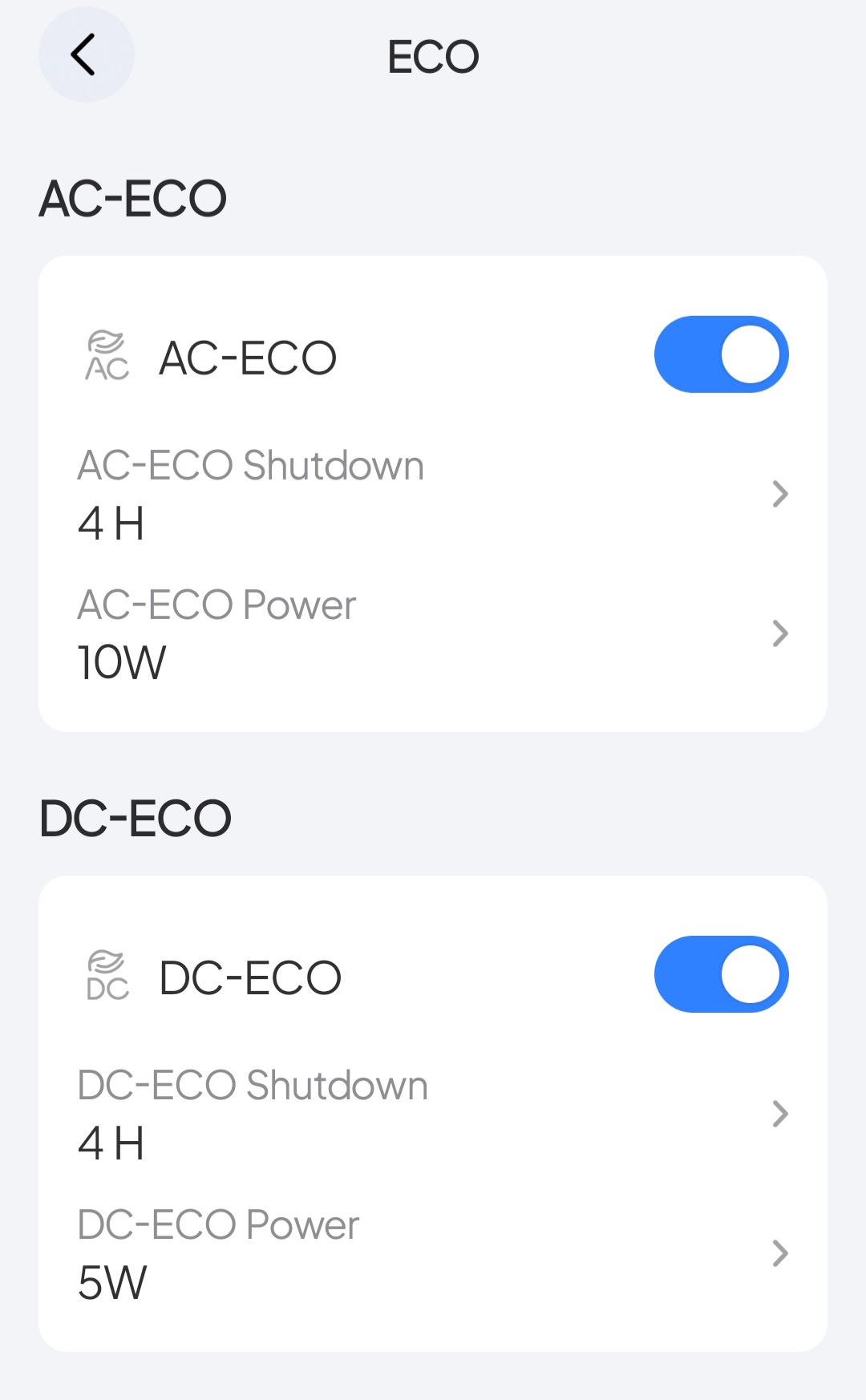

Recently after a software/firmware upgrade to my bluetti elite 200 v2, my dashcam which plugs into the cigarette lighter port, shuts down when after a while I turn off the dashcam’s display.
With the dashcam screen on, according to the power station, it draws between 6 and 7 watts. Yet, when I turn off the screen of the dashcam (to save power, it’s so minuscule though) according to the power station, it doesn’t even register 1 watt when the dashcam screen is turned off and now recently after the software upgrades through the bluetti mobile app, the power station itself shuts down!
So now I have to leave the dashcam screen on thereby drawing 6 or 7 watts. This did not happen before the software upgrade! Is there any way around this or does Bluetti need to develop an upgrade later on down the line?
@sacrilegious

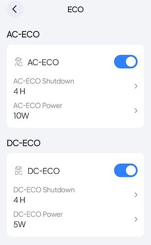

Did you turn on Eco mode, it will turns off the output.
I just found out what you meant. so I went into settings and there it was!
it must have automatically turned on after I updated the power station.
