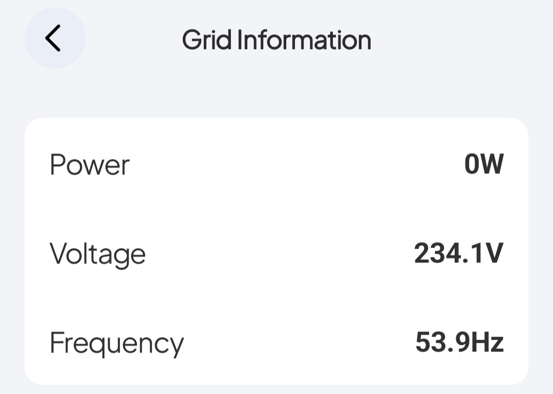

If I connect it then I get a warning that the frequency is out of range. The Elite is telling me it is supplying at 55 Hz and won’t take a charge. The advanced settings don’t seem to let me change the limit to above 53.5 Hz.

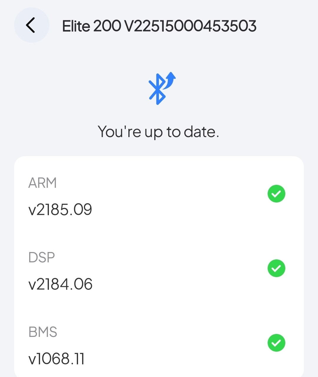

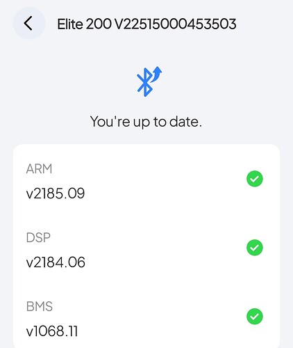

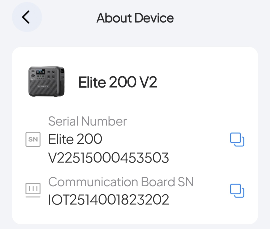

Additionally, could you provide the device’s serial number and firmware version? This information will assist us in troubleshooting further.

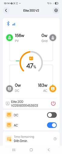

Today it seems to be working with the generator at 52.9 Hz. I had adaptive grid enabled and even throttled the maximum current draw.

Well, my optimism was short lived. After about 45 minutes it stopped charging. The generator output was at 54Hz and that proved to be too high for when I set the Elite output frequency to 50Hz but too low if I set the output to 60Hz.
Extending the over-frequency tolerance from 1 to 10 seconds got it working for a while but then it refused to take any charge at 55Hz. Seems a load on the generator tends to lower the frequency slightly but once it rises above the 53.5 maximum in the Elite settings it stops charging.

please tell me your sn code and firmware version.
I’ll have to drag the generator out and connect it up again to get that. I’ll reply soon with the code.
