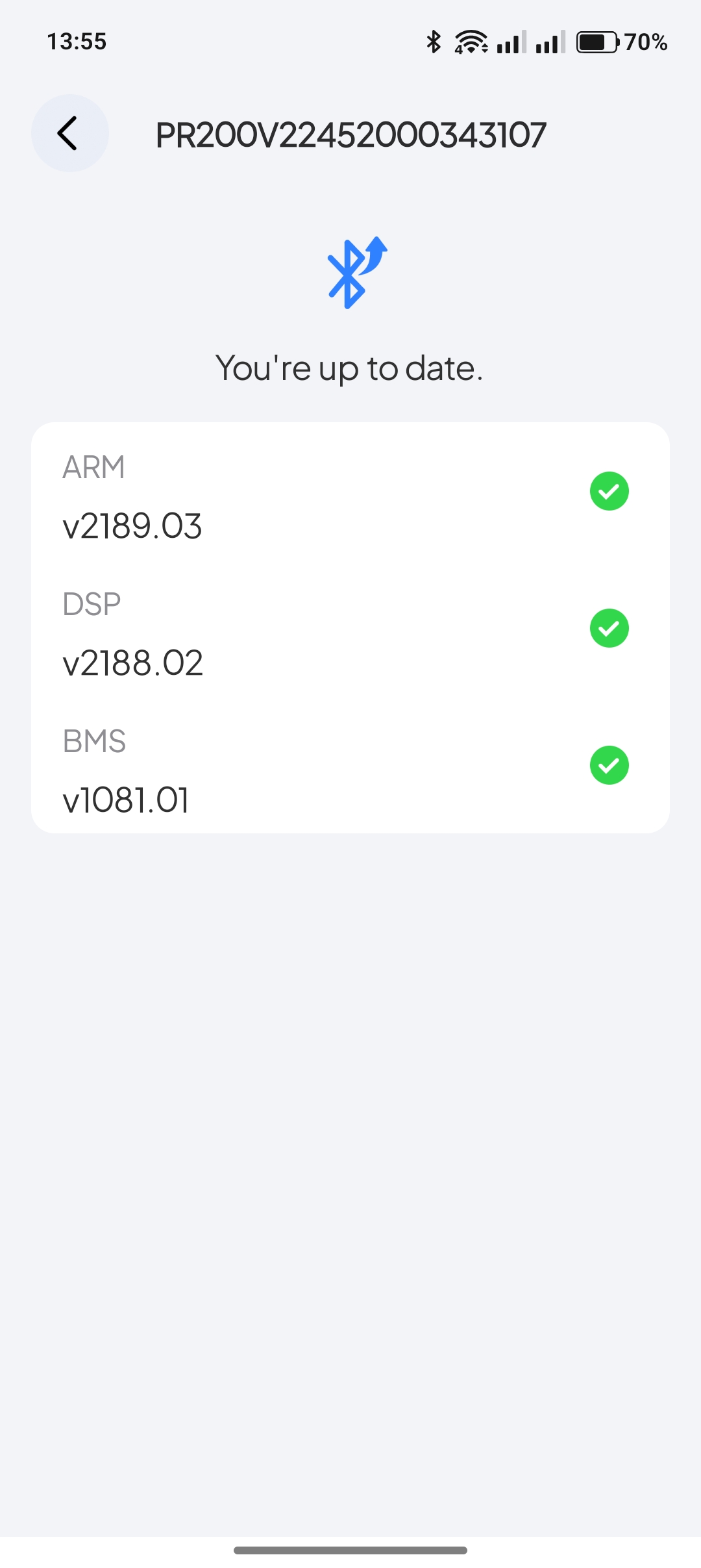

Hi my SN is PR200V22452000343107
I have not received the update as of today.
Still on IOT v8024.11
Regards jurgen

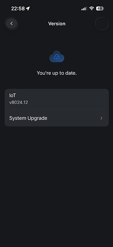

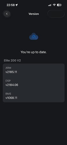

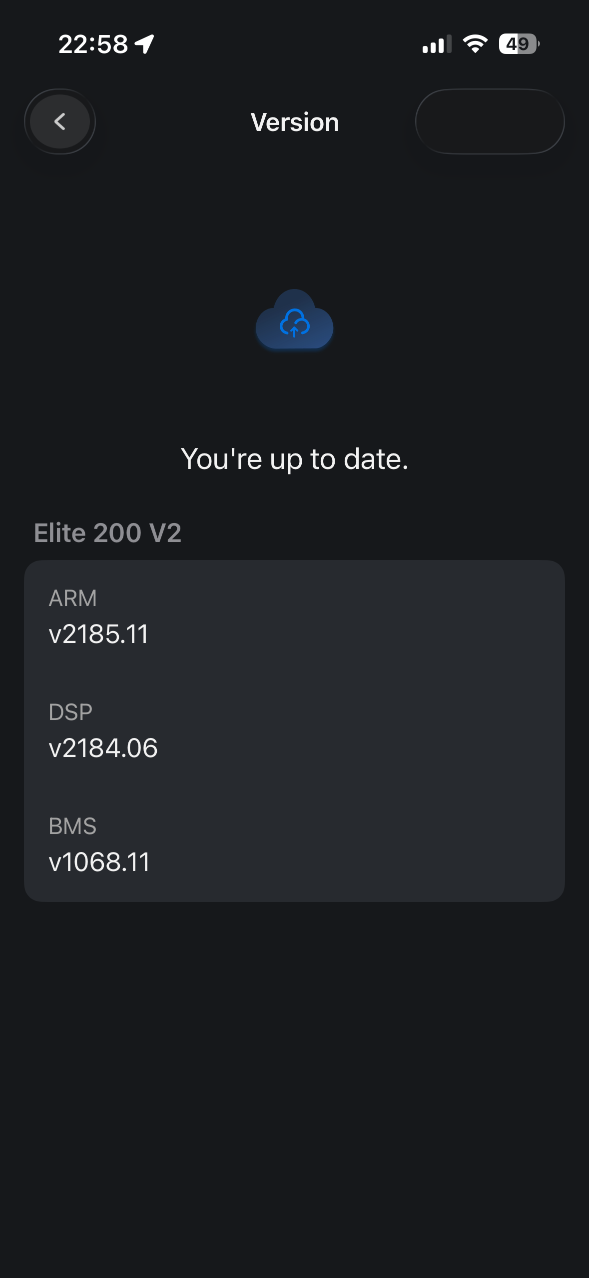

Dear @BLUETTI_CARE
Maybe You could push firmware update to my Elite 200 V2?
IOT v8024.12
ARM v2185.11
DSP v2184.06
BMS v1068.11
SN: Elite 200 V22548210712745
Communication board SN: IOT5000002256401
Hi @Boristheblade, regarding this matter, I have applied to upgrade your system to our IT department. If the new firmware is available, they will complete the push within 24 hours.
